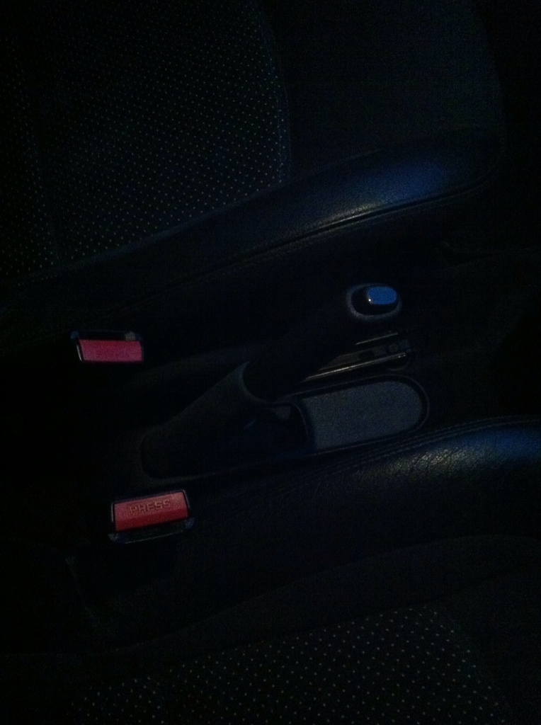

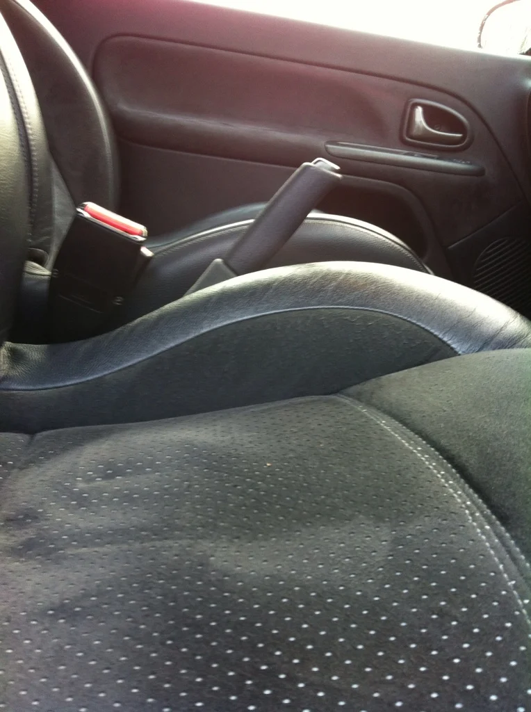

Evening all,
pulled the handbrake on and it feels loose and is pointing straight up towards the roof, the car also rolls haha. Ive left it in gear but not sure whats actually happened.
I think this is probably a snapped handbrake cable but really not sure.
Any help is greatly appreciated
many thanks,
Austin
  Clio Sport 172 Ph2
if the levers very loose with no resistance, & brakes not holding, then yes something has become disconnected between your lever & the calipers :) so yes cable.

UPDATE-----------------
Put the handbrake on today again and it is holding the car, although the handle is pullud up so much furter than it should and is loose, i can move it with my finger its that loose.
Could this possibly just be that the cable has came loose do you think? Or will it be holding because it may only be one of the cables that have snapped?
