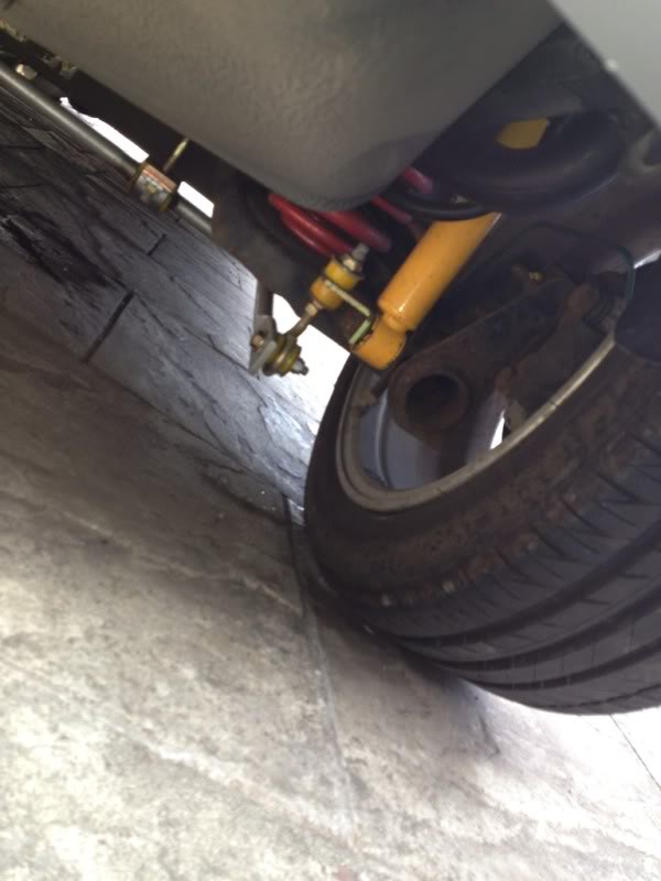

Parked at a friends last night on a steep drive and was pulling the handbrake and heard and felt a snap and now the handbrake pulls up much further and now I was out reversing and heard a noise from the rear drivers wheel. Got out to see what it was and a cable was hitting the inside of the wheel, so iv tucked the cable into the rear shock so it doesn't foul, u can just see it at the bottom of the shock. So I assume I need an offside handbrake cable?

Funny my passenger side cable snapped clean off yesterday while doing a hill start as well, have read that its best to replace both cables when replacing them with genuine Renault parts.

Good luck with that ! Arse of a routing to the lever over the exhaust ! :(
