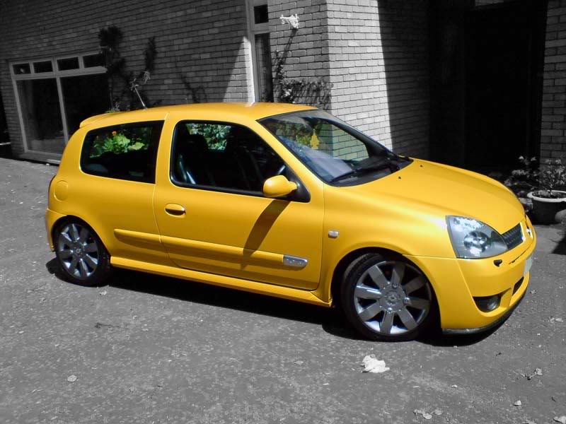

My clio has Gaz coilovers fitted (now before you start flaming gaz hang on), I find im not able to push it as hard on a b road or even at roundabouts at the moment, seems to be understeering quite badly and not getting any grip. The car is stripped out also.
On B roads it feels crashy and rough whereas on the standard setup it could take more punishment if you know what I mean.
The car had a brand new set of Eagle f1's fitted all round last week so im thinking maybe I should give them another 200 miles or so to bed in?
Ive toyed with ride height and damping adjustment but im thinking of raising them back up to a maybe 20mm drop to see if this cures it.
Anyone had similar problems? It just not the car it should be! :dapprove:

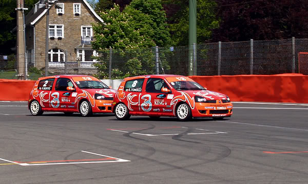

However clio cup racers etc all seem to be right and low so surely that isnt the problem?

Renault cars are low but also have full cages and a completly different suspension and driving requirments plus GAz dampaers well they don't damper there springs are way to hard and there design is IMO very poor.

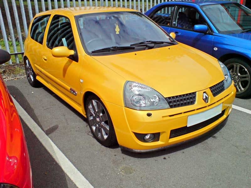

I have the car with the front sitting lower to try and help get rid of the understeer. Maybe its just too low full stop.
You cant really tell from the pics, though the rear has been raised another 10mm or so since these.

I always reckoned this didnt necessarily mean a bad thing after seeing cup racers in action. Though yes they have some very trick setups im sure.
They run a complety different setup than you are they have a forutune spent on them.
Running low not nesessarily bad but look at the ride height of the car on this forum that Mark fish just setup as a guid as to a good ride height.
  VaVa
Nick Hill only lowered about 35mm at he front and 15-20mm at the rear iirc. Certainly nowhere near as much as the majority of cars on here.

thing about the clio cup cars s tho they are built to run only on a flat racing track,not bumpy b and a roads,hence why they handle so well,but any bumps on uneaveness would have it skipping all over the shop,put in on a normal 'back' road with a normal 172/182 and i know who my moneys on winning.....

by the look of your car you have the same problem that made me get my money back from gaz. ie. collapsed rear springs. have a look through your wheel and see if the rear springs are coilbound? if so either order some new springs (from somewhere else!) or look for a better setup.

I do really hate it when people use the clio cup race cars as a comparison and say things like ' but thats what the clio cup cars are like or thats what they use on them'!!!!! Its not a clio cup race car. Its a road car!!!! Please dont try to copy them or. The road and the track are 2 completely different places!!! They dont do driving down a pot holed B road! Thankyou
