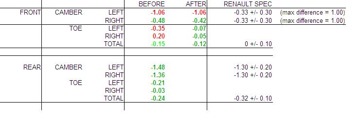

breakthrough. i think...
just got back from having the wheels balanced and car tracked on a hunter system. details:
ignoring the fact the toe is still out by two minutes, it's obvious what sticks out like a sore thumb! the tracking place told me it shouldn't make much difference but i'd like others opinions.
anyway, the breakthrough is that since the tracking i've noticed that when i break from a relatively slow speed there's a knock coming from the left and the car pulls to the left, and knocks again if i come off the brakes before i stop. i'll be outside this afternoon having a wiggle but please suggest anything i should look for apart from the obvious loose bolts.
edit: and it's still harder to steer left (sometimes) and it still pulls to the right.
