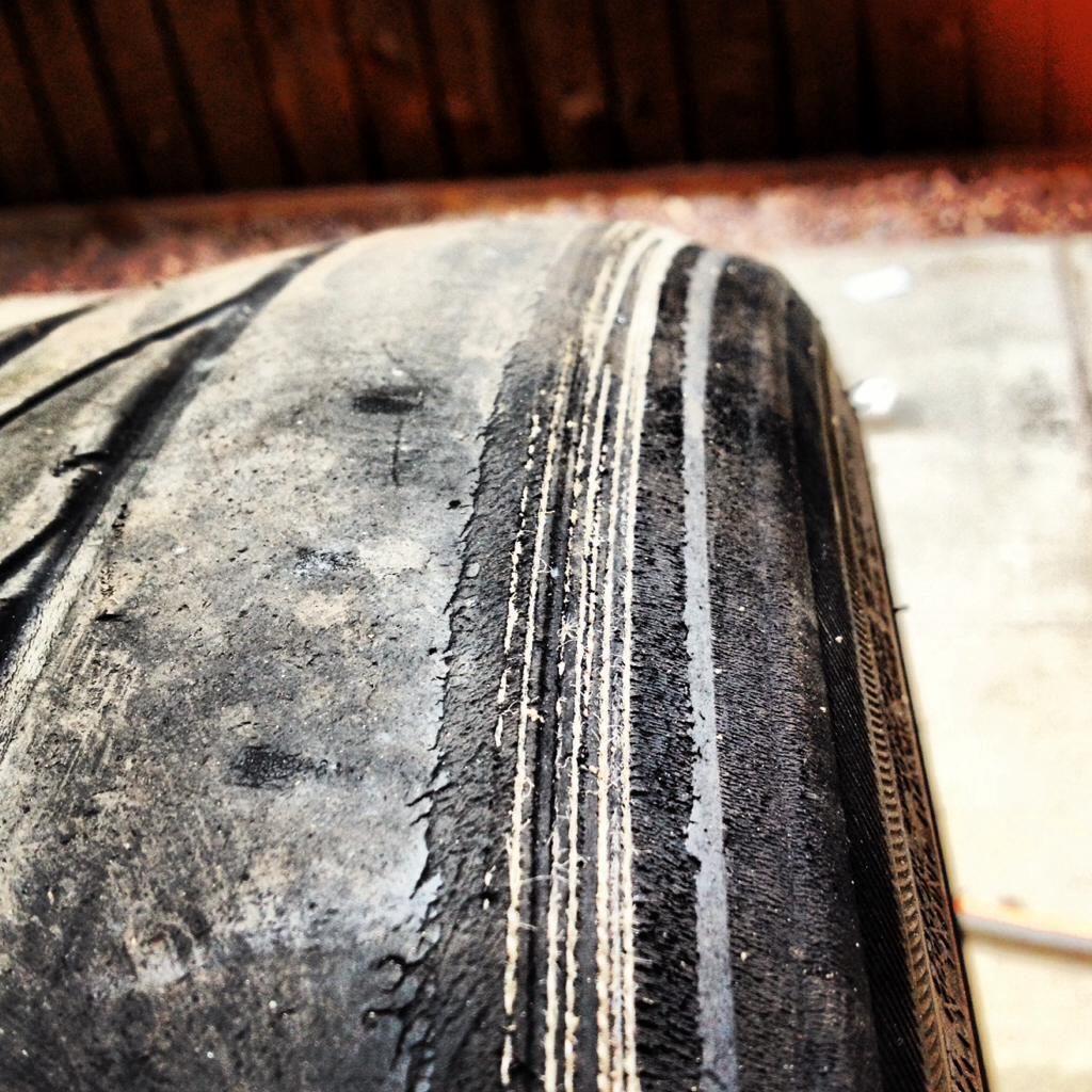

Do I have excessive camber on my 200 or is this the norm and what I should expect? Even wear both fronts.
Pics to follow
  LYV6, 182, R5GTT
Really annoying. iPhone isn't allowing me to upload pics.
Basically, the inner edge on both fronts are down to the canvas, but the out side of the tyre has about 2mm tread?
Both fronts are the same.
Is this the norm?
  LYV6, 182, R5GTT
When I had the 200 I had even tire wear. Was on standard cup suspension. Are you on aftermarket?
Hmmmm... No I'm on standard cup suspension. I've had it from new and I've had no knocks to the wheels etc.
I think I'm going to take it to Mark Fish in Harlow to do the geometry
  Audi A5
Has it had any suspension parts replaced in it lifetime, like a track rod end for example?
They usually have quite even tyre wear on the 197/200's.
  Turbo 182 Alfa 159
Have the tracking checked on a decent laser system like hunter. Check the camber and toe.
Carbonraider
  Raider, 172, the van
After doing this to a set of tyres I check my ego and it was found to be 18min toe out.. :/
