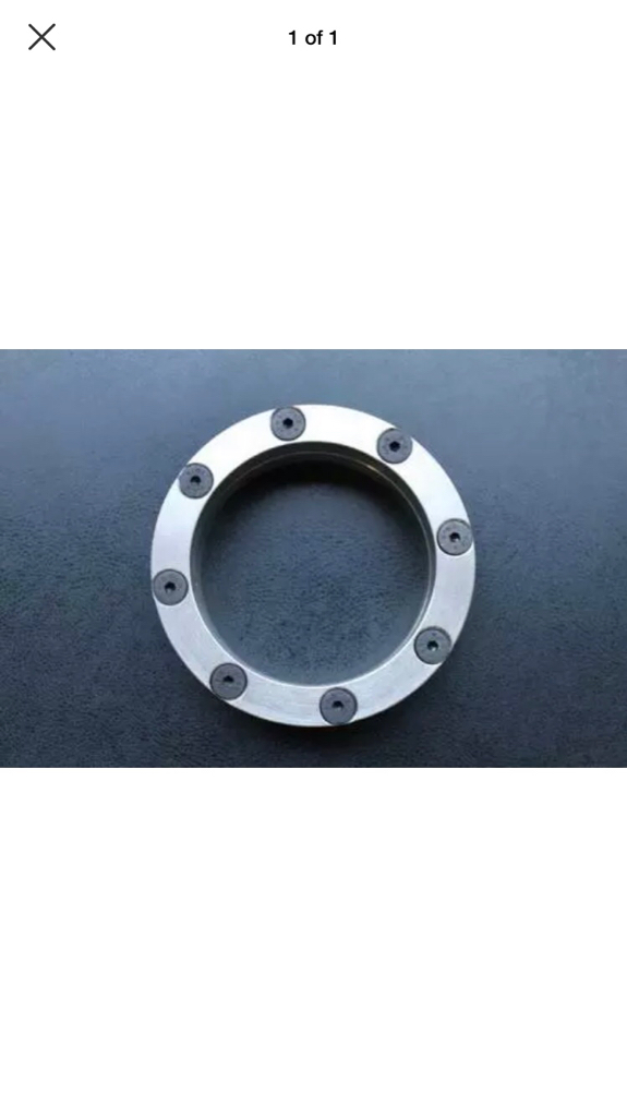

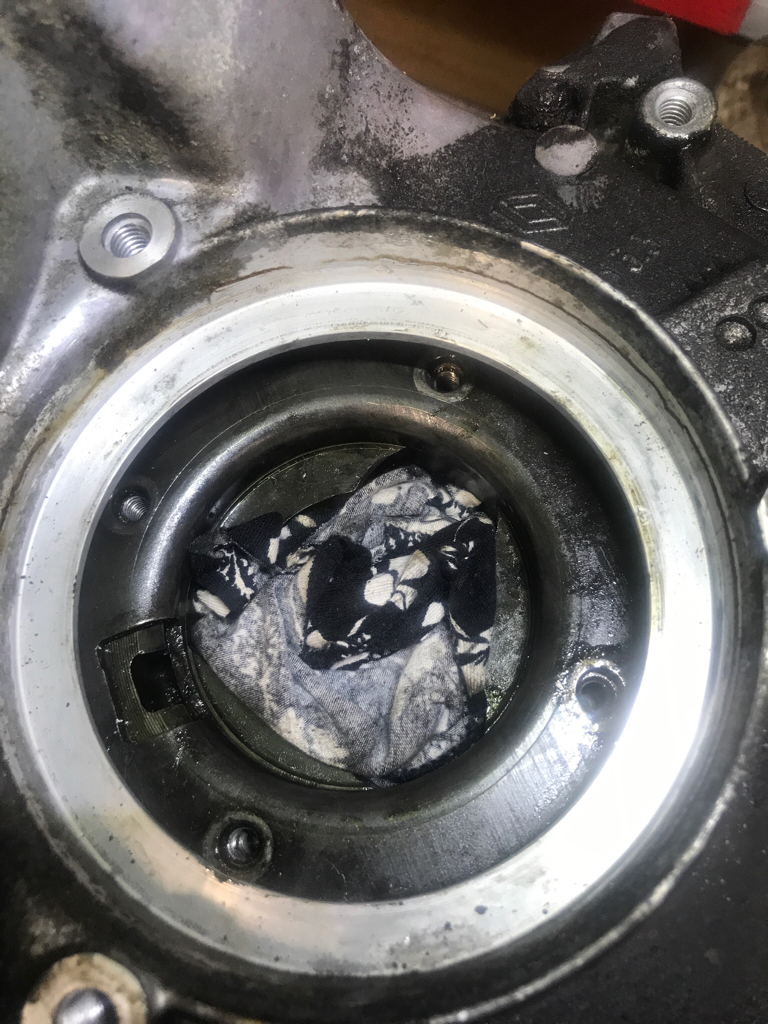

Hi. This might sound daft, I’ve loosened the original round circlip and I can’t get it out the hole but I’ve seen that you can do
It without stripping the box ?
Am I Missing something [emoji23]
Thanks in advance.

I thought it had to removed to fit the renfort. Bit as I said maybe I’ve lost the plot [emoji23] trying to sit the new plate on top of that plate it won’t sit right hence why I thought that needed removed and replaced.

I could be completely wrong here, but isn't the thing you're trying to remove a form of renfort plate? Just a different style (4 bolt rather than 8?).
A 182 box?
  Clio 172 Track Car

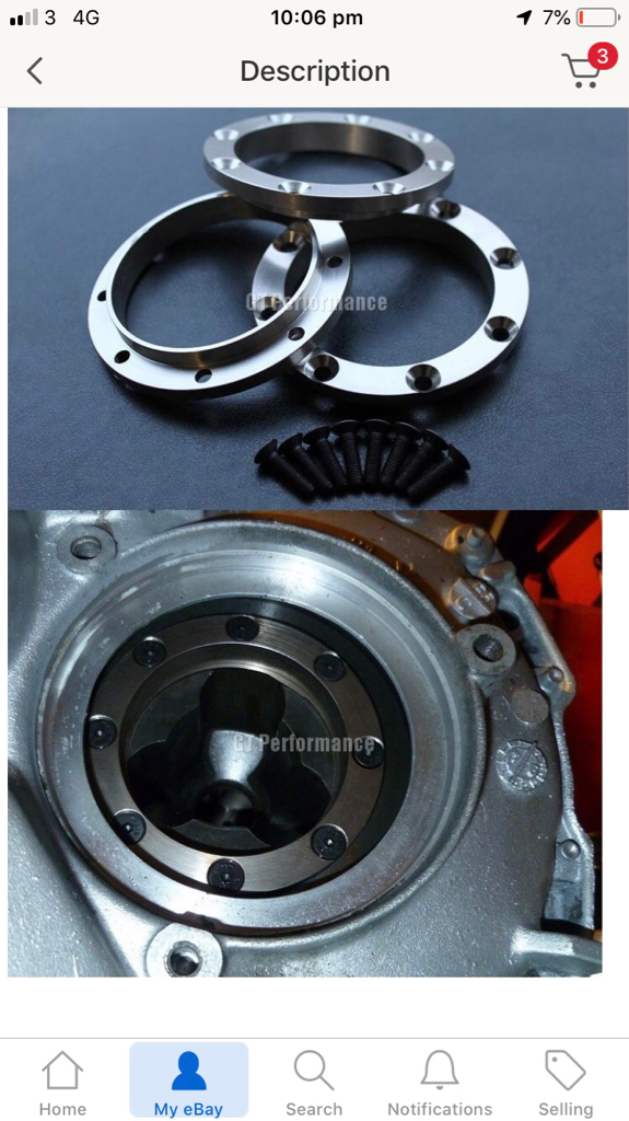

Not sure. Mines is a 172 jc5 box. I’ve been recommended to fit the renfort at its a track car I’m building and it’s coming for the cv joint to pop out.
  dan's cast offs.
later box, the renfort plate is for the earlier box that doesn't have the diff that you've got. 182 box but some very late 172s had it fitted as well.
  Clio 172 Track Car
Ahhhhhh ok. So this is the same thing I’m trying to fit ??[emoji23][emoji2357][emoji2357][emoji2369]
