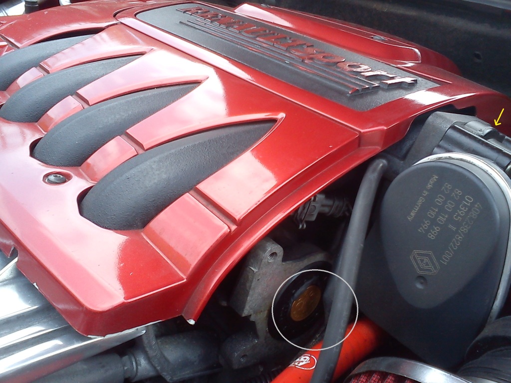

The 2 things that have been blanked are called core plugs behind them is the end of the camshafts where the horse shoe locking tool goes.
The 2p's are covering the holes from when they were previously removed. 15
Wow, doesn't inspire confidence in the quality of the cambelt change
End caps 7700106271 & 7700274026
