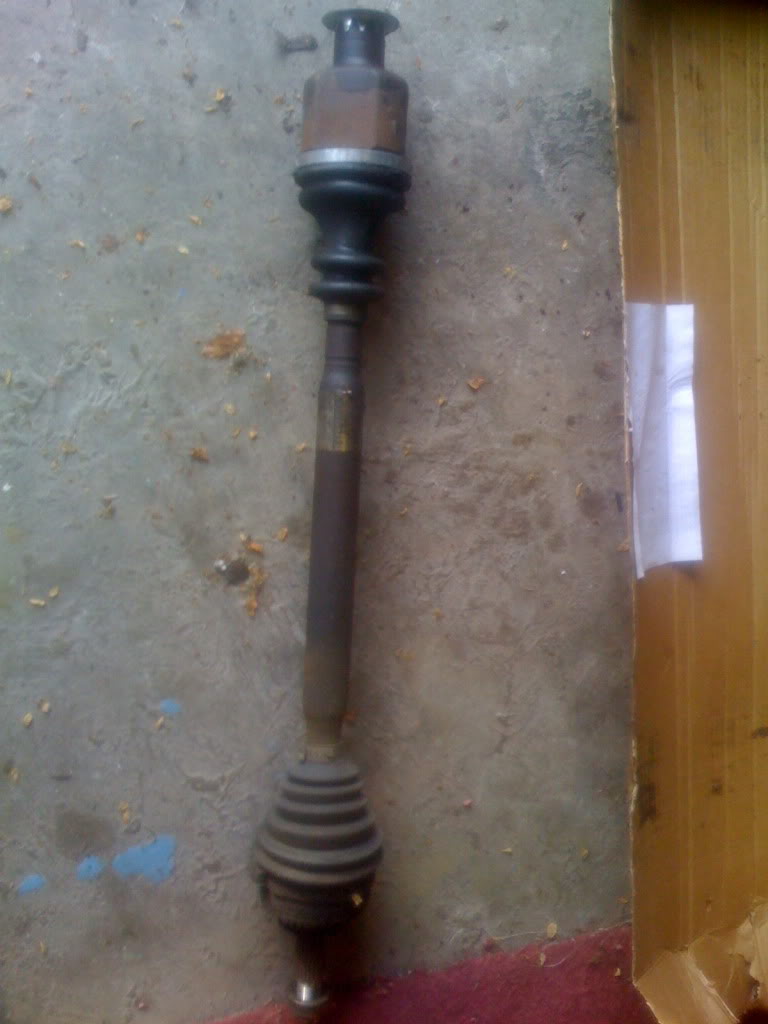

Got a drivshaft sent to me this morning, presumably a drivers side as requested but looks nothing like mine at all.
This is the one that was sent to me with part number 8200 225212

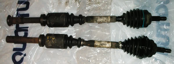

Mine looks like this (stozzas pic):
Can anyone check the part number for me or know from the pic what the story is?

Thanks to bmh I know now its a drivers driveshaft but from something other than a 1*2

So the part number matches the 172 cup on that list there, Seems to have abs teeth though!! Anybody reckon it would be ok to fit?

Going by the fact that the list shows different part numbers for the different clios I would send the 1 you have back and get the one for your car 8200352042 but your avator has confused me when you say 5 door lol

8200225212 is a drivers side drive shaft for a 172 cup 2001 - 2003 model ( CBIN SPL ). These are a single piece shaft and there not interchangable with a 2 piece shaft. If you get me your reg i will tell you what you need.

Lol yeah if I hadn't built the car I would be confused. Its a 172 non cup I need.

You need a 8200118577 or 8200257767. Renault do an exchange one 7711135155 at £125 + vat. I will see if i have a used one.
Your car is the CBIN SAN513 version
