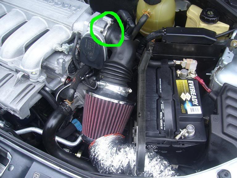

I just found out what it is. The main tube that connects the air filter to the engine isnt connected properly which is why it making an induction noise. I take it's bad to leave it as it is ye?? I just like the sound lol

Am i being stupid or is this hose hard to attach? I can't seem to get the hose round the metal bit as at the moment it lose? Circled it on the picture (not my car btw). I'm guessing this being loose gives me the induction noise.
Id take it back to the garage and go mental, who doesnt connect a airbox feed back on? They could have buggered up your engine! you could have been running it sucking unfiltered air in for months before noticing!

undo the clip as much as you can and just force it back over, 5 mins job tops. it'll eventually give in - try taking it off completely and putting a bit of wd40 or grease on the hose entrance, not alot though! just to help it ease on.
once on do up the clip, easy.
unfiltered air = bad for engine, the engine could have been inhailing bits of grit, oil, insects etc which isn't doing it any good.

also never ever go back to that garage, its basically sucking in air from the engine bay without going through the air filter.
shoddy job from the garage really mate, if you like the noise just follow the pipe to the big platic air box at the front of the engine and there 2 pipes going into it, pull off the one on the right hand side near the battery it will give a little more induction noise.
