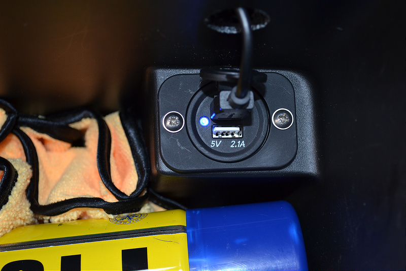

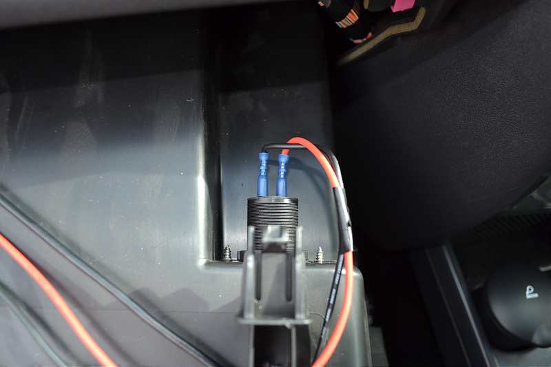

You can get 12v to 5v USB converters from ebay for a few quid. I put 2x of these behind my dash and you just plug the USB leads into them.
Matt e

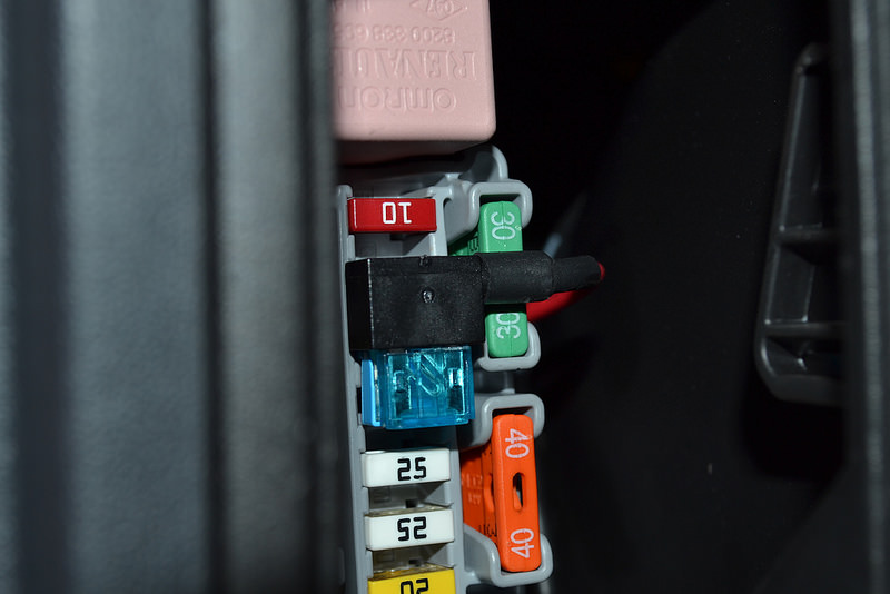

you can get piggy back fuses from ebay,
http://www.ebay.co.uk/sch/i.html?_from=R40&_trksid=p2050601.m570.l1311.R1.TR6.TRC1.A0.H0.Xpiggyback .TRS0&_nkw=piggyback fuse&_sacat=0
Fuse piggy back by mattageaton, on Flickr

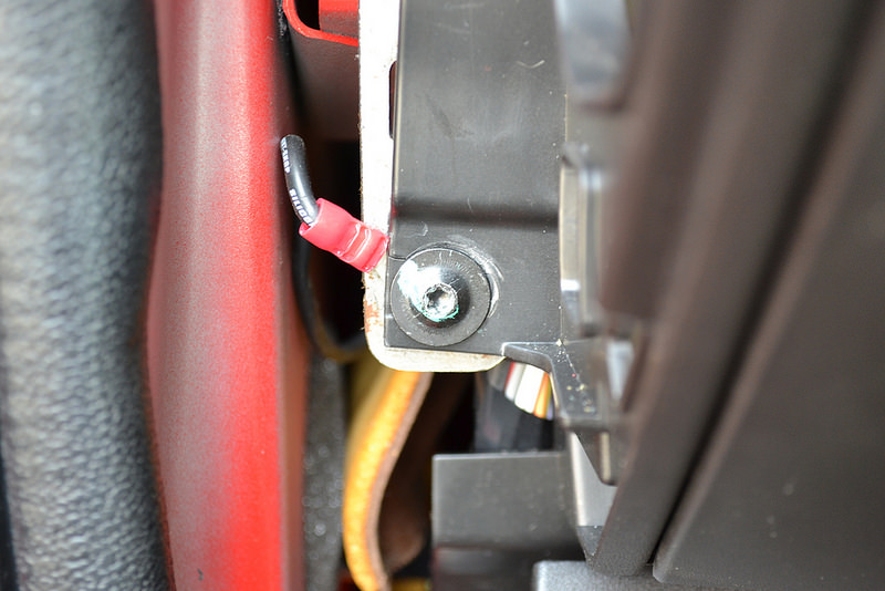

Earthed by mattageaton, on Flickr
Back of USB socket by mattageaton, on Flickr
12v USB socket working by mattageaton, on Flickr
