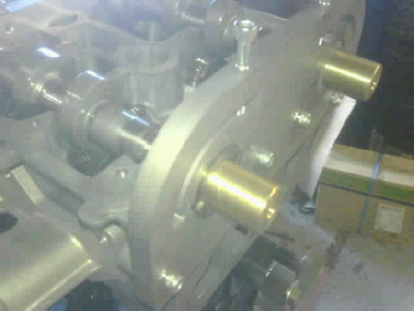

I thought ktec used catcam timing tools to set up 421 and 428 which altered the exhaust timing from standard if that's the case there must be a difference in the 438's unless it's so they can be fitted elsewhere with the standard Renault timing tool?

The timing tool ktec have is the one catcam recommend for their cams. Inlet or exhaust is slightly advanced iirc. Can't remember which. It's like grp N timing tool

That's what everyone assumes apart from 519and ktec who know, there's a thread somewhere which has a picture of the timing tool if it's just timed different on the blanks why bother if there's a tool to set them up in the 1st place unless it's so they can be fitted by anyone who doesn't have it (£300 iirc)
it's nothing like a group N tool, it's a fully adjustable tool which allows you to dial in the cams with the rocker cover removed
You mean its nothing like the cheapy copy group n tools, I would think its very like the actual tool the rally guys were using ;)

they ARE made to suit OE timint THAT'S THE WHOLE POINT!!!!! 421's you need to f**k about, 438s go straight in
I was under the impression that with 421's if you tweek the exhaust cam slightly one way, they run better. I assumed the catcam tool did this. Not to say they don't run with standard timing as mine runs fine, and will run even better when I get the idle raised.
This doesn't look like it would twist :approve:
