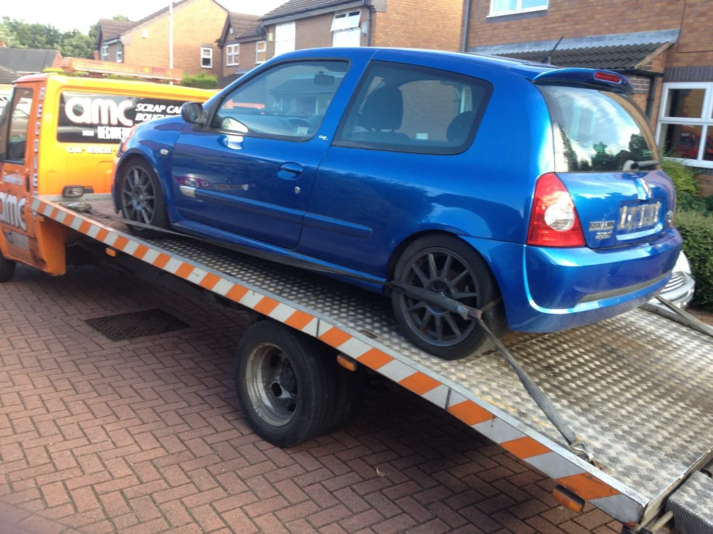

On the truck when I collected it:
Unfortunately we completely destroyed the splitter getting it off the drive and onto the truck (need to lift the suspension, struggled to get it down my drive!) but the splitter was already cracked so will have s trip to skoda some time.
Anyway, my mate had an idea what might be up with it, it cranked over but never started. Got home, charged the battery, had a little fettle and boom, away it went :D

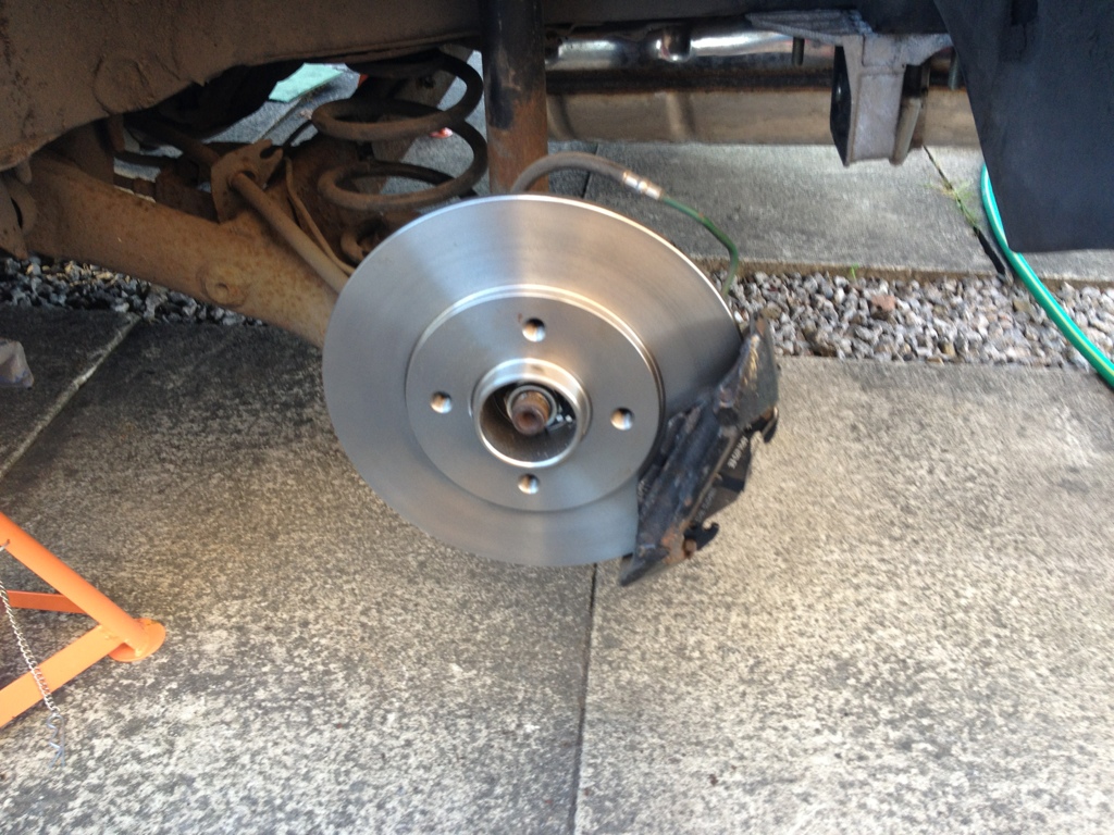

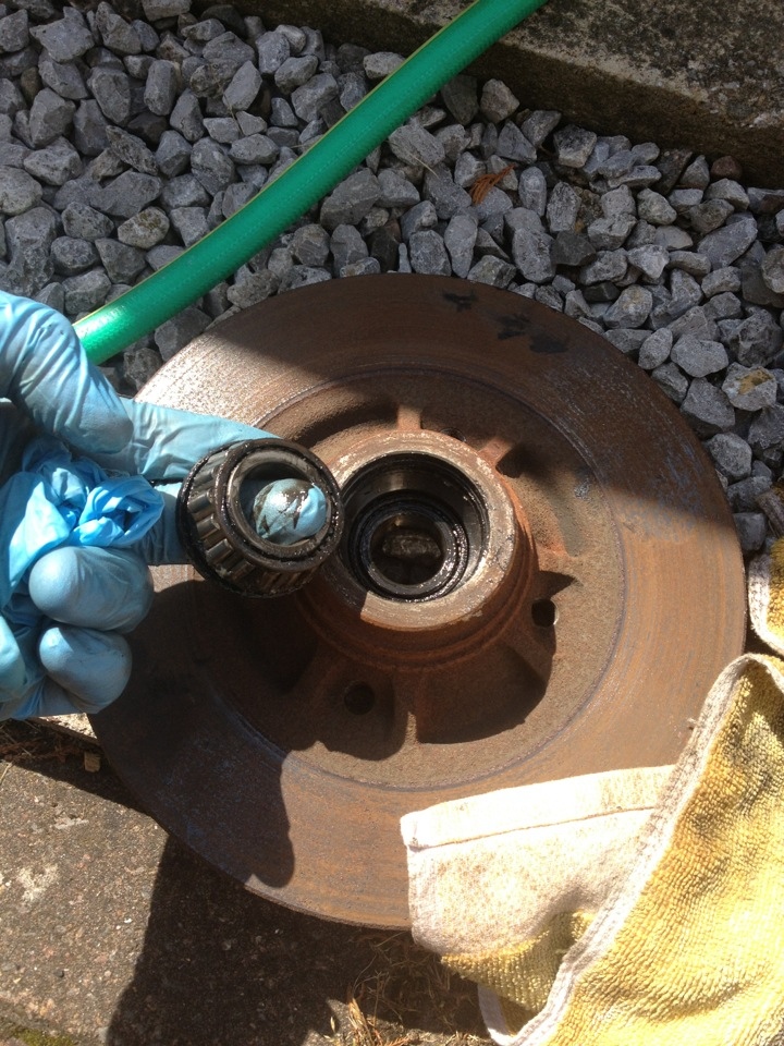

I also did the rear brakes, the old disc came off and the bearing had split in 2 and was oozing grease. This didn't look good to me!
Anyway, nice and new, thanks to G172 :)
