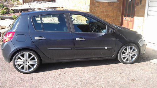

So here are finally, some better piccies of the Clio.
Not done a great deal to her yet, but enough to make driving a little more pleasurable....
Rocking out the Nervasports. Yes it needs lowering. I have some 40mm drop springs (FK's) that I need to fit.
P3290871 by johnpape83, on Flickr
I can assure you, the wheels look like I've hit a kerb, however, they are straight. They were checked not too long ago.

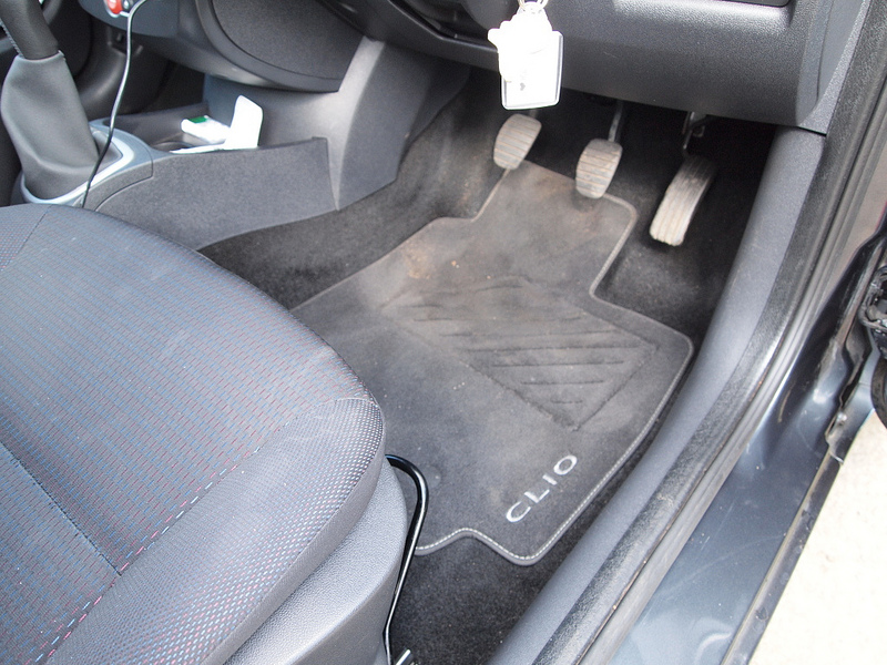

Some nice Clio mats. Looks rather dirty, but they were not long cleaned. curse living in the countryside!

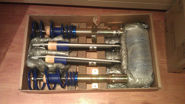

This weekend's job!

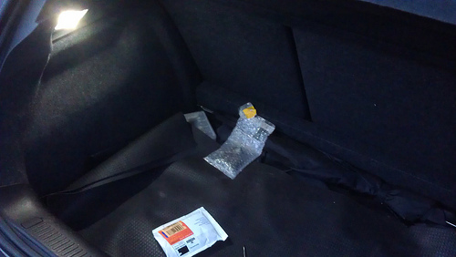

Out of interest, not done the rear shocks on these Mk3's before. They easy to get out?
Can't believe Renault designed the fronts to sit under a scuttle panel, that needs the wiper blades taking off!
  Superleggera'd MK3
Yeah man, thats what i thought when i saw the fronts....had the wipers off in seconds though. The shocks were easy mate. The bolt is inside the boot, then pull out the fabric stuff at the side inside your boot and it will be in there. The pain is getting the new ones on. You have to re-drill the washer to 10mm i think to fit on the AP shocks. Didnt realise till I read the instructions properly. Lucky my mate had a pillar drill :)
Coolio. Yeah, I saw that too about drilling out the washer. Gonna have to speak nicely to a neighbour I think!

You'd think for £500 quid it wouldnt be too much trouble for them to supply us with 2 correct washers at the combined total of about 50p

your telling me after getting a set of coil's from germany, they didnt send out two friggin washers bored out 10mm bigger?
blinkin hell....
  Superleggera'd MK3
yep.....they make you re-use the standard ones and get you to drill out an extra 2mm to hole .......*sigh*

lol reminds me having to drill out the lower strut bolt holes on my car as they are aftermarket and didnt match the hub holes.....
if its ' made ' to a certain model spec, why cant they get things like washer, bolt hole diameters right....
  Superleggera'd MK3
exactly what i was thinking mate.....especially as it is performance spec goods etc you expect them to fit properly......oh well.....guess not :)

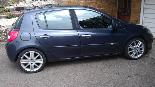

Needs a good wash, but now it's all settled, here's how she looks.
Big thanks to Tony, and Nigel down at Automax for sorting out the alignment and camber. Car handles far better now over standard.
You can also just make out in the pic (when zoomed in anyway!), I've got my studs and nuts on the rear. Fronts need doing next.
