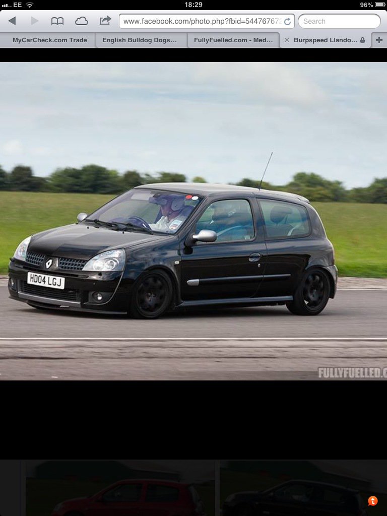

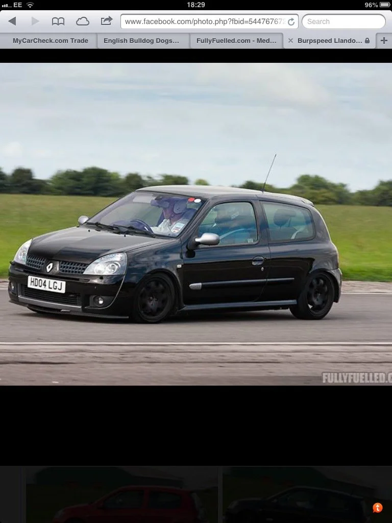

Yeah you could be right there. Despite what people say about K-Tec, they set up the coilovers for me (for free) how I wanted it and they've performed well... whereas my Gaz ones were probably never set up right.
Oh and just to add, anyone looking for 'lowz' then they're not the right choice, I don't really know why people say this as tbh they really don't go that low!
Bluebeard
  Whichever has fuel

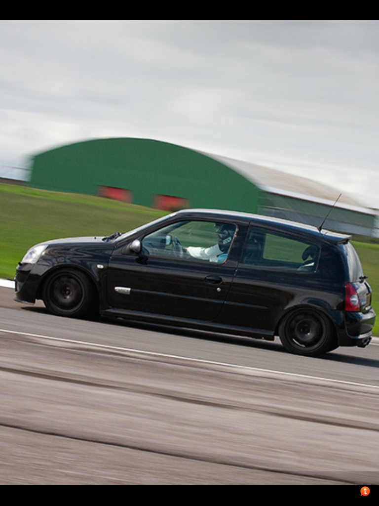

Really?! I thought they went really low!
These pics also show how soft they are!
CrippsCorner
  Astra VXR
Well that's under force isn't it, going to be different from just a static stance. My request was pretty much 'as low as they can go' and they're definitely low enough for me, but I don't think they're extreme by any stretch of imagination...
Bluebeard
  Whichever has fuel
Yours will go lower. Look at the thread left on the front strut. They'll go all the way down until the subframe hits the floor.
