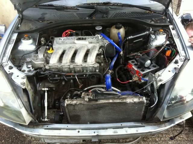

I want to make space for a new induction kit without need to move the battery into the boot, just setting both race battery and ecu nice and flat over the gearbox, pretty much like this one....
