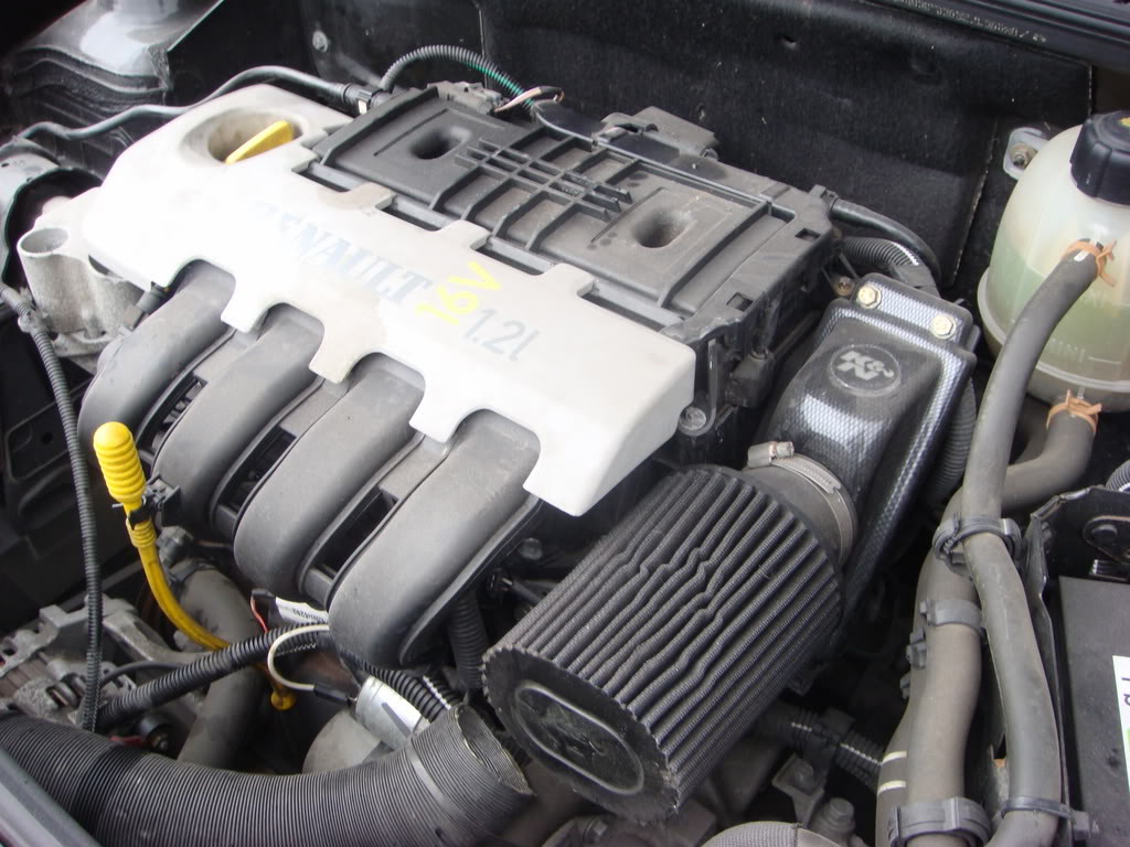

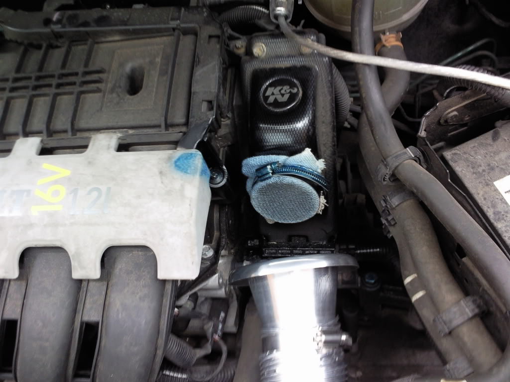

this is my engine
basically there was a cloth over the hole where that big filter is...

A cloth over your inlet?! WTF. I'm unsure of what you mean by covering the inlet, but taking that out of the equation...
9/10 this is an electronics problem. You have no cable as it's a fly-by-wire throttle. It's going to be either the pedal or the throttle body itself.
Mine was the throttle body, my pedal was fine.
Christopher
  Z4M

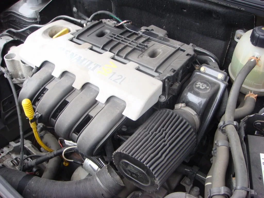

this is my engine
Why would you do that?
Filters are designed to FILTER. Clothing is not.
If anything, the cloth would have been more restrictive! Let alone being a stupid fcuking idea. :eek:

Stupid ideas aside, If you didnt have any filter of any sorts and just had a cloth, then you really need to have a look inside there the pipe goes. Can you get pics of your current setup? Should be easy to fix unless the cloth made it into the head, then you could be in serious trouble. Im guessing it stuck in the butterfly because the throttle isnt responding. Where are you based?

lol well the cloth did make the car respond alot better... am based in yorkshire.. ive stuck my phone camera inside the filter and took a picture, all i can see is a small hole...which am guessing thats where the cloth when into!
is there anyway to remove the plenum? my mate said we would need alot more tools to get it off to see... the cloth is a bout 2"x2" sized.. it was folded a couple of times
