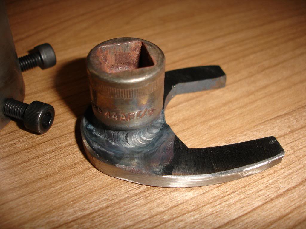

First is a old machine spanner that I cut the end off and as it was too big I welded one jaw and ground it to 32mm then welded a 1/2 inch drive socket on so I can get extension bars on it.

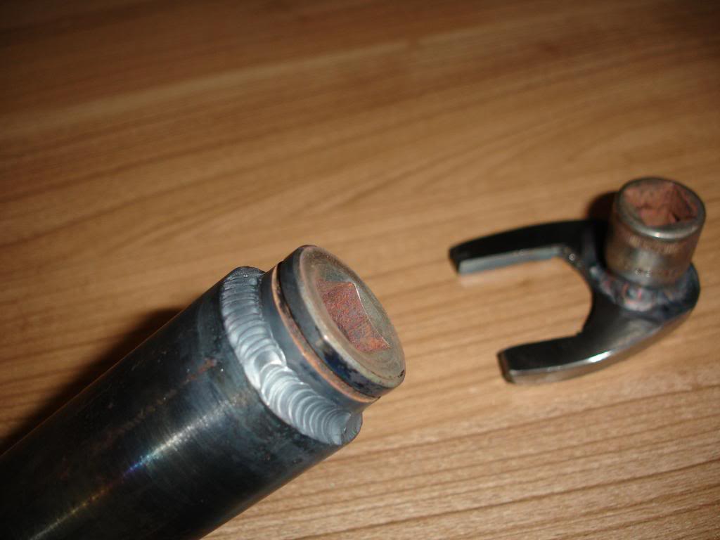

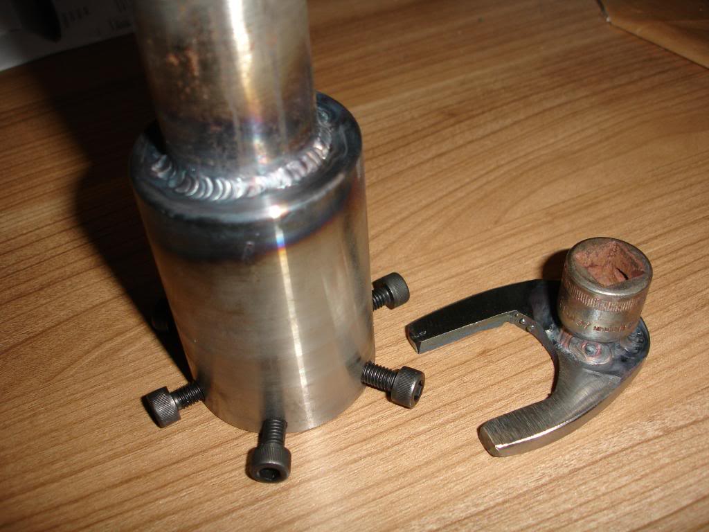

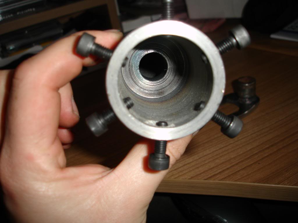

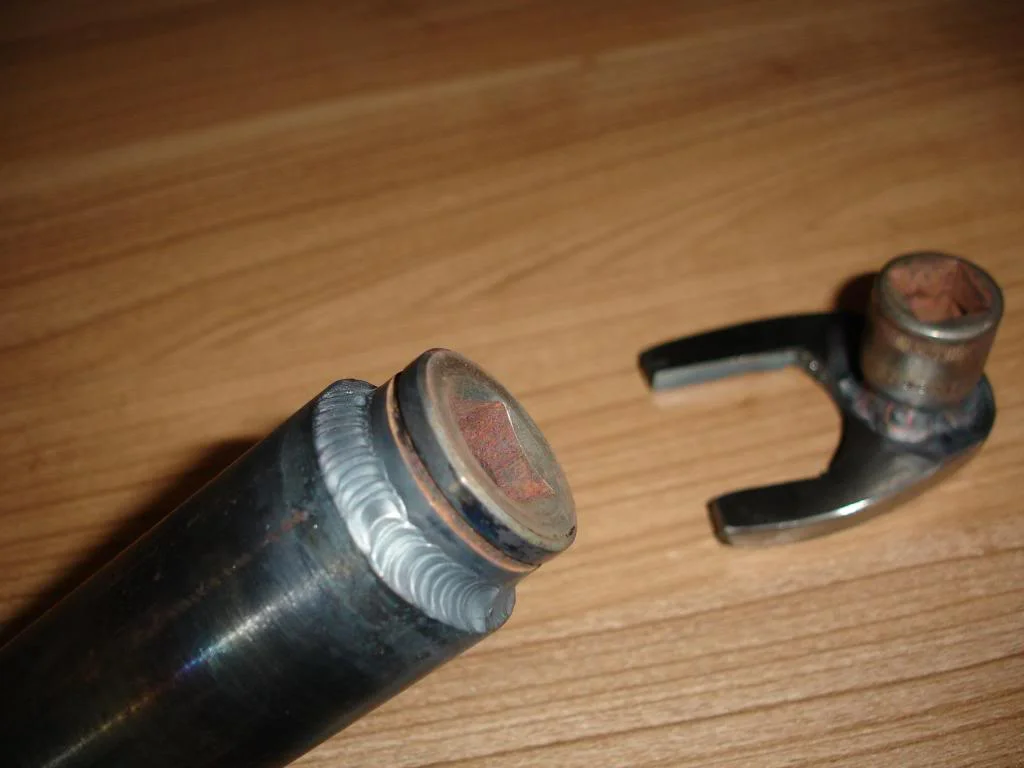

next I decided to make one that will slide over the tie rod, It comprises of a tube with a 1/2 inch drive socket welded in the one end then I turned and bored out a sleeve and drilled and tapped 6 holes in the end so they will line up with the flats on the tie rod, so in theory I can tighten the screws and it should lock onto the tie rod (the screws have got to be changed to grub screws).
