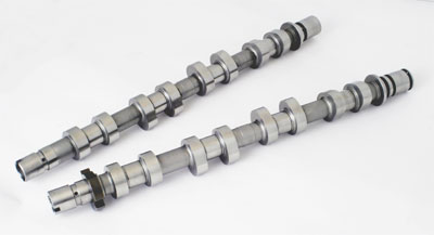

Decided to go for it, so I have items in my possession for POWER! So I need someone to map it.
Mind im in Scotland.
Anyone you can recommend?
What kind of 'items'?
As Kyle said, I'd make the trip to Paul, well worth it. Or AndyRG depending what side of Scotland you are on!
rctempire
These.

TBS will be next options. But spent a whack on those bits so far.
