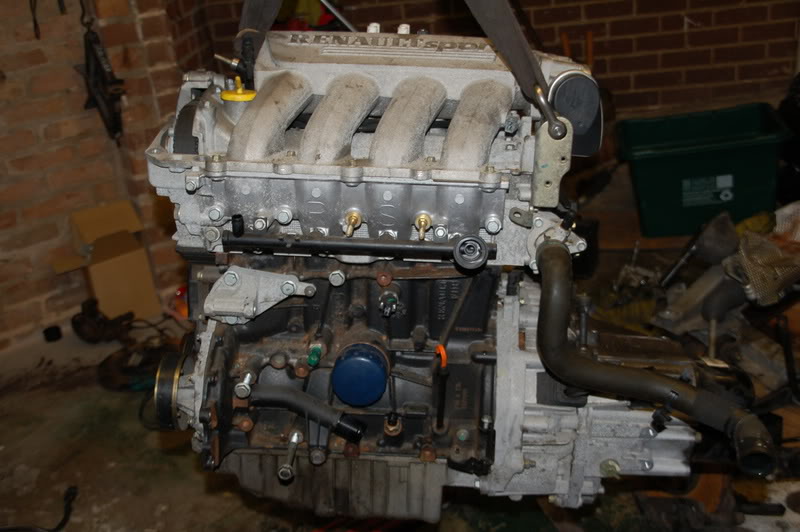

If you are going to go to the effort of matching inlets, you may aswell just get an RS lower and match the upper to it, or if you really want to perfectly match it - start with an RS lower in the first place.
The RS lowers are a larger bore all the way through compared to normal ones, Renault didnt just open the ends out. So in reality the 'best' setup you can get is a 'matched' RS lower, which is matched to the head, then a standard upper which has been matched to the RS lower.

Seems the early 172 cups don't have RS inlets, tell tale signs of the early ones are orange side repeaters as standard & for those with ECU access software version 6xxx xxxx opposed to the latter 172 cup 7xxx xxxx software... Just from what we've seen when having them apart

Wouldnt get too hung up on this RS inlet. Lets face it, the Cup is hardly a rocket ship compared to every other Clio Sport model. Still room for improvement even on the RS one!
The RS has a better cast thats why its 'good' to start off. The rest vary in cast quality
