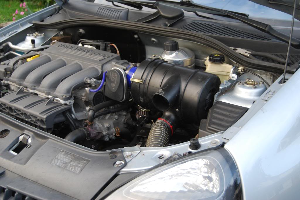

Looks like this
http://i395.photobucket.com/albums/pp31/GTBen/064.jpg
