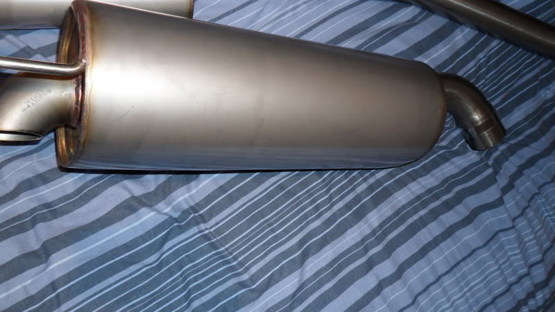

My 172 btb exhaust arrived today
Chris205
  Many Things
Just thought id pop a few pics up before its fitted tomoz
I first contacted btb last week about the system, there wasnt any in stock but they were in the process of making another batch :D
So I arranged to buy a system and called them up on monday, gave my card details and my delivery details
I got a call yesterday to say the first system was ready for despatch and would be with me today
So this is how it arrived, I thought they'd sent me a BTB guitar tbh
it was very well packaged and took about 15 minutes to unpack :sleepy:

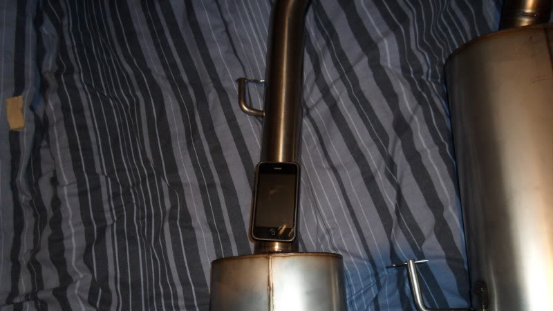

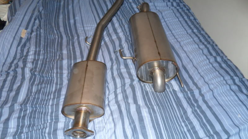

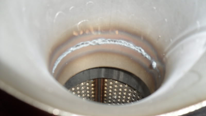

inside the centre box, before my de-cat gets it all carbon'd up

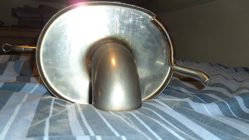

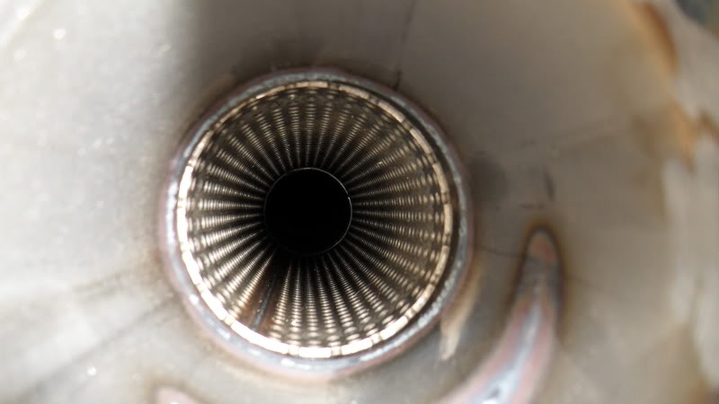

inside the tailpipe

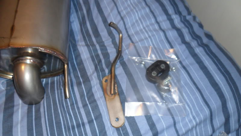

and the mounting brackets
Im very pleased with the service I recieved and would recomend them as a company any day,
Ive got the car booked in at rs tuning on the 26th of march for some power runs, the car made 160 with just a de-cat and itg so hopefully will see somemore gains with this fitted
I will post some pics at the weekend of it fitted to a ph1 rear bumper and then with a ph2 :)

The mounting confuses me, looks like the hook is on the wrong side of the silencer... Need some fitted pics for my stupid brain.

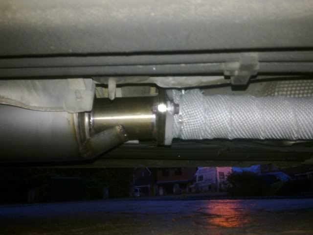

mine didn't fit!! the flange matting the decat flange seemed to be slanted and not square with the pipe, which lifted the front end of the centre section and lowered the rear end.
Anyone know if this flange is supposed to be slanted or square? Asking because my decat pipe is custom powerflow too.
  182
Mine did this, then my uncle fixed it somehow, I don't know how and whether he will remember I don't know!!
I'll try and find out for you, but yes I had exactly the same problem, it just didn't fit together properly, and that was to a standard cat.
  Focus RS mk1
mine does looks slanted but not enough to cause a problem it fit perfect, but the de-cat also looks slanted to match it.
Maybe its your de-cat thats causing the problem?
  Clio Sport xxx
what a palava!! not only did the flange cause a problem but the centre section was a good inch too long! I want to speak to BTB about it because it wasn't acceptable, the guy who modified/fitted it was disgusted with the fitment. He fitted the rear section in position, fitted live a glove. he then offered up the centre section and the centre hanger was well infront of the exhuast rubber mount, and it would have been impossible to mat the centre section flange with the decat flange - proof that this section of pipe was simply too long. Cost me £100 for fitting and all the cutting about, hoping BTB can contribute towards it??
