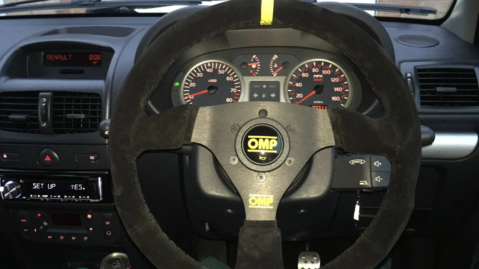

After the balls up with the OMP boss from Demon Tweeks I eventually sorted a MOMO boss from Merlin Motorsport in Essex. Thanks for the link @182_steve
So with boss now in hand it was time to fit with the OMP Targa wheel. Was quite easy to fit to be honest hardest thing was making sure it was straight. Note the boss kit only came with 1 resistor an was unsure which plug to put it in, luckily I had been to Maplins and got some 3.3ohm resistors for the grand price of 18p and used these instead.
I'm pretty sure it's inline but that will have to wait until I test drive on a nice smooth road.

Does the boss bring the wheel any closer to you than the standard wheel? I know you can get spacers but just wondered if the boss itself brought it a bit closer.
No probs buddy, glad to help! Merlin are really good and that's where my boss ended up coming from as you know :up: Wheel looks smart!!
That's an interesting question about the wheel being closer. I think it might be a little? Not sure! The boss is quite big but the wheel is so flat to compensate, can't be much different to the standard big wheel

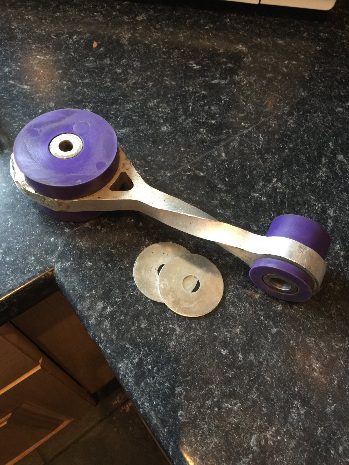

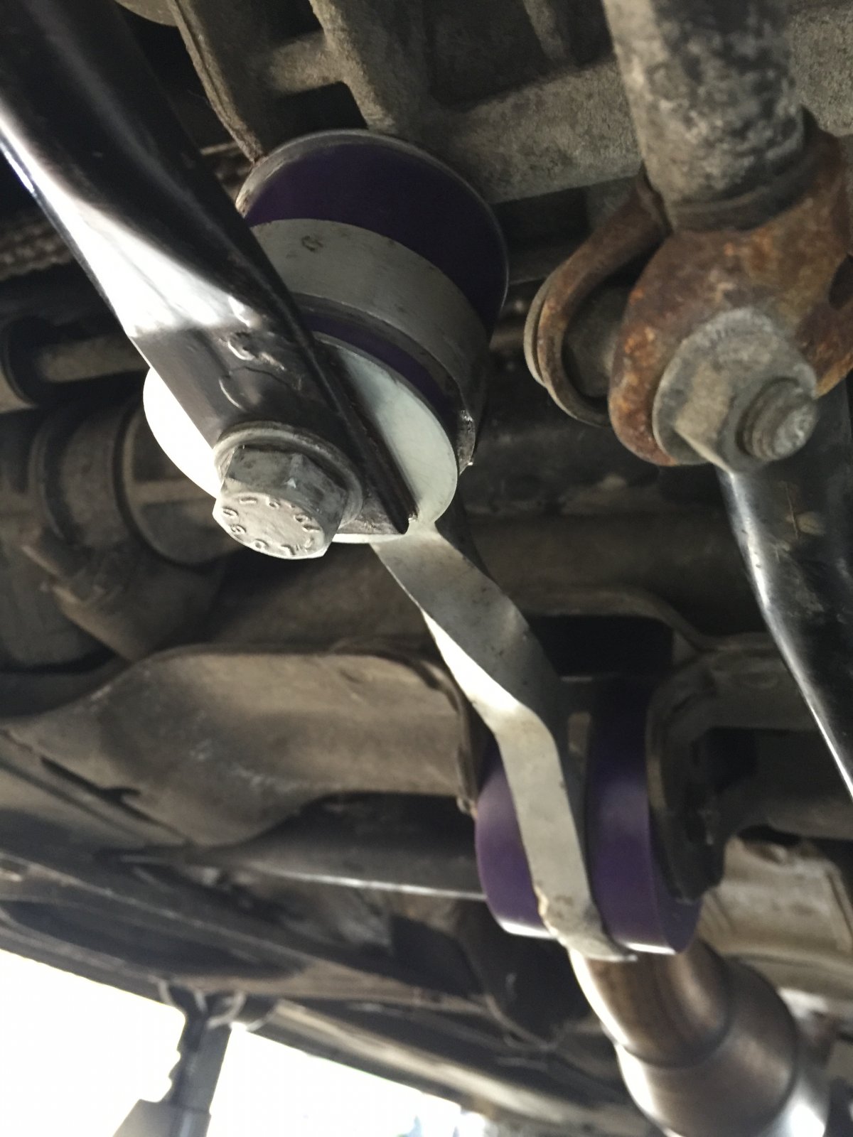

After the postie brought me the mount thought I best get it on before I go away to Centre Parcs.
It's surprising how such a small thing as a mount can make a huge difference. Now the upper mount and dogbone are done I'll be saving to get new lower arms with Powerflex bushes, new ball joints and track rod ends. Probably get the anti roll bar flexed at the same time then get a rear arb. Not sure if it'd be worth flexing the rear beam pivot point though, some have said it does help.

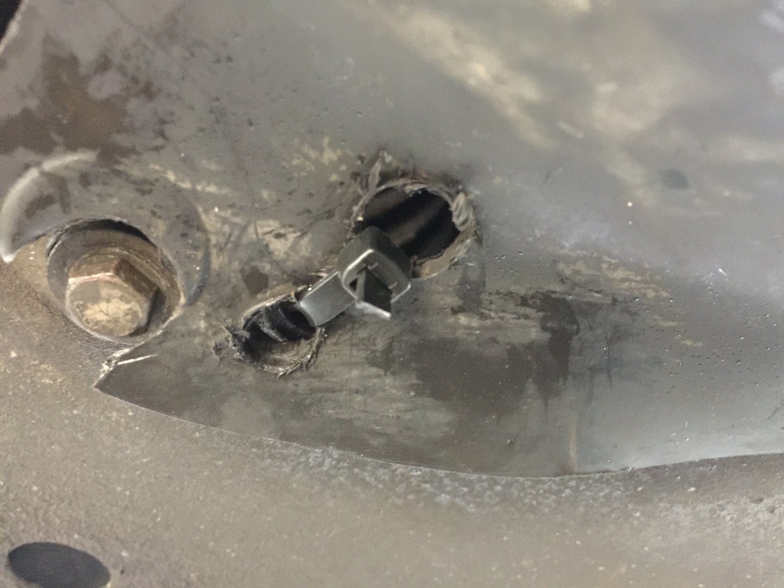

And if it's not got tie wraps on it, it's not a proper race car haha
Jekyll
Same!
I have always said that poly bushing the lower mount is such a great mod to do and really recommend, especially when the cost is so cheap but the difference is noticeable.

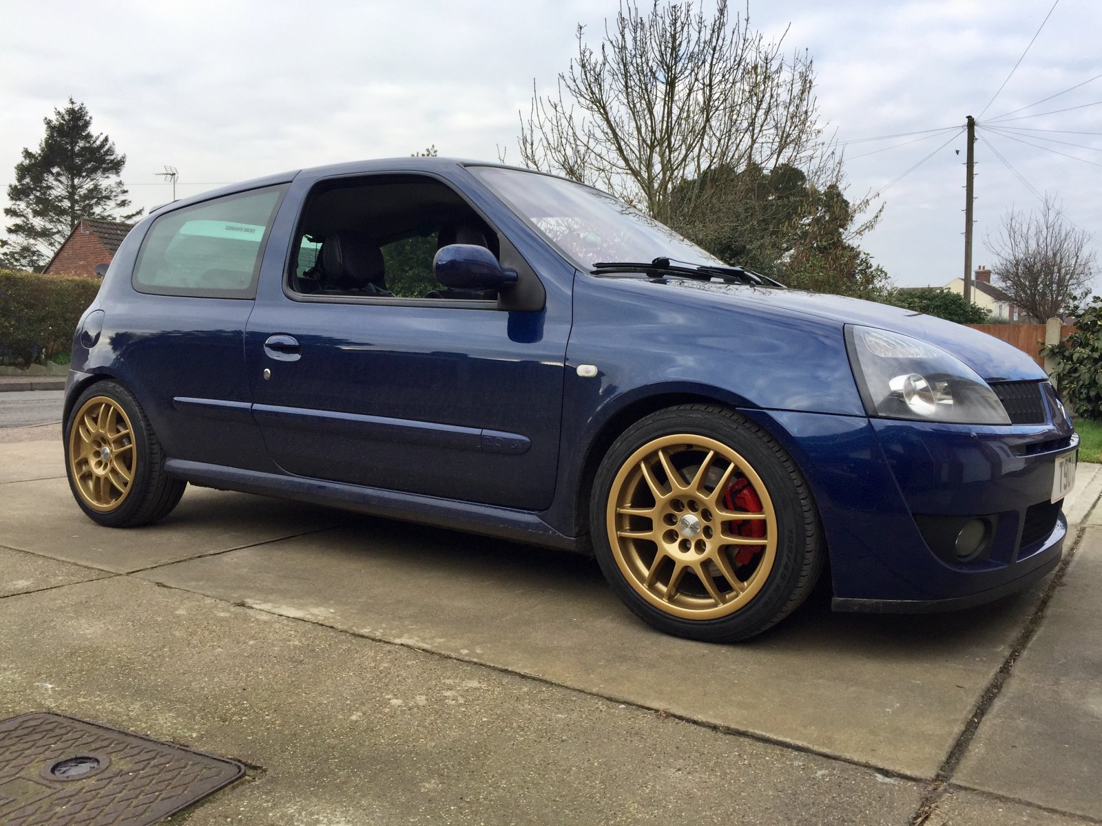

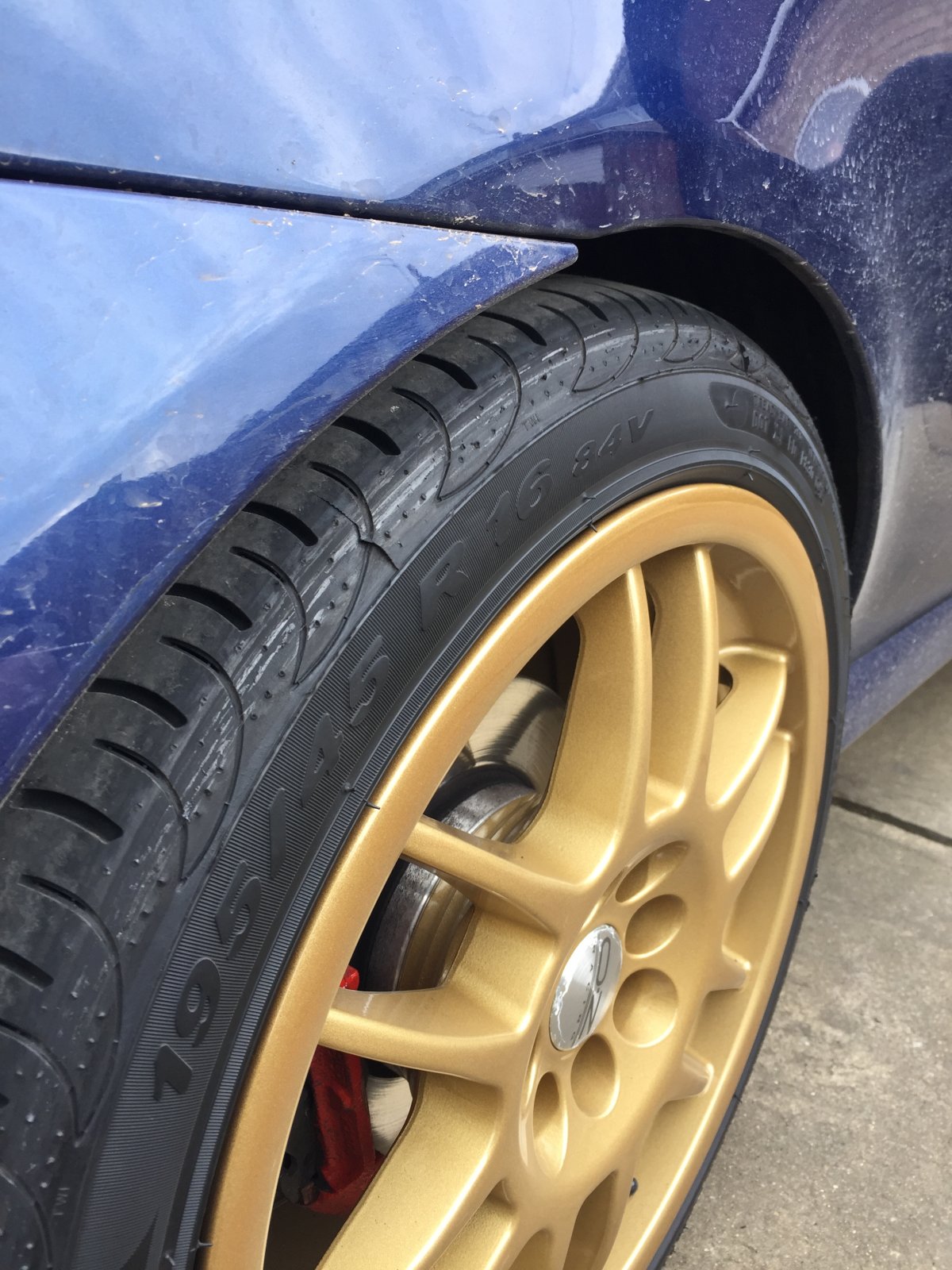

Not much has gone on with the Clio lately mods wise but today saw the return of the gold...
But 16mm spacers and et37 alloys is not a good combo...
Spacers will be coming back off in the next few days when I can be bothered an will run without them for the summer.
Looks very smart buddy :smiley: seen it mentioned a few times now it's starting to look a bit Williams, and I like that :cool: ha!
Defo keep those spacers off, just use for the 172 wheels

I had same issue fitting F1's. 25mm on front is fine but the rears I have 10mm hub spacers and 5mm wheel spacers. Removed the 5mm and still rubs!
I think I may be stealing the gold wheel idea too, looks great!

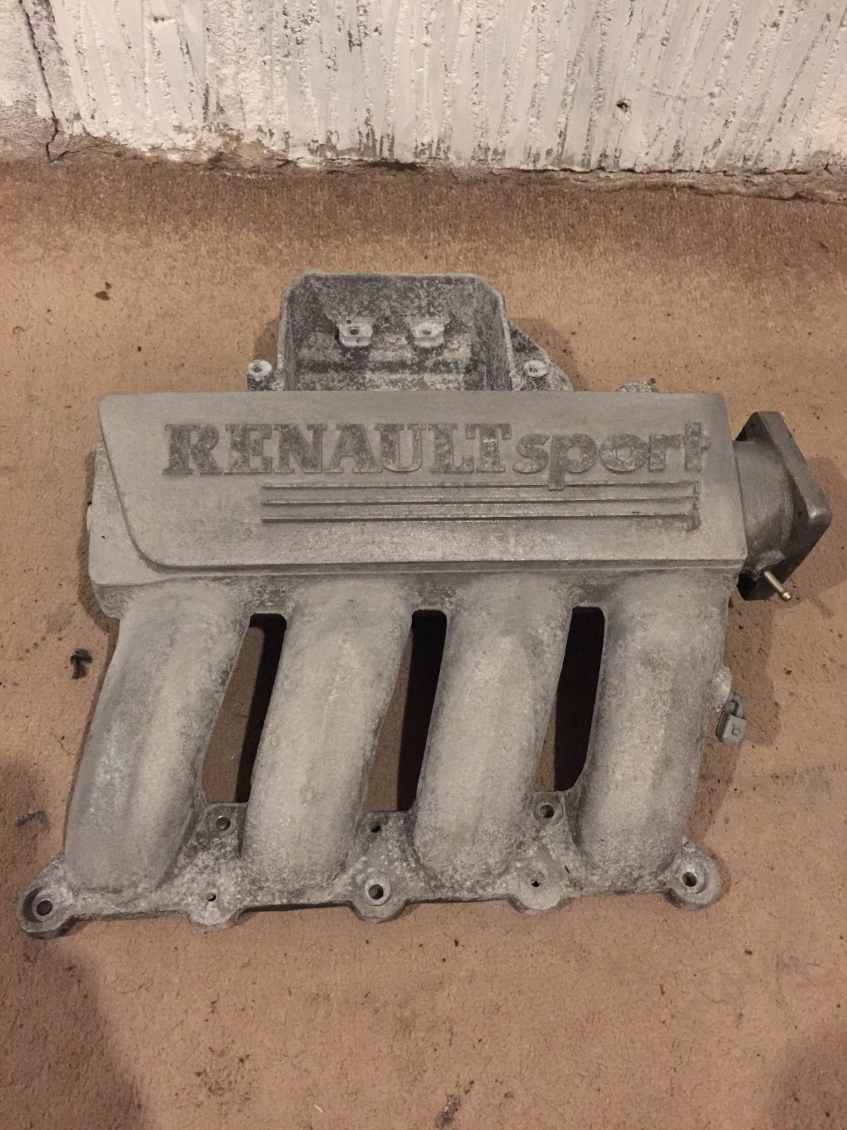

Not much has happened with the clio since the last update as I've been so busy with work.
But today saw the impulse purchase of a upper manifold from my local cit-ren breaker for a mere £20.

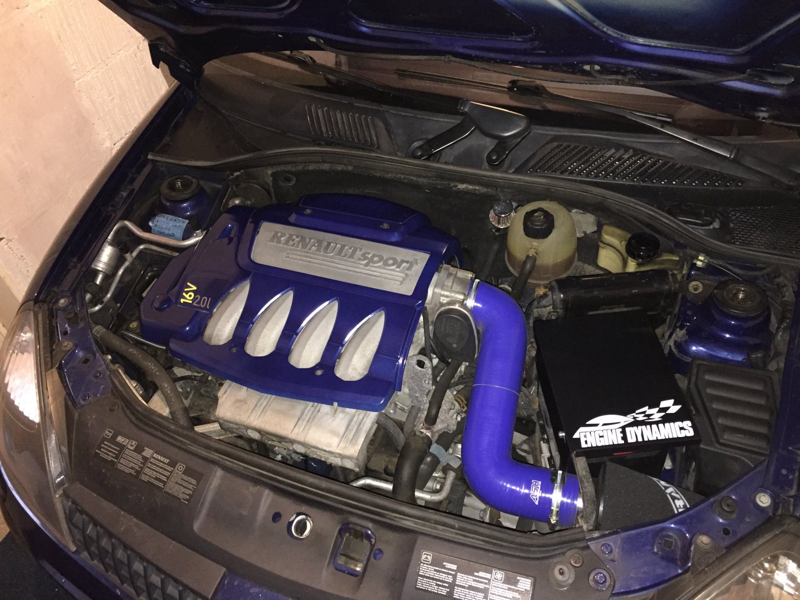

This will be powder coated gold to match the alloys, fuel rail and throttle body will be rattle can'd black to not stand out an hopefully freshen up the bay.
Hopefully I'll be able to source a new coolant bottle to add to the freshness

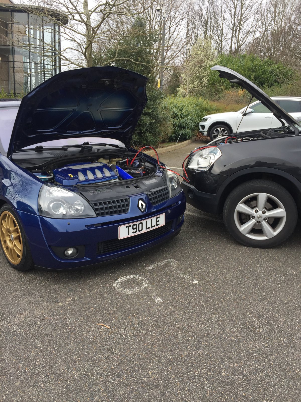

So this happened yesterday...
Dash lit up like an xmas tree an left me stranded 25miles from home, diagnosed as a faulty alternator. I managed to limp it home without it dying again and shut it away in the garage... out of sight out of mind...
