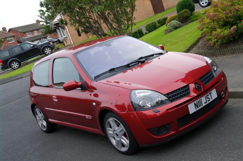

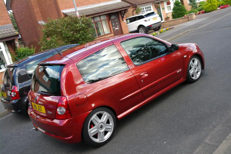

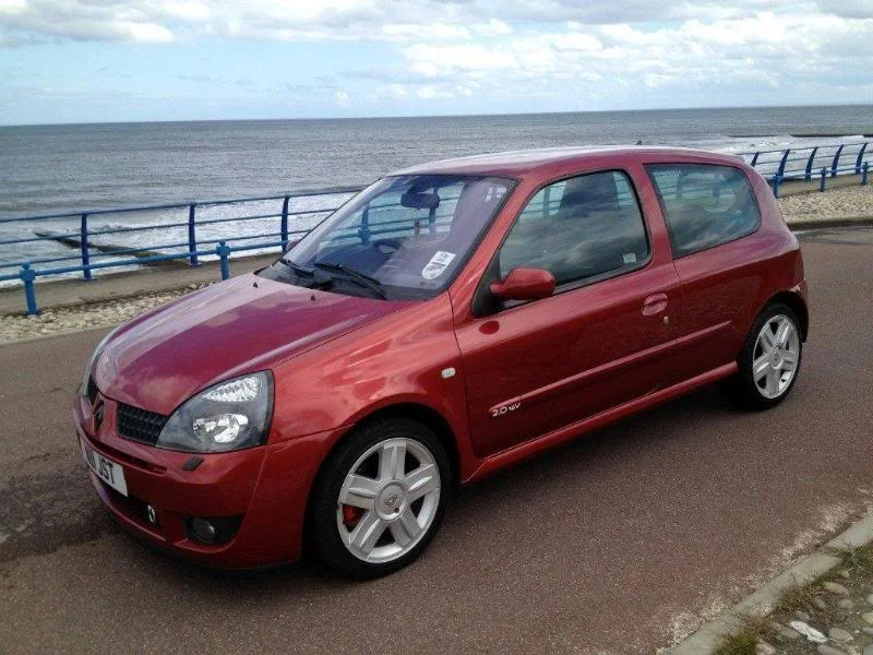

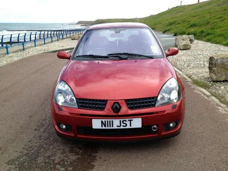

Just introduced myself and after picking up my car this morning at 10AM I got cracking straight away.

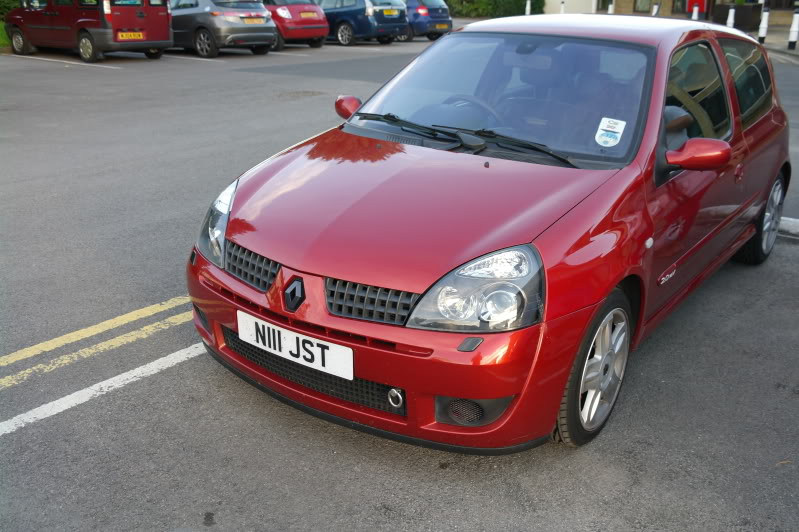

It started like this - (dealer pics)
Upto now I have;

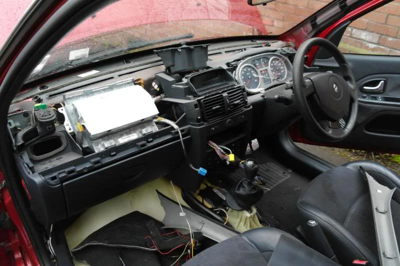

- stripped top of dash
- removed old ICE cables
- LED number plate bulb
- LED sidelights
- aero wipers
- short aerial
- in process of removing an old redundant alarm

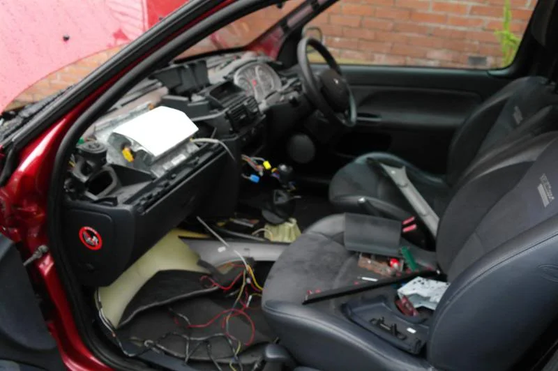

As I left it today;

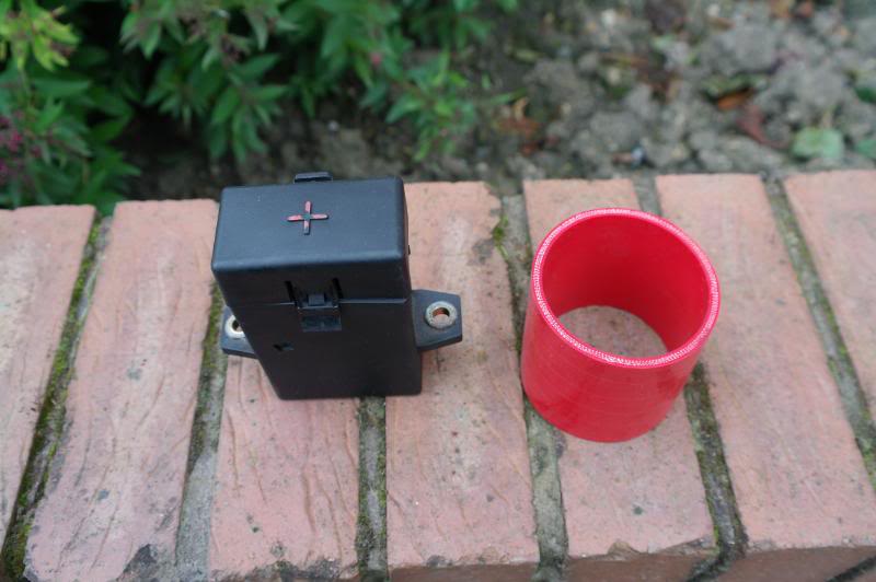

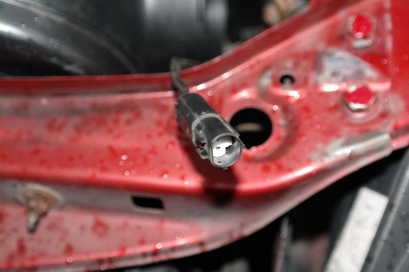

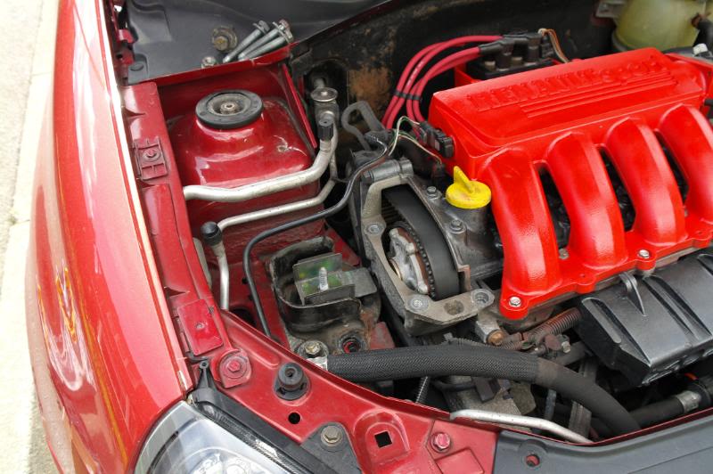

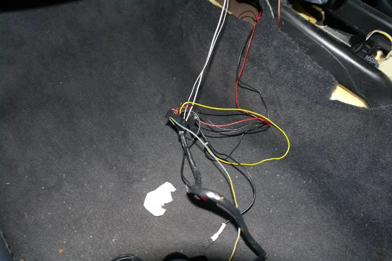

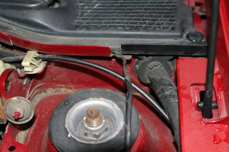

Question I have for people is - anyone know anything about these cables;

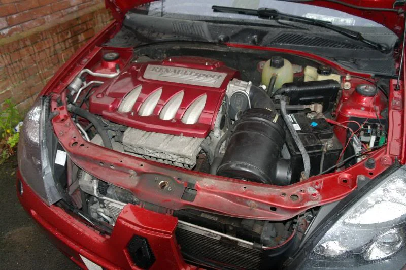

Engine bay RHS - ties into a power cable before going behind bulkhead;
Then this appears to be on the interior side but cant find a module anywhere as yet - any ideas?
  182 Cup & DCi 172
It was indeed the bonnet shut sensor and has duly gone in the bin along with the remnents of a Cobra alarm and ICE wiring

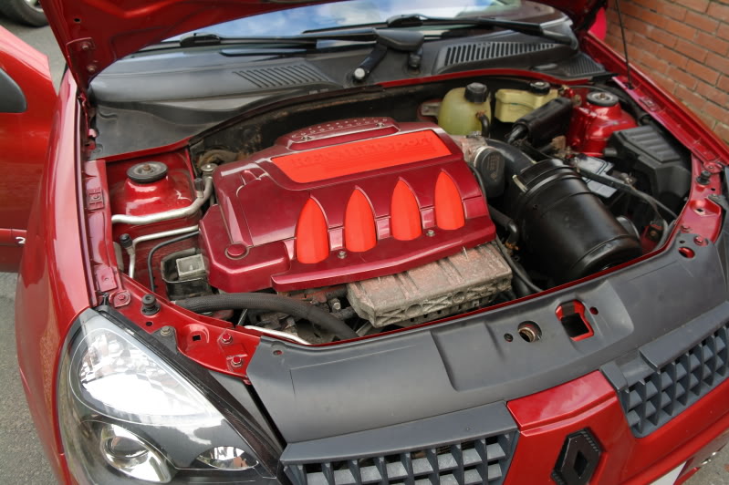

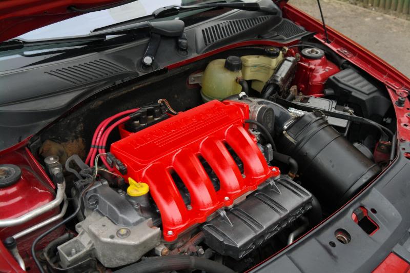

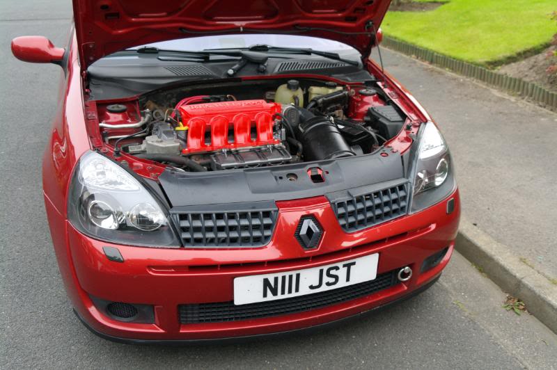

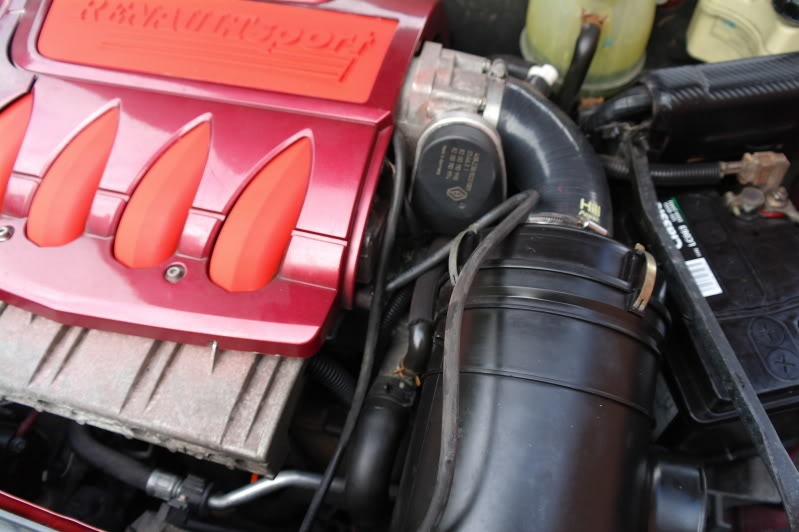

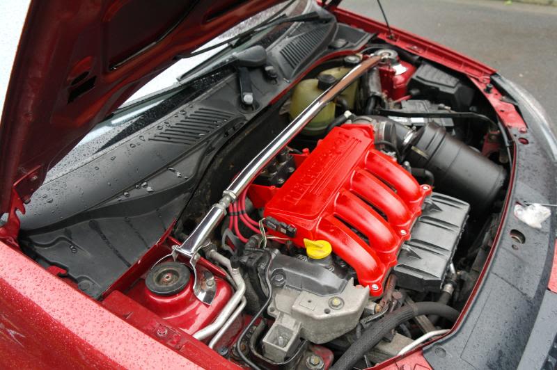

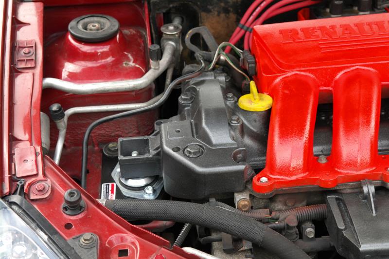

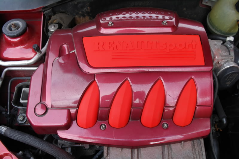

Painted the inlet plenum where it shows until I get another manifold to port and paint properly;
Another question today as well, this hose going to the throttle body - what is it for and why is mine blocked with a bolt?

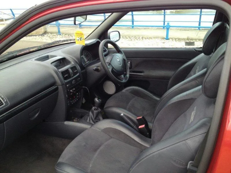

Also got the paint cans out for some interior and exterior - the wheel centre badges have been painted anthracite as well as rear Renault badge;

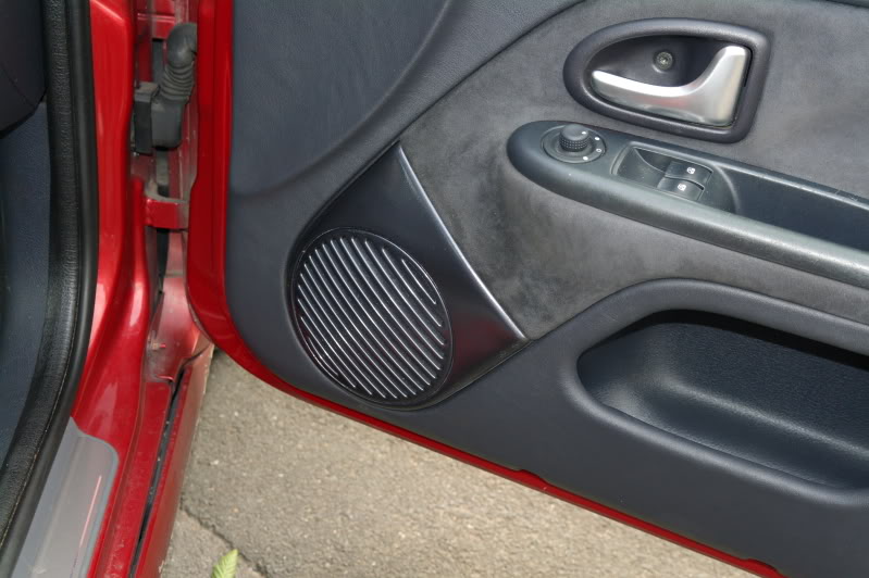

Moved onto the interior and painted the dash inserts and the speaker grills to get rid of the Carbon wrap and silver paint;

Wow. Some great progress.
Question. Why did you remove the botton shut sensor ? Does your 172 not have a standard alarm ?
Sam!
  182 Cup & DCi 172
Need to do more digging around on the car for the standard alarm but the Cobra was left with wire cut yet still connected to the battery - same as remote cable for ICE and few other cables. The alarm had been wired into the hazard switch for the flashing lights but the button was left not working same for the interior lock button. Shocking wiring in all honesty - fixed now though.

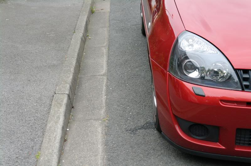

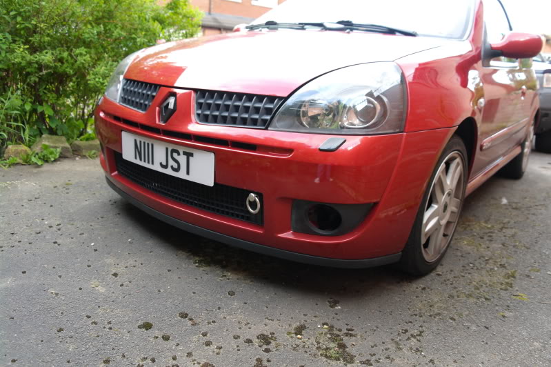

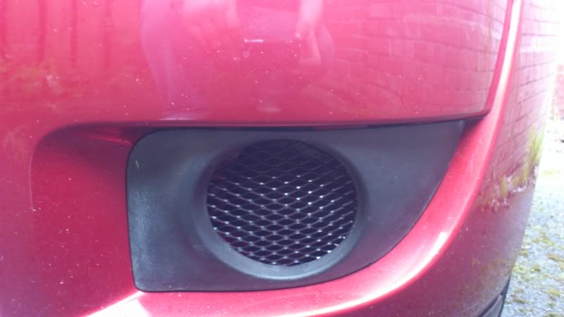

Few little odds done tonight when had a spare hour - first up fogs meshed over;

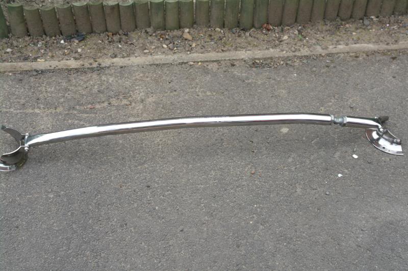

Started stripping the boot trim and measured up for rear strut brace;

Good progress! you don't hang about! how did you hold the mesh in place?
Does it not look funny compared to the grills tho?
  182 Cup & DCi 172
The mesh is glued and bonded in place to ensure it is nice and strong
Looks ok compared to the other grills but am sure I can chop up a bumper grill to make it match if it doesnt grow on me

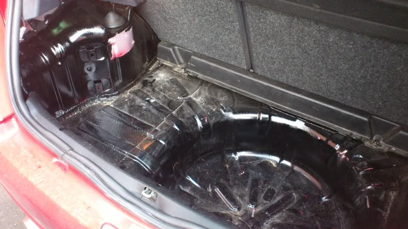

This car used to belong to 2 members on here after tracing its history and was caged with buckets and harnesses and interior painted black.
Painting over the old strut brace location as mine is going to be slightly different design and mounting points.

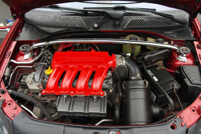

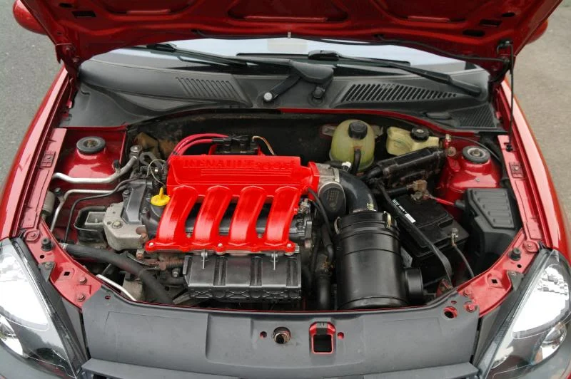

Started with the rattle cans again
Engine started in a black/grey metallic along with a red inlet
Front Renault diamond painted anthracite;

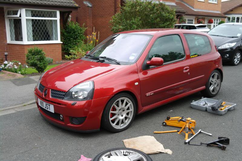

How the car sits before the coilovers arrive;
Rob

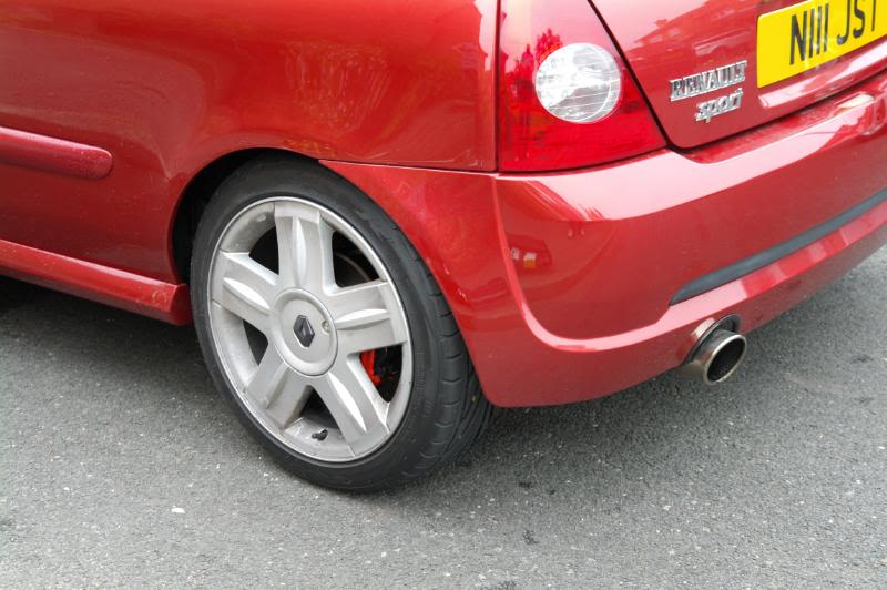

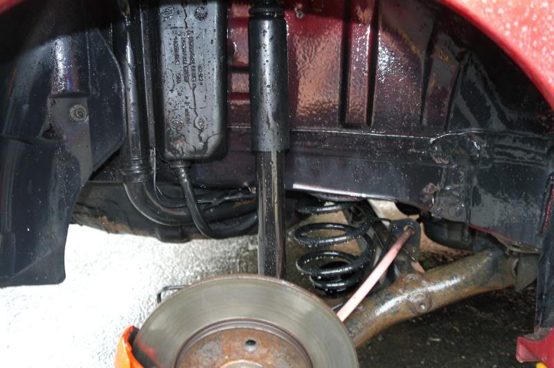

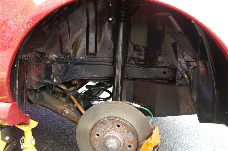

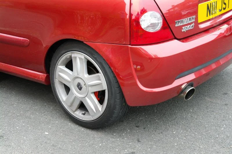

Fitted rears and arches cleaned out;
New rear ride height;

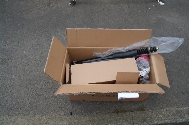

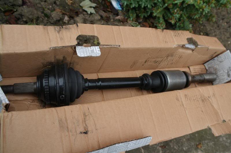

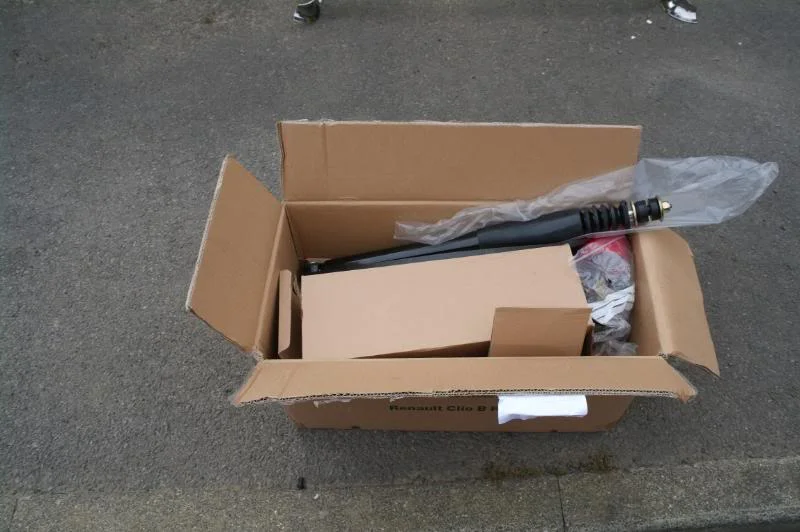

New OSF driveshaft;

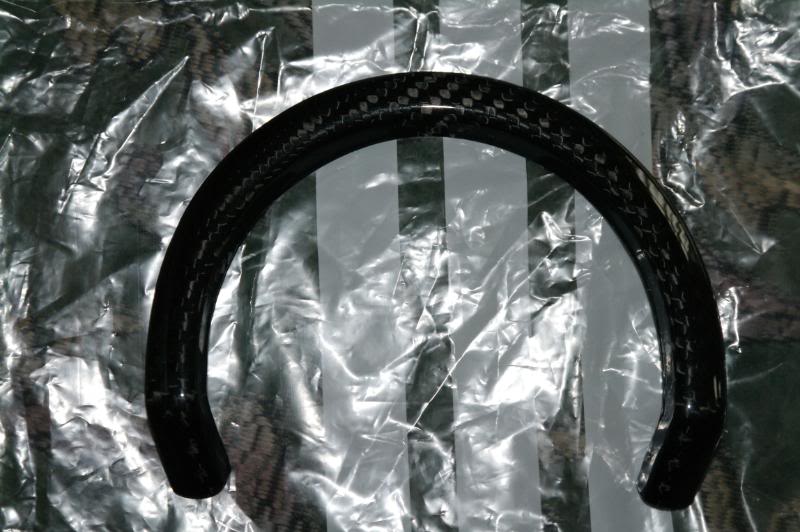

Streamline Carbon exhaust surround;

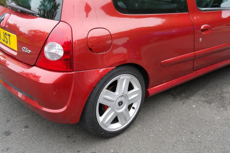

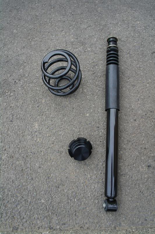

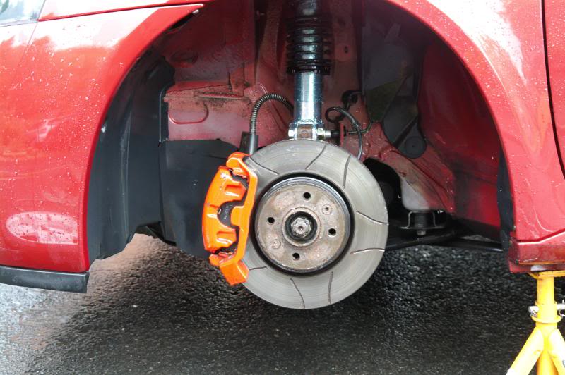

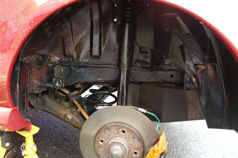

Well fitted what turned out to be the strangest coilovers have had the misfortune of fitting. Seem to be working ok on the car for road use but cant see them staying on the car for long. Ktec coilovers which are the spitting double of the TA Technix I fitted on my brothers Clio 1.2 (Matty1995 on here) except for the camber adjustment which is completely pointless.
When first fitted with the adjustment in the middle the tyres were hitting the strut so have lined it up visually so it appears near straight. Is in tomorrow for alignment at my mates garage once the new driveshaft is fitted.
Will put pics up of the lowered appearance tomorrow as want to clean the car first. Some pics of todays work;

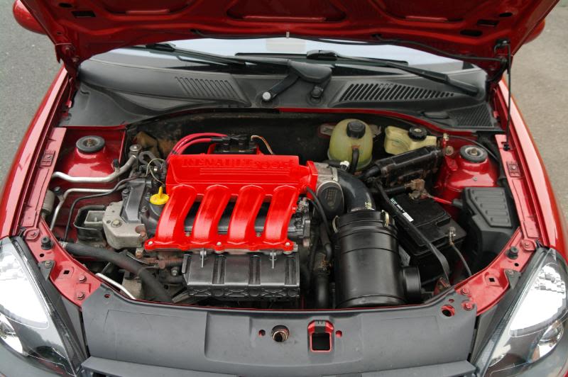

Arches cleaned and coilovers fitted - this was mid clean;

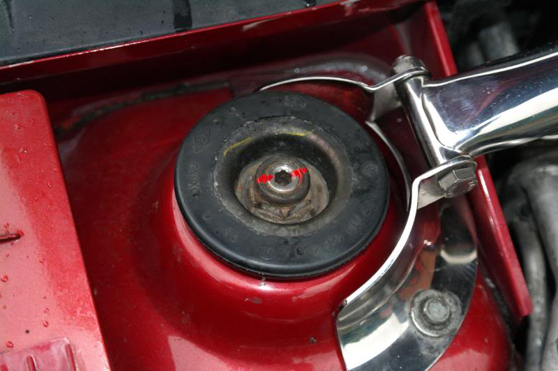

Paint marked top mounts to monitor;
Ktec strut brace fitted;

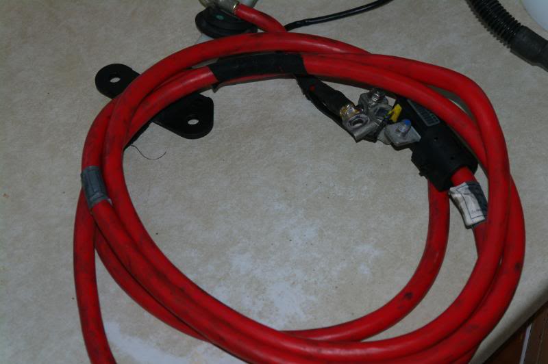

7 Series BMW power cable with exploding link;

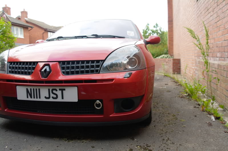

Cheers matey - the traditional N111 JST numberplate will be going shortly as well as got my R500BRT plate to fit on once I have sold the ST

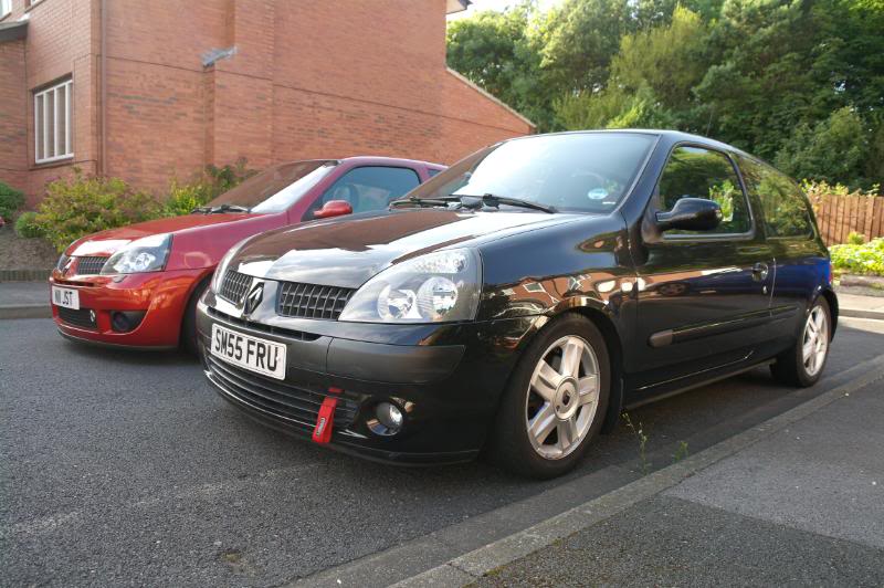

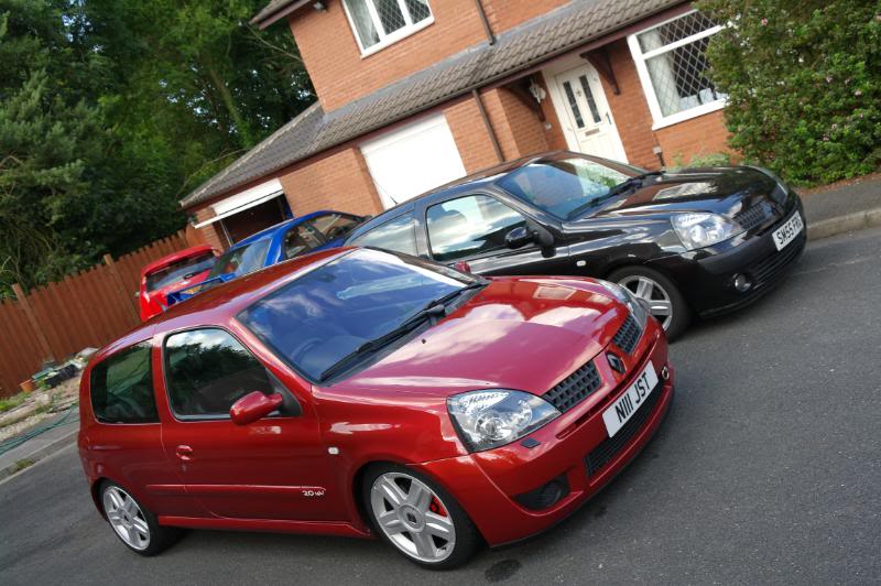

Pictured here with my brothers Clio - Matty1995 off here;

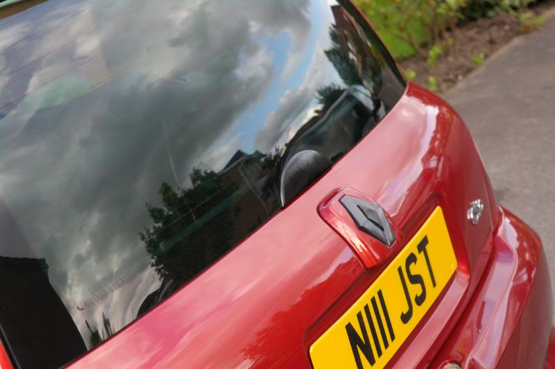

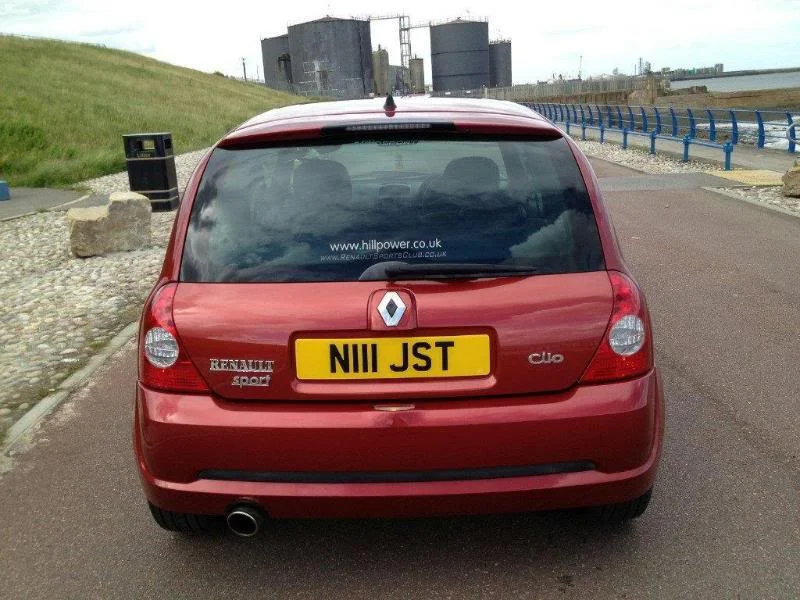

Today I got rid of the useless rear wiper;
And alongside the former beast of my ST;

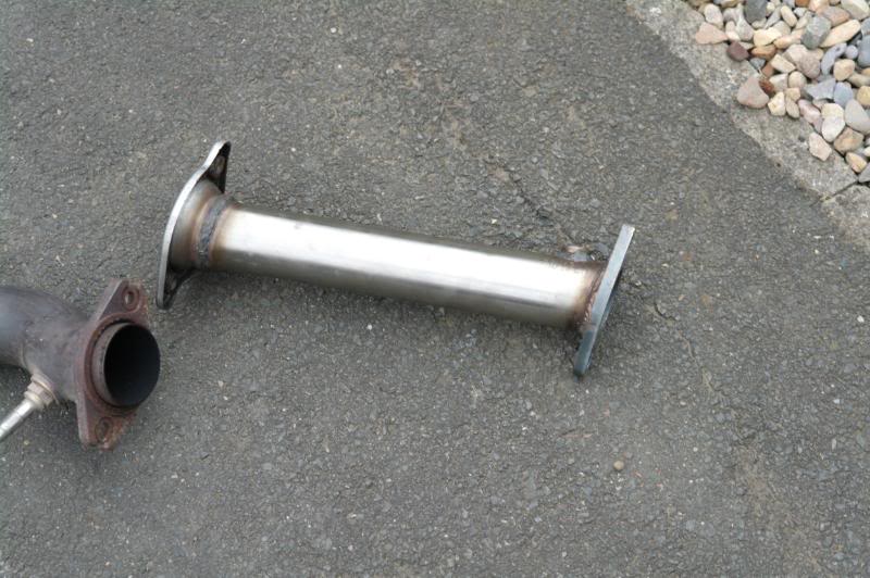

Exhaust has been rehung as a temp fix - going for the Ktec decat pipe so will get this ordered up along with new centre and front clamp/hangers.

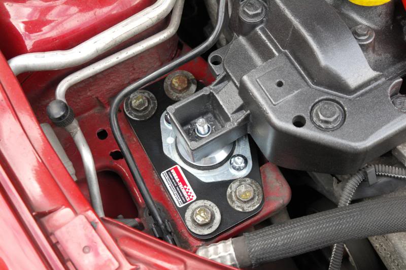

The knocking noise has been traced to the RH engine mount being more or less completely shot so ordered the Vibratechnics mount instead. Proved it to be this mount by simply inserting a steel section and road testing the car and it removed the noise completely

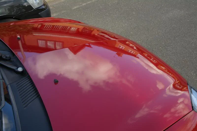

Cheers for the comments - I wasnt sold on the colour initially as it hadnt been cleaned very well by the garage where it was bought.
I have snowfoamed it, lime primed, clay barred, 2 bucket wash and then a full polish session by hand then 2 layers of wax and 1 of glaze to get a lovely shine again. Piers and P0RTY used to have pics on the forum of it looking very glossy so will be staying like that in my ownership. Will be buying a machine polisher between me and my brother so will be even better shortly.

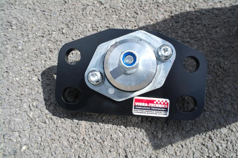

Today I have managed to get the Vibratechnics upper engine mount fitted, was an easy enough job and allowed me to paint the upper mount as well;
Time for the test drive......
  182 Cup & DCi 172
Test drive showed the knock and rumble has now gone and car feels alot better than the day I bought it coming up to 3 weeks ago.

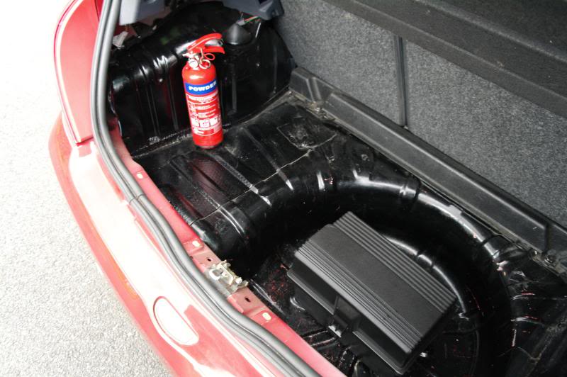

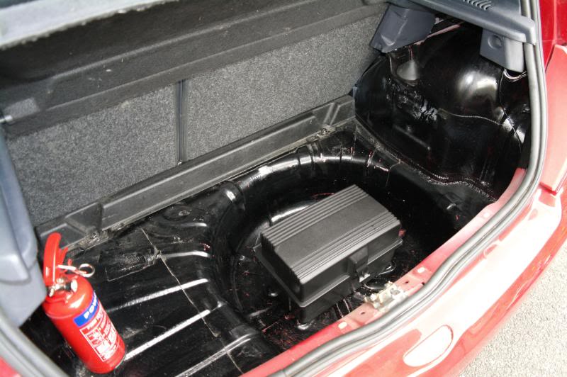

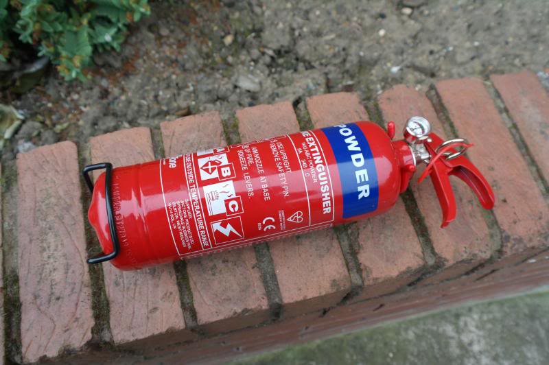

This afternoon I have fitted the battery box and fire extinguisher in the boot - the battery wont be ran into the boot straight away but nice to have everything ready for when I pull the interior out and route the cable in. Got the cable from a 7 series BMW but need to remove the exploding link and then can get the crimps sorted to connect this to the remote BMW 3 series positive terminal.
Ignore the current boot paintjob - this was like this when I bought the car but has been scratched alot - will be repainting the boot interior when everything else is in place

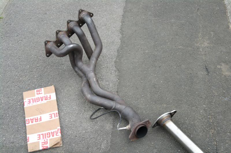

Well update for parts;
Bought/reserved the following;
- 182 manifold and decat/link pipe
- Pair of Sabelt harnesses
- New exhaust hangers
- New exhaust gaskets
Also replaced the aftermarket Pioneer headunit with a standard 172 item and also ordered the cable for the aux cable (3.5mm jack)

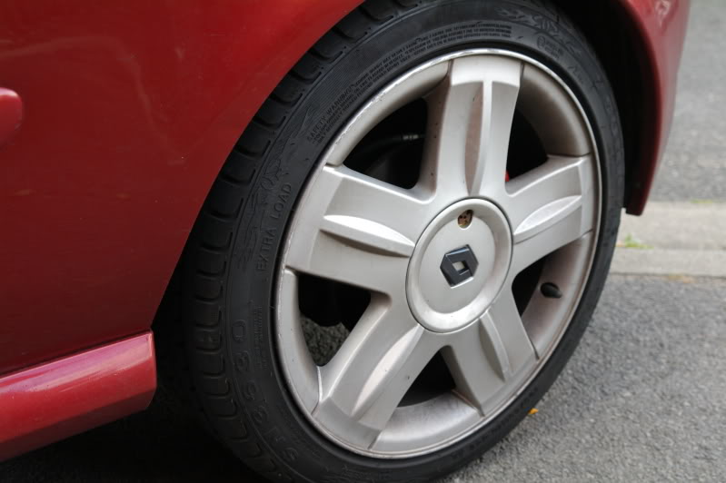

Offset is 38.5 and looks spot on compared to the 172 rims;
Cup;
172 rim;
