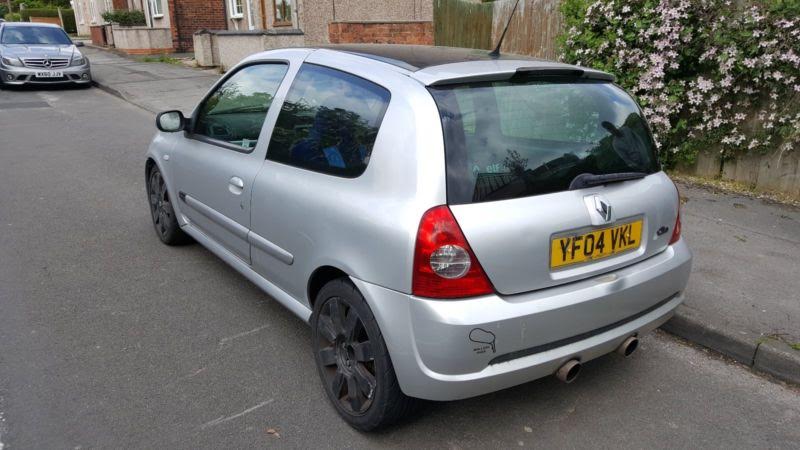

Have just acquired a 182, for track day purposes. It seems pretty well sorted for track, having:
A Scorpion RS192 decat system
Cobra seats on fully adjustable runners
5 point harnesses
Smaller OMP steering wheel
eibach rear suspension (to be investigated further)
Fully stripped out
Front and rear strut braces
Got some new yellowstuff pads and Nankang NS2R track rubber.
I'm curious as to remap options, as despite having this type of exhaust - I don't believe this to have been fettled with. Are there really much gains to be had with this NA engine?
And also curious as to roll cage options, and to what gains these would have over the strut braces it has fitted at the cost of extra weight?
First track day likely to be at Castle Combe in September if not squeezing in somewhere this month!
Thanks for any info offered!!
