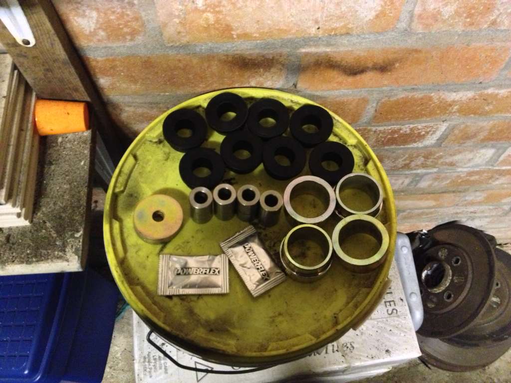

For those that didnt know powerflex have released a new improved wishbone bush kit . Instead of purple the bushes a black which is the harder compound from them . Also they told me they require no welding . These in most places are 90+ but theres a company on ebay selling them for £66 posted so a bit of a saving there ! Im only replacing them as mine were badly perished and was refreshing the front end anyways ! Heres a pic

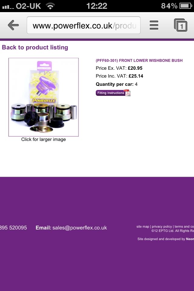

Hi mate once im on my laptop il link you ! In the pic they look like the old ones but there actually the new ones

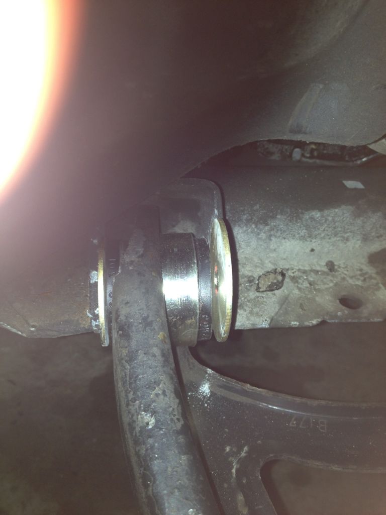

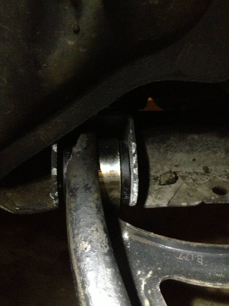

Hey guys small update with these bushes ! Basically they do not fit some how! They fit into the wishbones fine no problem there. The problem is fitting them back onto the car . They supply you with these washers that go either side of the bush and with these in place there is not enough room for the wishbone to slot into its place on the subframe . Im currently emailing powerflex to see whats the problem i have spoken to another member on here thats had the same problem . Il post a pic of what i mean is wrong
But there two wide with the washers in place fit !
Ive asked powerflex to see if i can not use the washers.

100% right ones says on box also . Everything fits apart from the washers
Powerflex want pics and a few measurements to determine the problem but they have no issues aparantly

Hey mate they have told me the washer must be used ! Ive sent them pics today of the problem also a load of measurements so they can try figure it out . I know a few other members on here have the same problem as mine . Il see what they say 2moro mate and let you know !

Found my problem theres a 1 mm diffrence on each side so powerflex have told me to try and press the rubber bushes further into the metal collar .

They have told me i need to press the rubber bushes some more ive done this . They were flush all the way in the first place ive emailed them again see what they say
  Cup In bits
Looks like you need less than 1mm to fit, why don't you just open the pick up out with bar/hammer, its only pressed sheet metal. The bolt will pull it back in when fitted.
