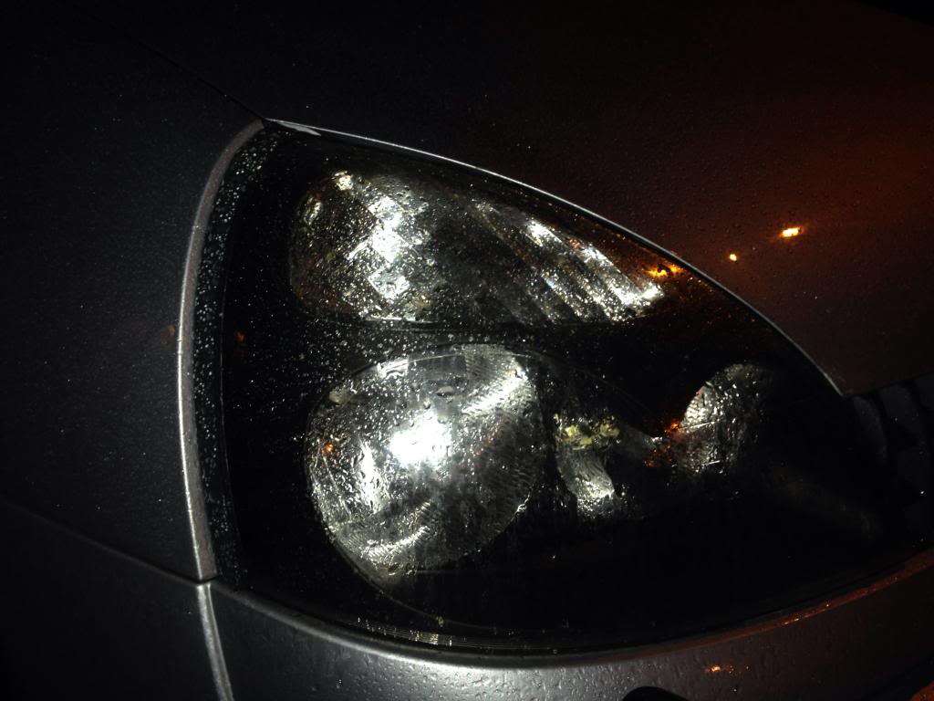

My 172 lights have hid bulbs but are not proper xenons but has headlamp washers.
the Wierd thing is that the lights auto level works
does anyone know what lights I have and what model they are from?

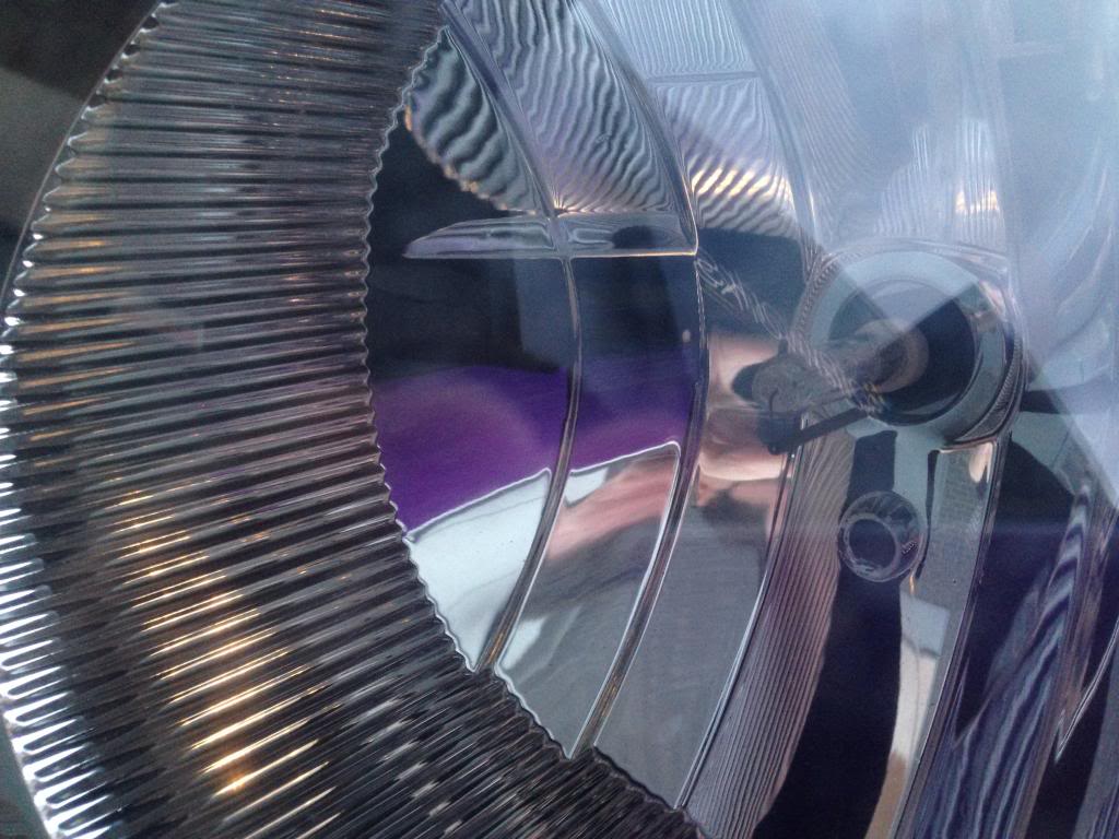

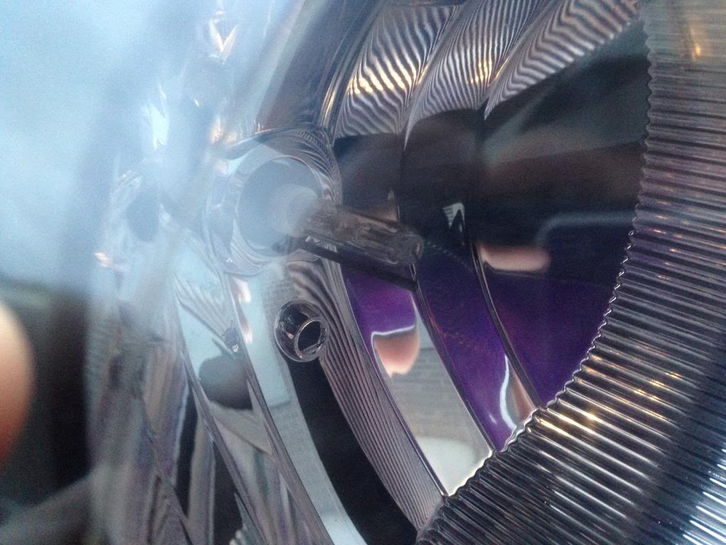

as u can see my lights are bright light hid
and has these bulbs
  Cup In bits
No you have the full Xenon works including the level sensor on your rear axle and the auto adjusters on the back of the headlights but someone has replaced just the headlights themselves for poverty spec.
Fit xenon headlights and you'll be all the bash.
Nope it will just plug in, like said above you can see your front bumpers have the headlight washers fitted, sounds like you have the auto levelling fitted.
And for some reason someone has removed the xenons and replaced with halogen units, probably because they are much cheaper.
You just need full projector units and they will plug in.

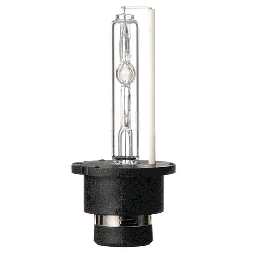

You will probably need new bulbs. The reflector lenses you have just now take H7 bulbs in the dipped beam but the projector lenses take D2S bulbs.

well if thats picture of the bulb currently in your head lights then they d2s xenon bulbs and will fit in the projector headlamp, god knows how its fitted in the reflector lamp
  Clio 172
These are my bulbs in my reflector headlamps.
it as if everything works as a xenon without the projector part

You current have a H7 Hid kit as in Xenon bulb in a reflector unit, this isnt good as the beam scatters all over the road.
You need, a pair of full project units with a d2s bulb which should already be in the unit. When you plug these projector units in you will have what it should have been like if someone hadn't taken them off the car.
