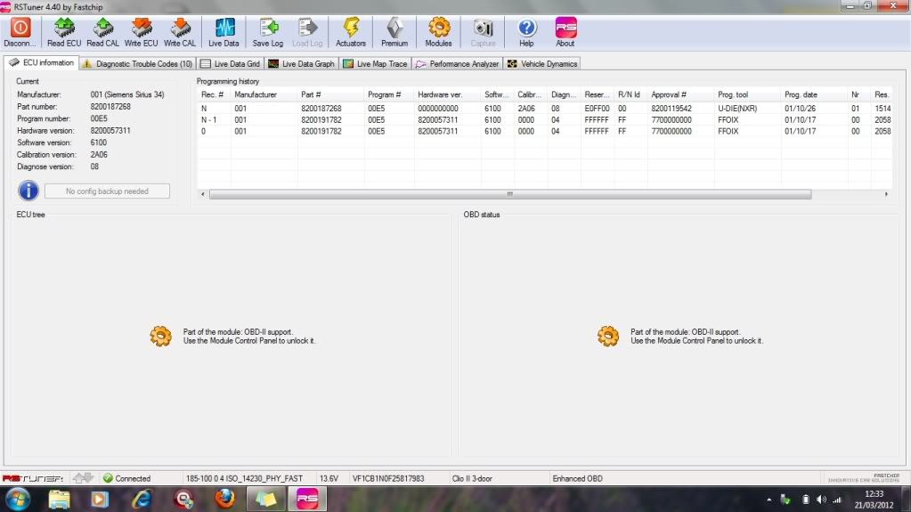

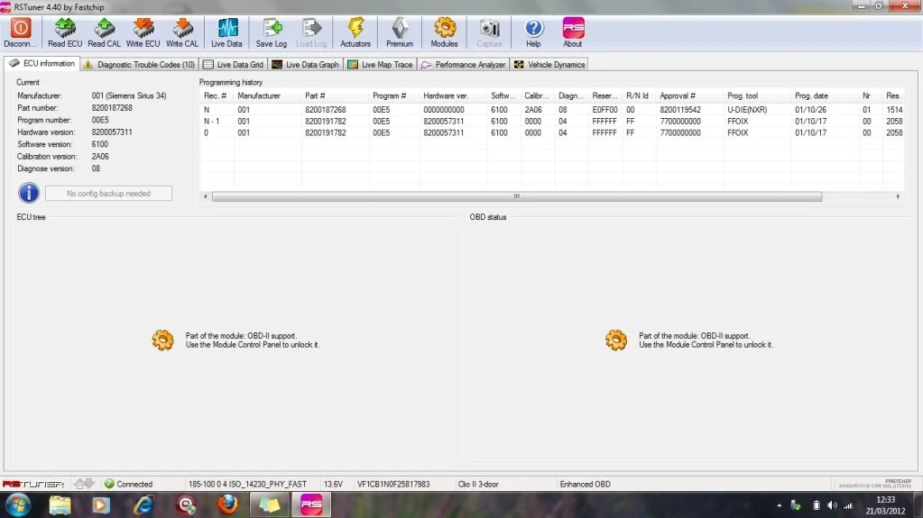

hi mate i do have a decat ;)
just waiting on an unlock code from henk. any ideas how long this takes? he emailed me straight back this morning within 15 mins, ordered my unlock code and now still waiting to hear from him.... fyi mate....
do you know what i need, is it possible to download off website?
also dont worry about the 10 DTC's, its because i have an Aftermarket steering wheel and no carbon cannister lol

  182
I may be wrong but you have a 182? so why is it running 172 software and cal??
I thought all 182s run 8000 software and 7802 cal before mapping? then the upgrade OEM software and map brings it to 8200 7804!:S
6100 2A06 is what the 172s run normally
Dan
  172 track thingy
no hes bought a 172 if i read that reg plate correctly??
