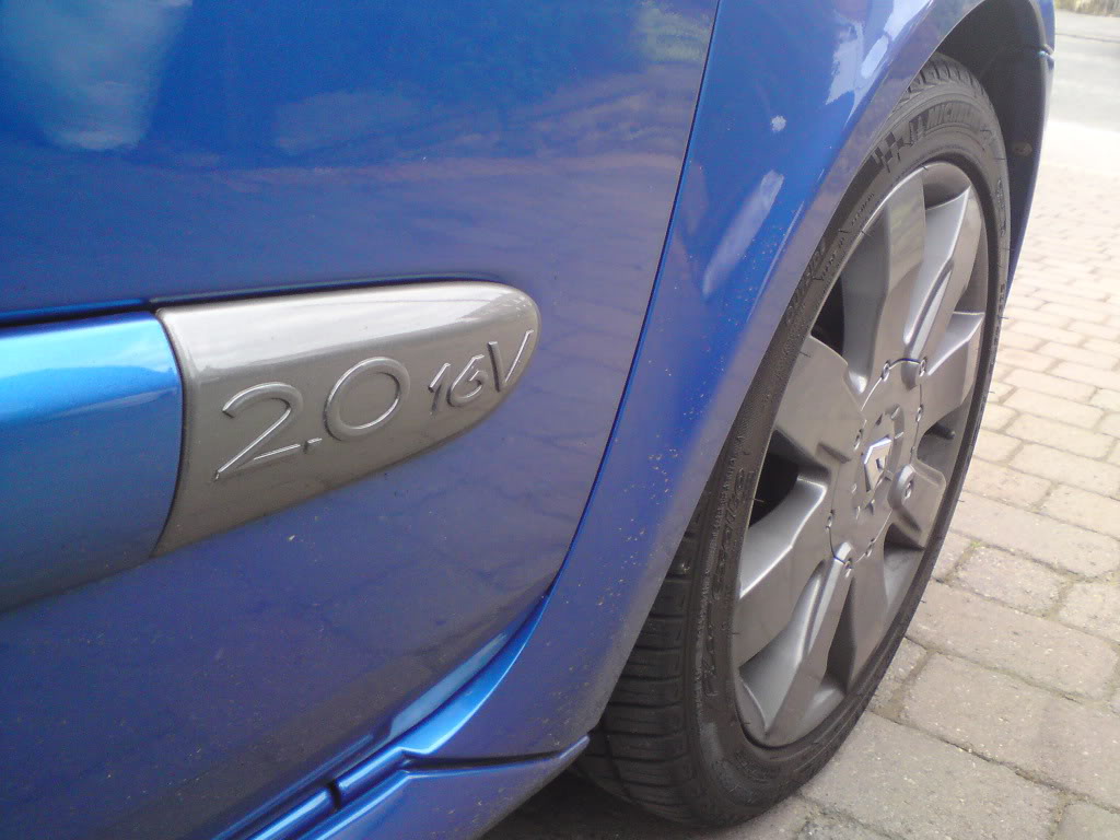

Im wanting to do my bullets. Just painting the lettering to match the car.
Do you just paint onto the silver lettering or sand em down first or what!? Unsure :S

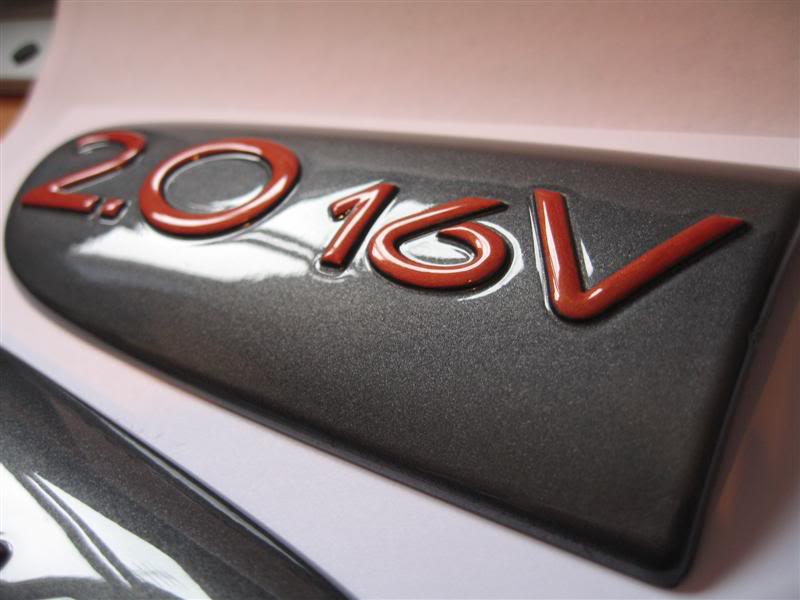

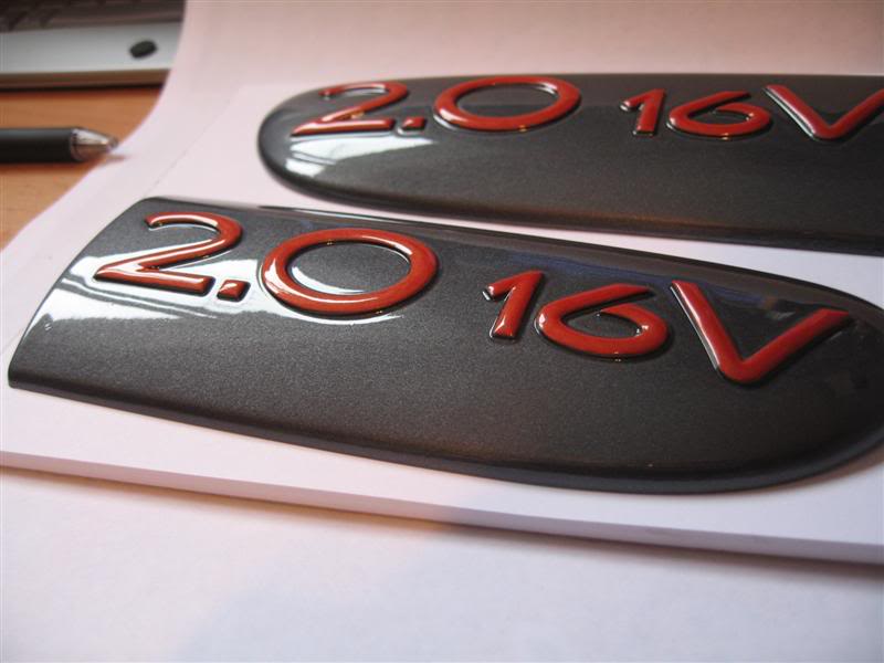

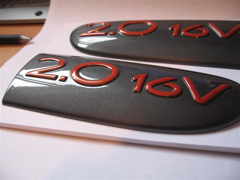

Degrease and sand down the badges.
Primer
sand 1200
Primer
Sand 1200
base coat
sand 1200
base coat
hand paint lettering
laquer
laquer
cure for 48 hours
allow to dry fully between each stage.
result:

result:
[/quote]
WoW they look absolutely fantastic,im gonna try mine if they come out 1/2 as good as ^^ them ^^ i'll be chuffed to bits..awesome work
sanding down shouldnt take ages, you're only scoring the surface... not removing any layers.
