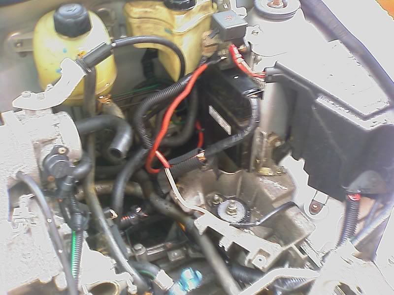

the ph1 airbox is too long to fit onto a straight pipe no matter how short it is... I tried this before and then used a maxogen, I will find the pic at home and post. I then opted for a 45 degree bend with a straight maxogen as below with nice air feed direct from wheel arche:
