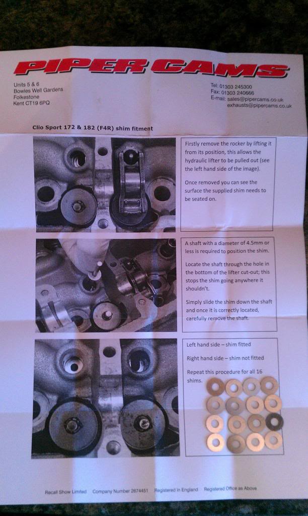

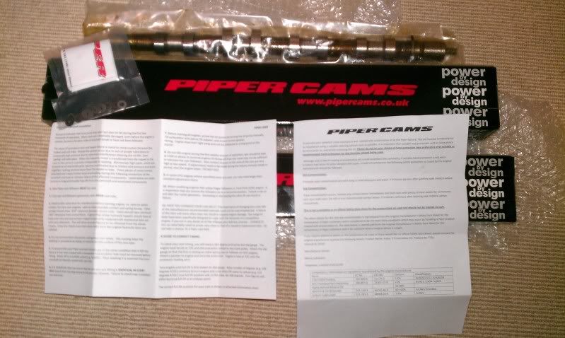

Just for info for those interested.
What you get...2 x boxed and oiled reprofiled cams, instructions, data sheet, COSHH sheet (for the lubrication present), leaflets, shim kit.
The shim kit also comes with instructions and 16 x 12mm OD, 5mm ID, t=0.5mm shims.

Ah so thats how those shims go.
You don't happen to have a caliper handy to measure the thickness of the shims? ;)
  Ph1
Ooops, totally missed it :eek: lol
Hope to re-fit my old Pipers sometime this year so will have a hunt in the washer box and see if there is anything similar sized. Not that they rattled anyway but might help preserve wear?
Ph1 Tom
Maybe worth giving Piper a call and say you had them fitted but removed them due to issues not having the shims and would they honour you with a shim kit?
