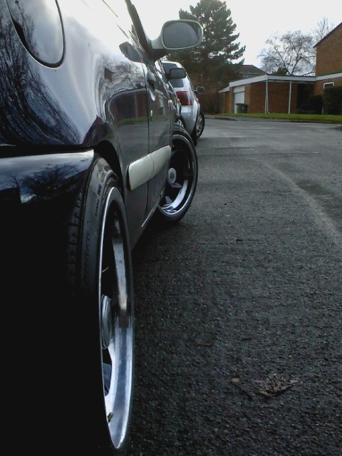

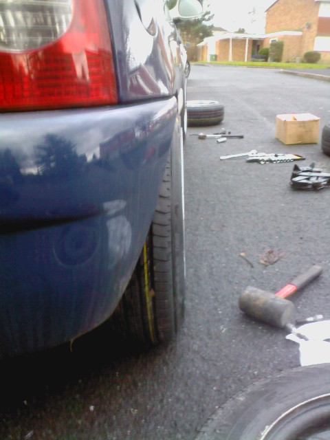

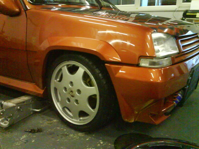

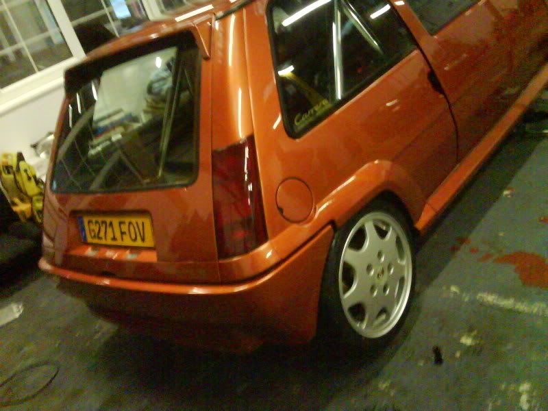

Porsche Wheels Are on!
  Petrol Blue 182.
But a mere teaser for you, side on pics tomorrow ;)

did you use the vag adaptors? i aborted porker rims last year as the rear adaptors would've needed machining and it wasn't worth it as the wheels didn't suit anyway

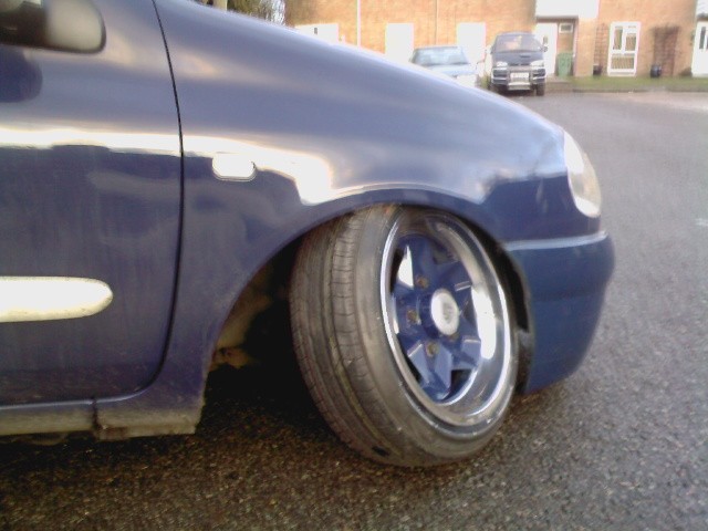

not strictly... but its hardly something dangerous like only having one headlight etc.
my cabriolet has 8x15's that poke out the sides, and never had any trouble from the law put it that way
yeah i had to have them bored out
Is that legal?
and it is now, camber is full negative, top of the tire is just under the arch (your not allowed to have any tread showing iirc) so side walls poke out

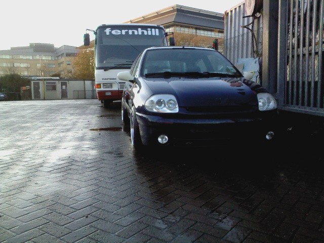

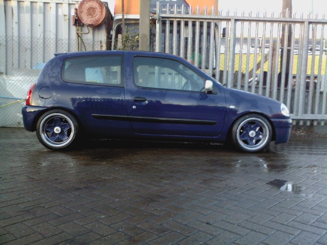

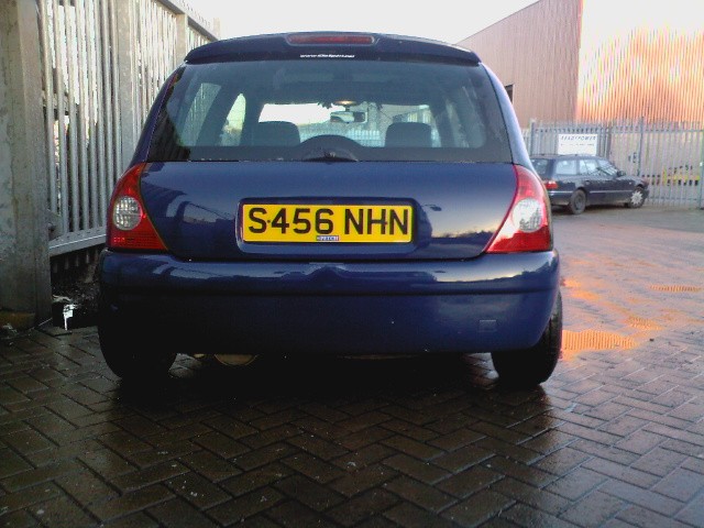

TIME HAS COME! AS PROMISED!
What do you think then?

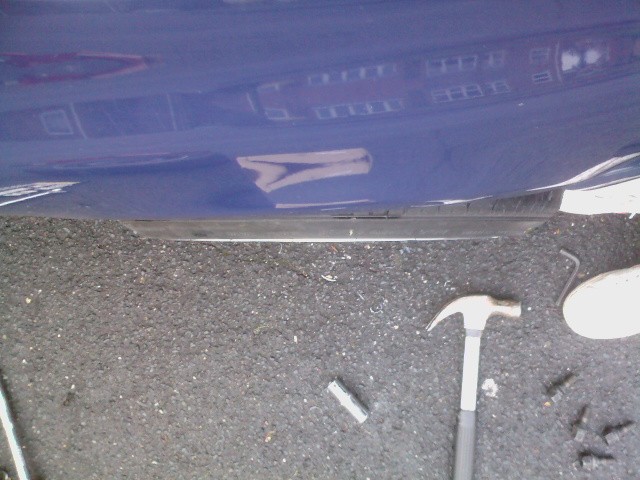

And yesterdays miss hap of the wheel falling off :|
sidetrips are back to black, but im not sure wether to keep the wing mirrors white or not?

Looks nice! But how can it be so low? is this 9j?
7J mate, wheels rub when i bounce hard over a bump of something
Mintness in the extreme!!!
Sh*ts on Rage's old car IMO!
The last pic - WTFcakes!?!
did it fall off when it was stood still, or in motion!
Basically, as the adapters are so big, they would of hit on the brake cradle, so i put spacers behind, which made the bolts smaller, and hence the wheel falling off lol, i was on full lock in reverse, blocked the road, fitted 5mm spacers in the end as 10mm was too big, all hunky dory now :)

Longer bolts + 10mm spacers = Win
They look soooo good though. Please sand your bonnet back and let it rust!
wheels are cool but needs to be lower imo. not sure on the white mirror caps and black mouldings. Need to go with one or the other.
Also needs a proper detail!
