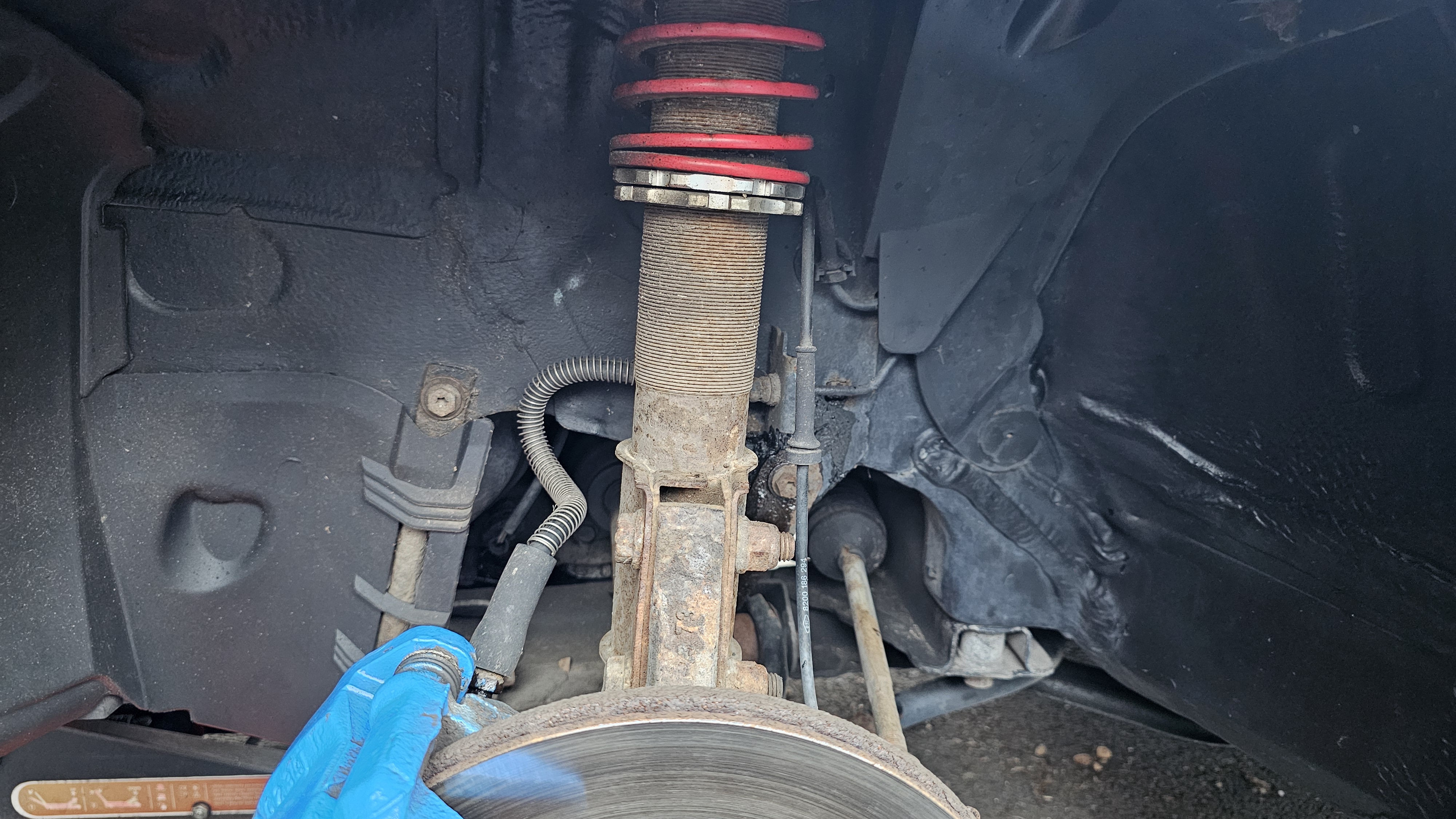

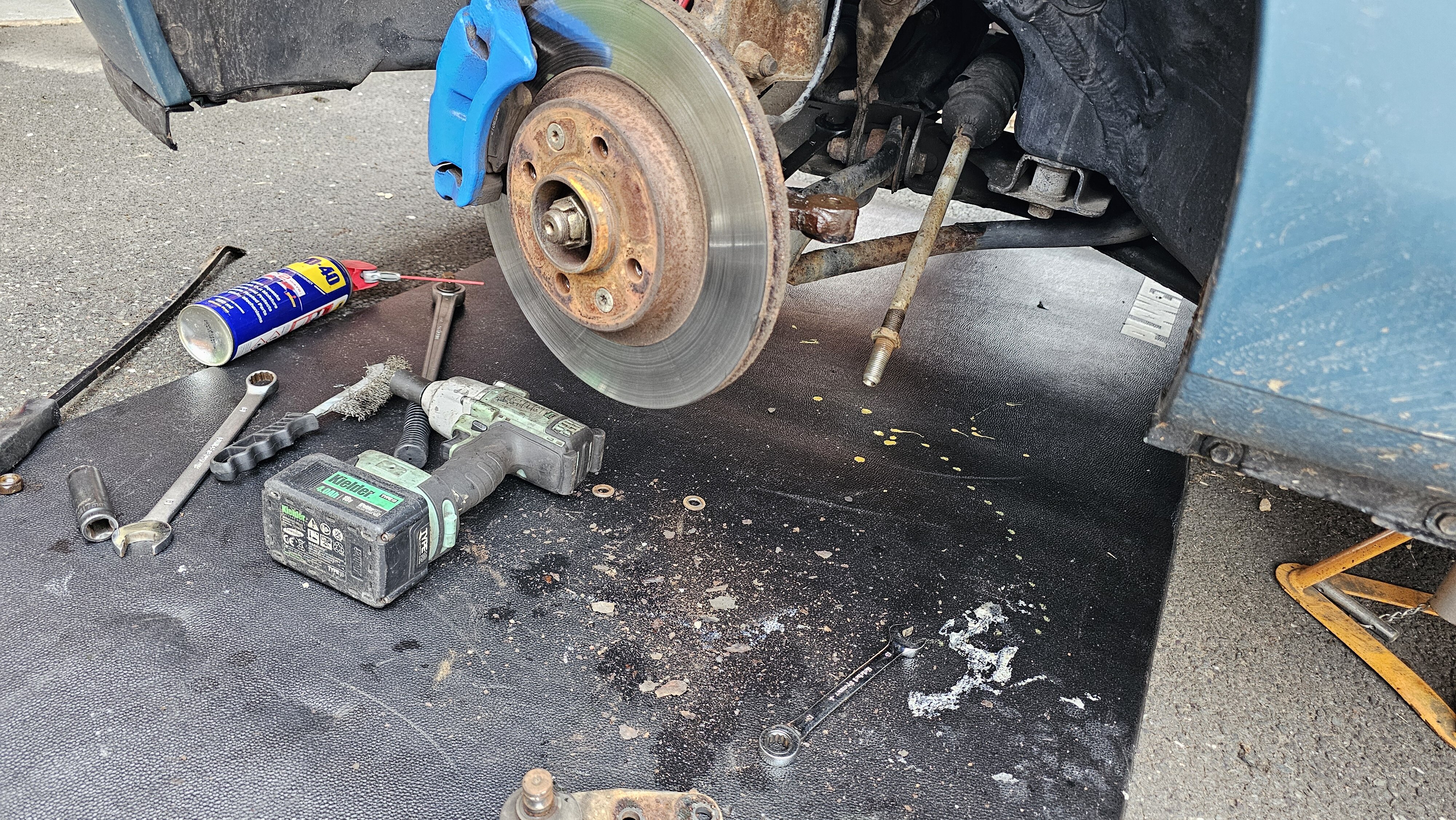

To continue the theme the next little upgrade on the cards was brakes, more specifically, the flexis, which i believe to be the originals,

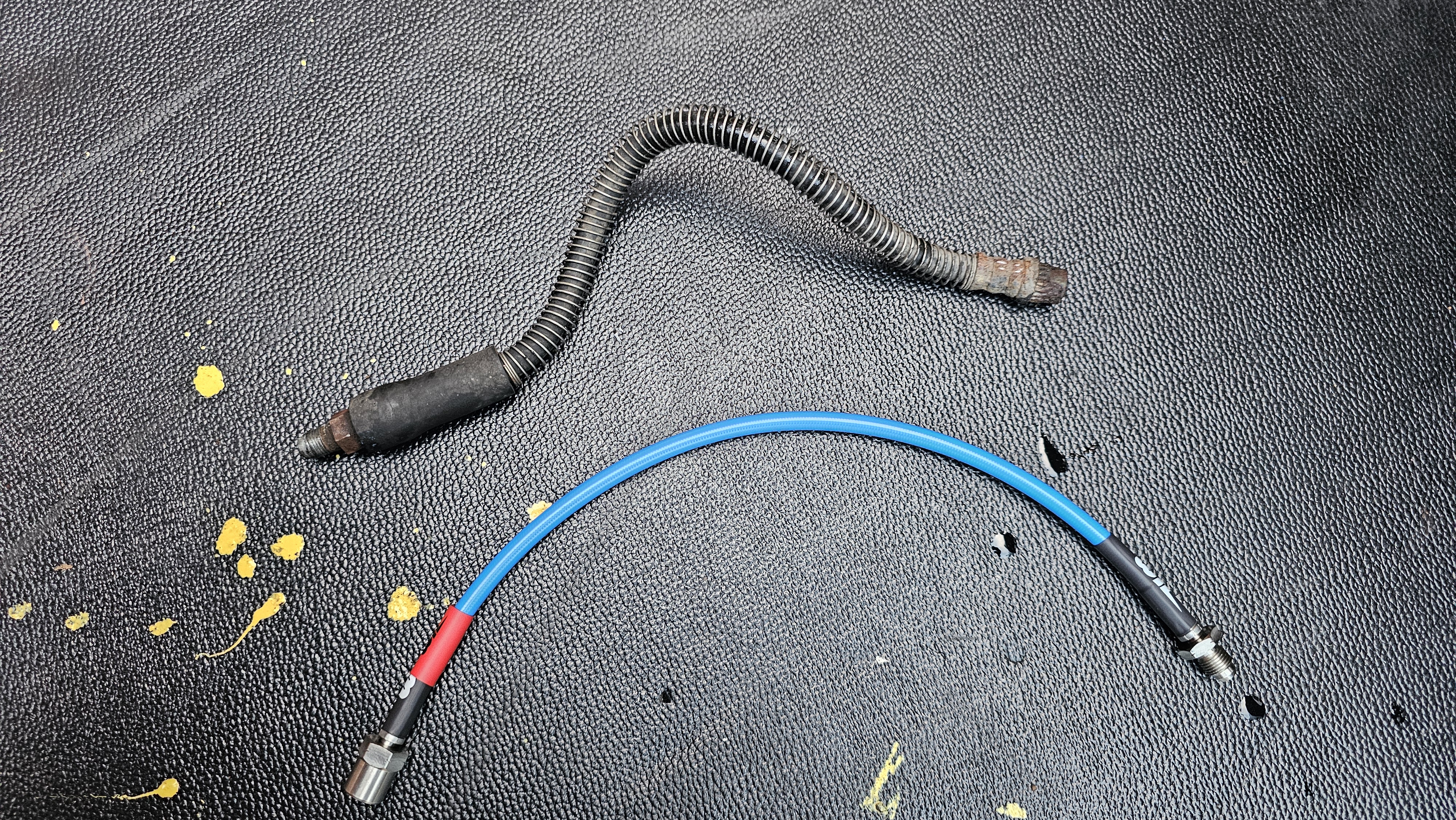

Decided to make an upgrade and purchased some braided lines to give a little more feel through the pedal and improve braking performance,
Old vs new

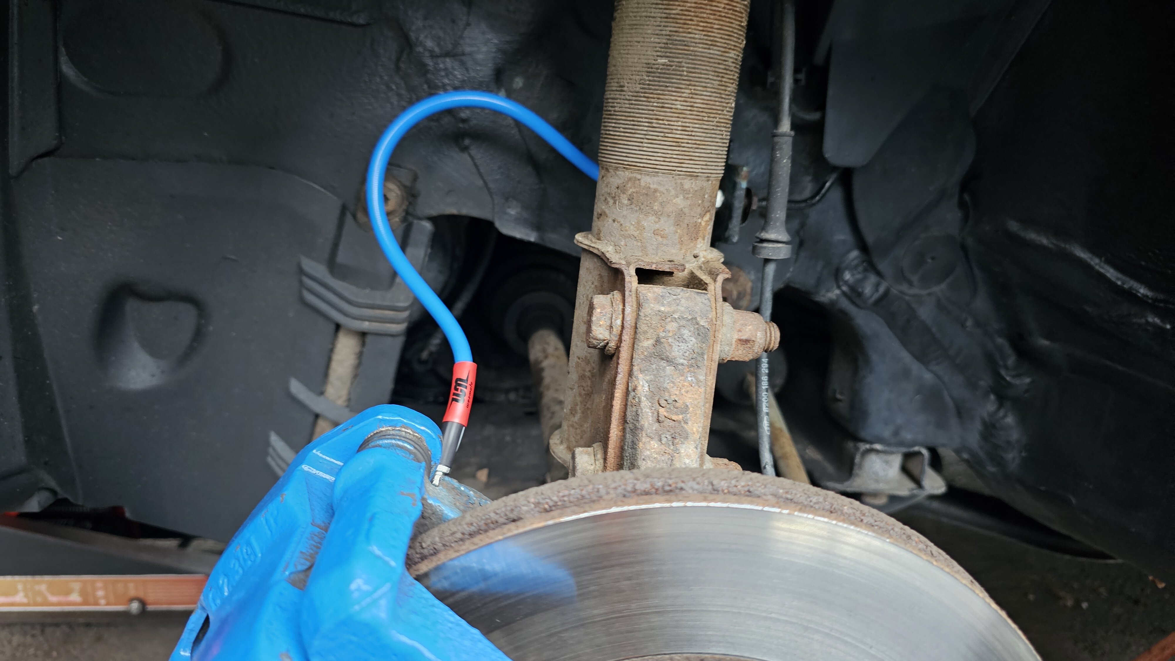

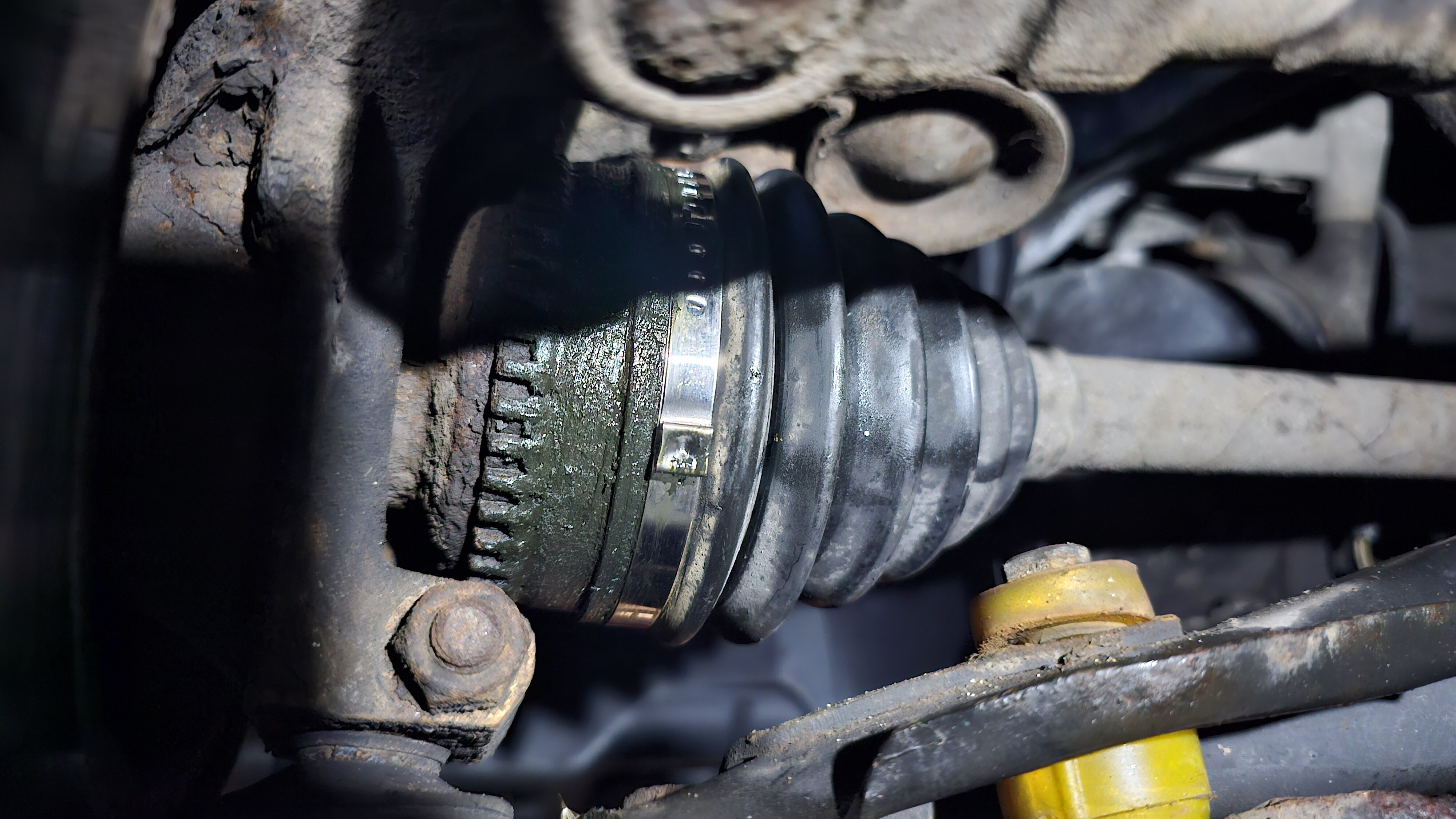

Fitted and bled. I also checked to make sure they aren't rubbing the chassis on full lock and pleased to report all is well. Whilst I was in the area, I'd noticed a cv boot clip and come off so addressed this with a spare clip I had knocking about (handy being a bit of a horder)
Grease splatter was minimal so I assume the old clip had come off recently (grease was cleaned off after photo was taken)

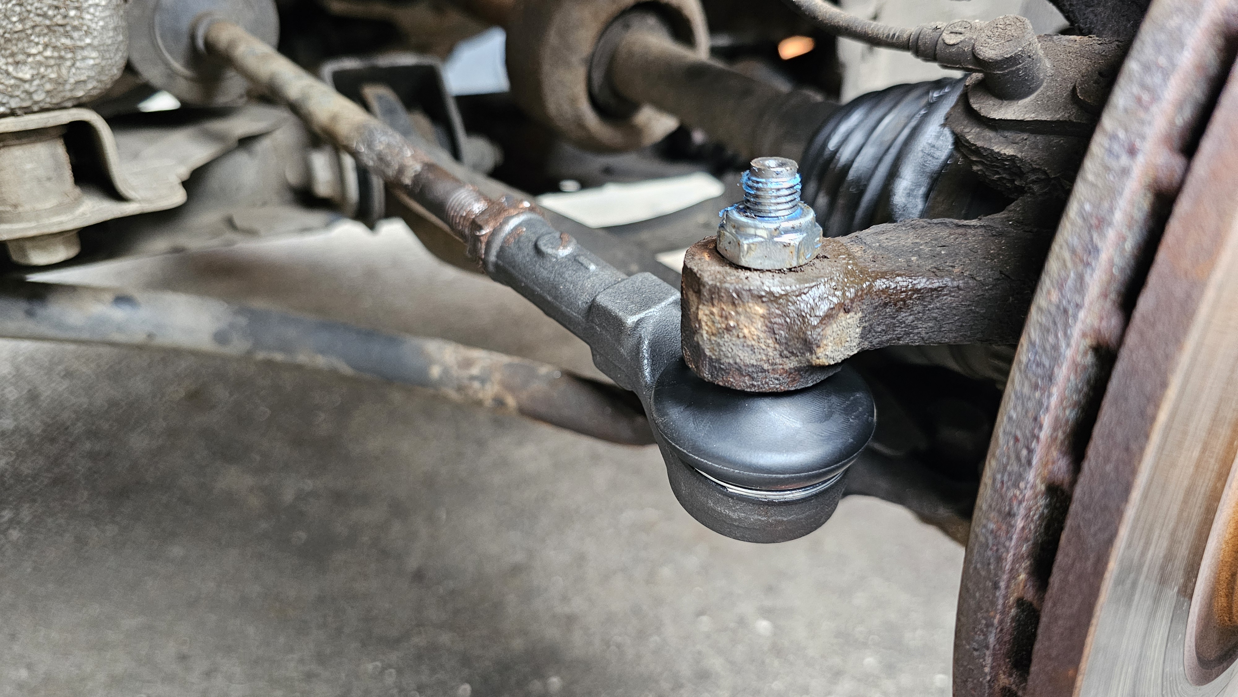

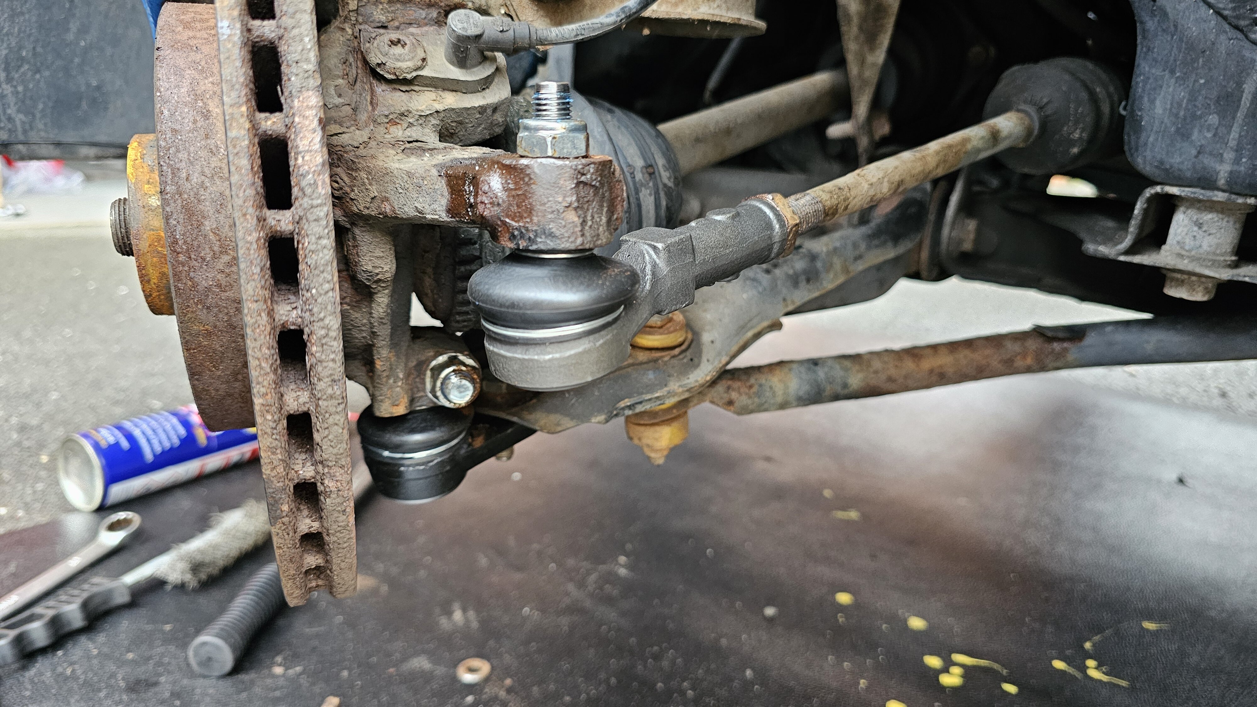

Handling has felt a little off recently, had a quick shake of the front wheels and the nearside lower ball joint has a bit of play so new lower joints are on the to do list. I have also noticed the track rod end dust covers are quite perished so I'll chuck a pair of those on for good measure.
Post test drive results are positive with much sharper braking response so well worth the upgrade.
