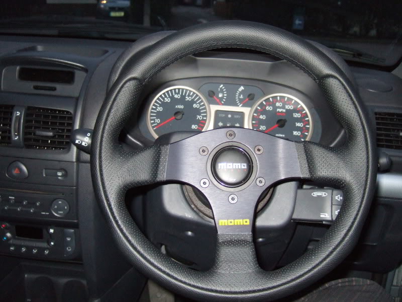

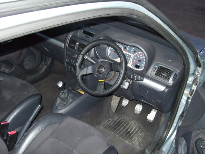

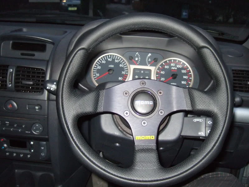

The PH2 wheels melt just as much and the thumb grips are prone to splitting. Renault just can not make decent steering wheels.
Your better going for a Aftermarket one (but you will loose the airbag)
Or find a company that can retrimm you PH1 one in leather so it last longer.
