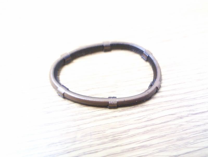

hmmm, that is sealed with some high temp silicone right? Odd as I removed the plenum when checked the plugs last spring and didn't get any noise even without repacking with silicone that area.
  ITB'd MK1
this seal
no silicon needed on it, just the rubber seal in the machined groove

yeah the seal is in it's place, but mine had some red silicone on it. you think it would be better to get rid of the red stuff and see how it goes?
  ITB'd MK1
the silicon is probably causing more problems really. Clean it all up, and while you're there make sure the upper to lower manifold sealing faces are clean and the gasket is flat

yes it is blanked, but there's a gasket on the plenum, that's what danny was about.
anyway, just got out and took out the plenum again, got rid of the silicone and put it back together. of course it's still the same... :mad:
  Ph1
Yeah but that rubber seal show is the rocker breather gasket which 182's dont have?
your over gasket is between plenum and inlet. You could replace that? Roughly about 8 quid iirc
