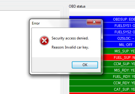

Im just using a RS Tuner on a phase 2 172
When i come to read the rst file so i can make a backup of how it is now it comes up saying this
Any idea what this is? faulty key?
RSTuning
  R35 GTR
Is it unlocked to your car? If not thats why. Email henk the unlock request code..
RSTuning
  R35 GTR
It could be tuned already and locked but Henk will be able to give you a better idea.
