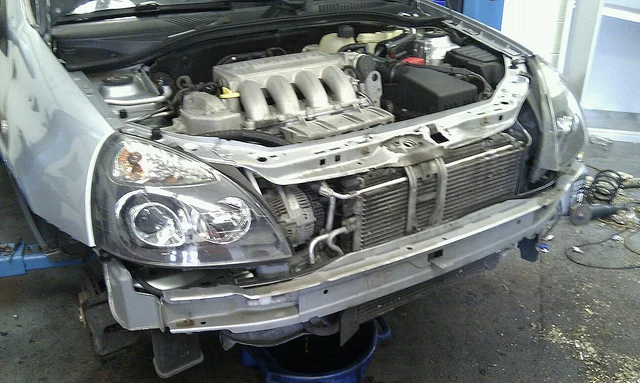

The cambelt needed doing so it was booked straight in at BTM.
-Cambelt+dephaser - £650
289332_10150246237701439_729556438_7461831_1348790_o by sbridgey, on Flickr

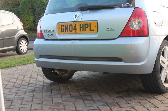

The exhaust then decided it wanted to fall off so a bought a new one for the immense sum of £30 + £45 fitting.

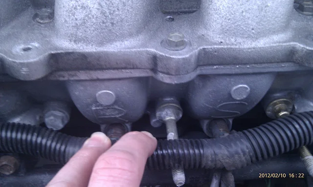

After my track day i checked the car over to find that i had RS stamped inlets which is a bonus!
RS stamped inlets by sbridgey, on Flickr

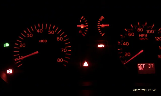

Currently the car has a minor issue, with the dash deciding it wanted to rival Blackpool illuminations every so often.
Error by sbridgey, on Flickr
I think it is a dirty ABS sensor as it hasn't been washed since december.

I picked up yet another standard Renault exhaust from Harpham yesterday so dont think it will be long before I have another stainless one fitted.

Seriously you get through exhausts very quickly.
Brakes are incredible now, i locked up momentarily coming off the motorway whilst doing 50mph.
Not my fault the standard Renault ones are crap, still this one was cheap so still cheaper than something like a KTEC Stealth.

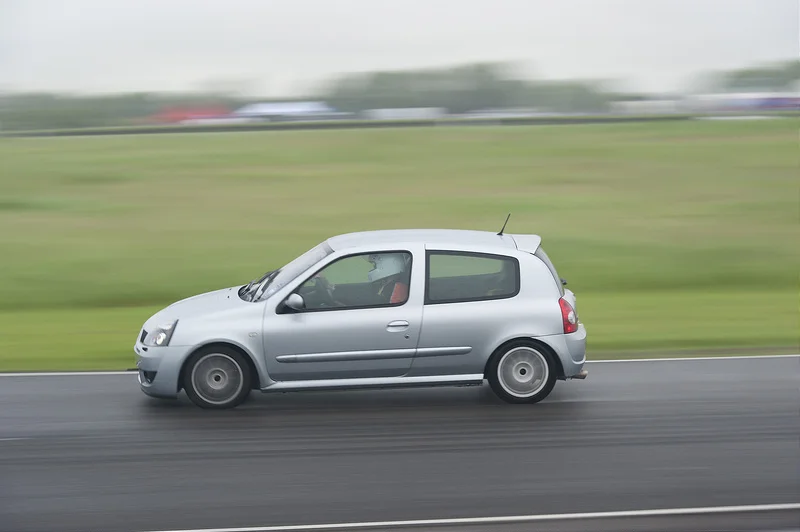

Did a trackday with them
_DSC8091 copy by sbridgey, on Flickr
Decided they were too thin and caused a load of roll and tyre squeal so purchased these.
s**t picture
Which allowed me to do this
Courtesy of Pete. for the picture (hope you dont mind).
Couple more pictures. Thanks to Dan Freeman.
Standard suspension with decent wheels/tyres is so so good, no idea why anyone would change it.

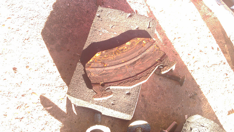

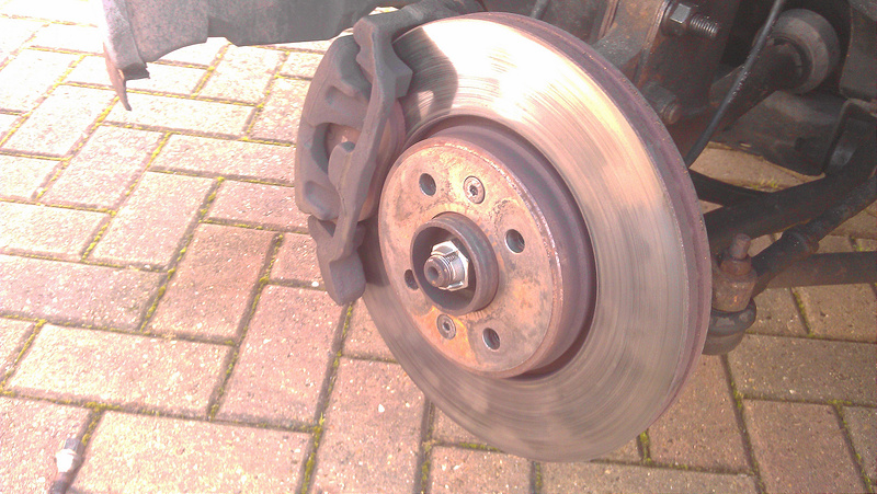

After setting a 15 flat the car developed a rather large judder under acceleration and then after one final run the rear brakes ran out of material.
IMAG0250 by sbridgey, on Flickr

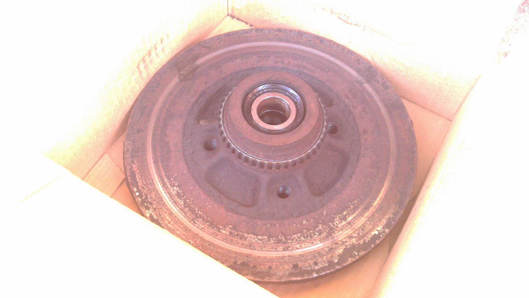

And the rear discs weren't much better.
IMAG0248 by sbridgey, on Flickr

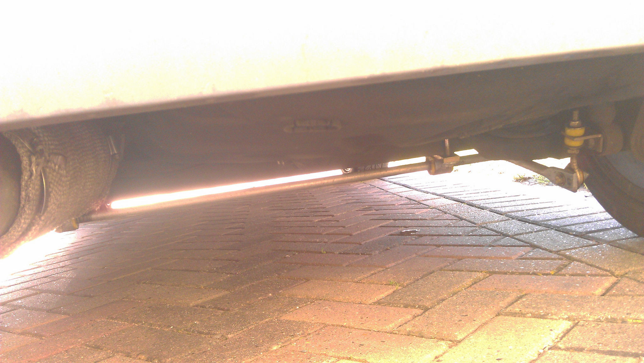

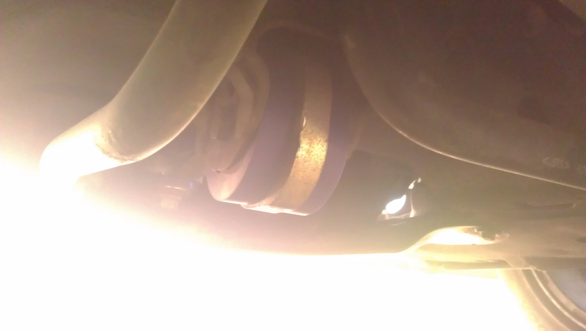

I had the juddering diagnosed by Mick@Diamond motors as a worn Dog Bone mount so it was time to go Polybushed.
IMAG0257 by sbridgey, on Flickr
I also got Mick to fit some camber bolts at the same time.
This resulted in -2.4 degrees of camber and I had the toe set to 5mins out either side.
IMAG0251 by sbridgey, on Flickr
The car now handles seriously well.

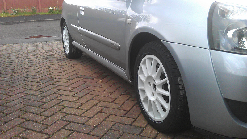

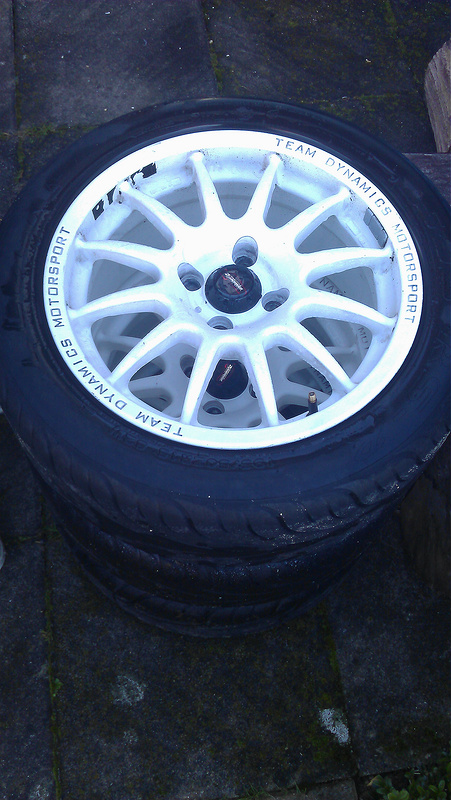

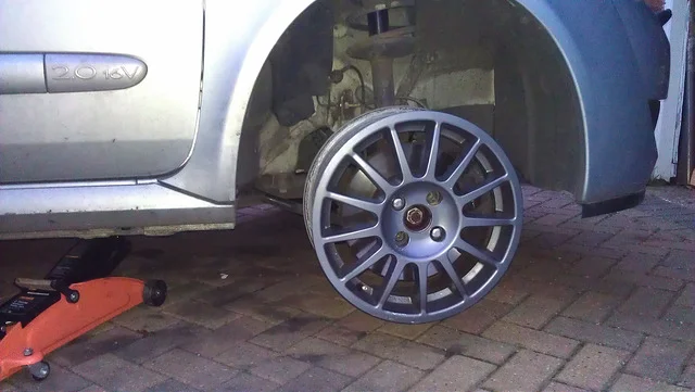

I also sourced a set of Team Dynamics pro race 1.2's with really good Federal RSR's on.
IMAG0263 by sbridgey, on Flickr
I put them on for the first time at Oulton park where I met up with James (BigAsh), Nick (Cr33do) and Mike (Meek_Racing).

Like the new wheels Si, they look spot on. Are you still running standard front pads and discs now or have you got the brembo HC front discs? I can't recommend the DS2500/3000 as I don't use them I have just bought another set of Pagid Blue pads, not cheap but awsome kit. In was mean't to be at Outlon two weeks ago but I've also got suspension and brake problems so until that's sorted I won't be back on track for a while.
sbridgey
  disco 4, 182, Meglio
Cheers, I quite like the wheels too.
I am running brembo HC's those are my second set and i got them replaced after Llandow, the pads i have are DS2500's, I am tempted by some carbon lorraine RC6 pads or maybe DS3000's not sure yet.
