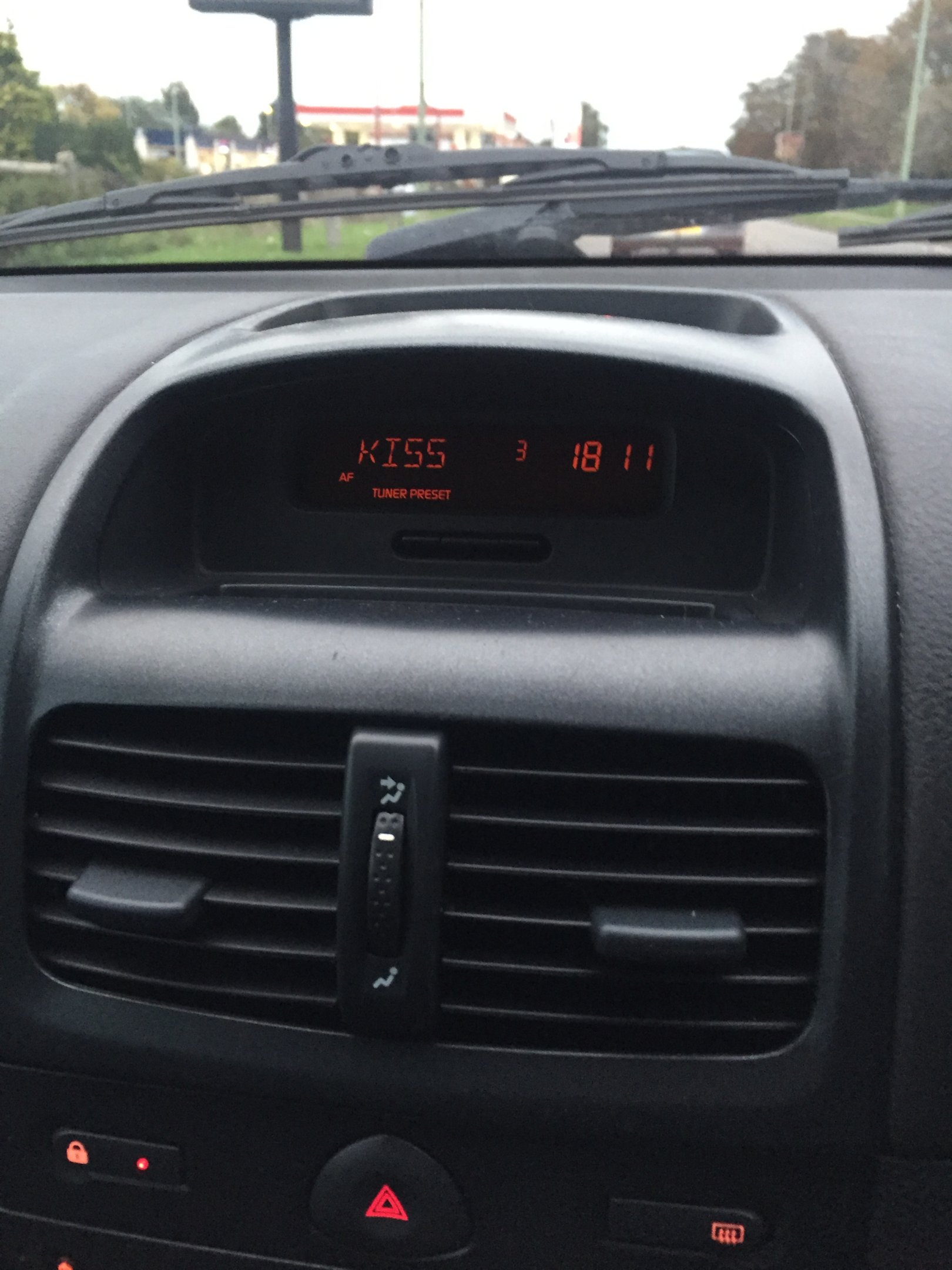

Should my car be showing the temperature below the clock? Assuming all Clios have this?
If the sensor in the wing mirror wasn’t working, I would think it would show a random temperature and possible fault code?

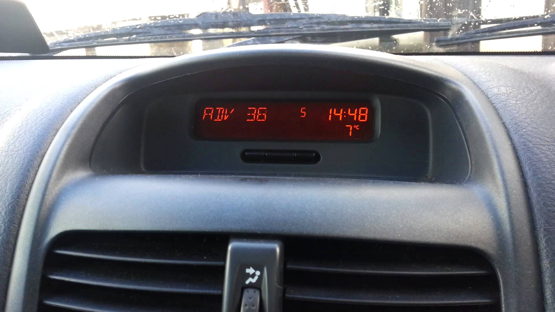

It should be showing the temperature below the time , like in this pic . Like da rok says , they usually show some wierd random temp if there's a problem . I very much doubt it'll throw a fault code up though.

Mine shows nothing whether the radio is off or on. If a fault doesn’t show up, can I assume the sensor has been disconnected through the wing mirror or something?
Do I dare venture into the wiring of these cars...

The time is always displayed, it’s just the temperature that’s missing.
Must be a break in the sensor wiring. Should be fun tracing that if it’s not disconnected!
