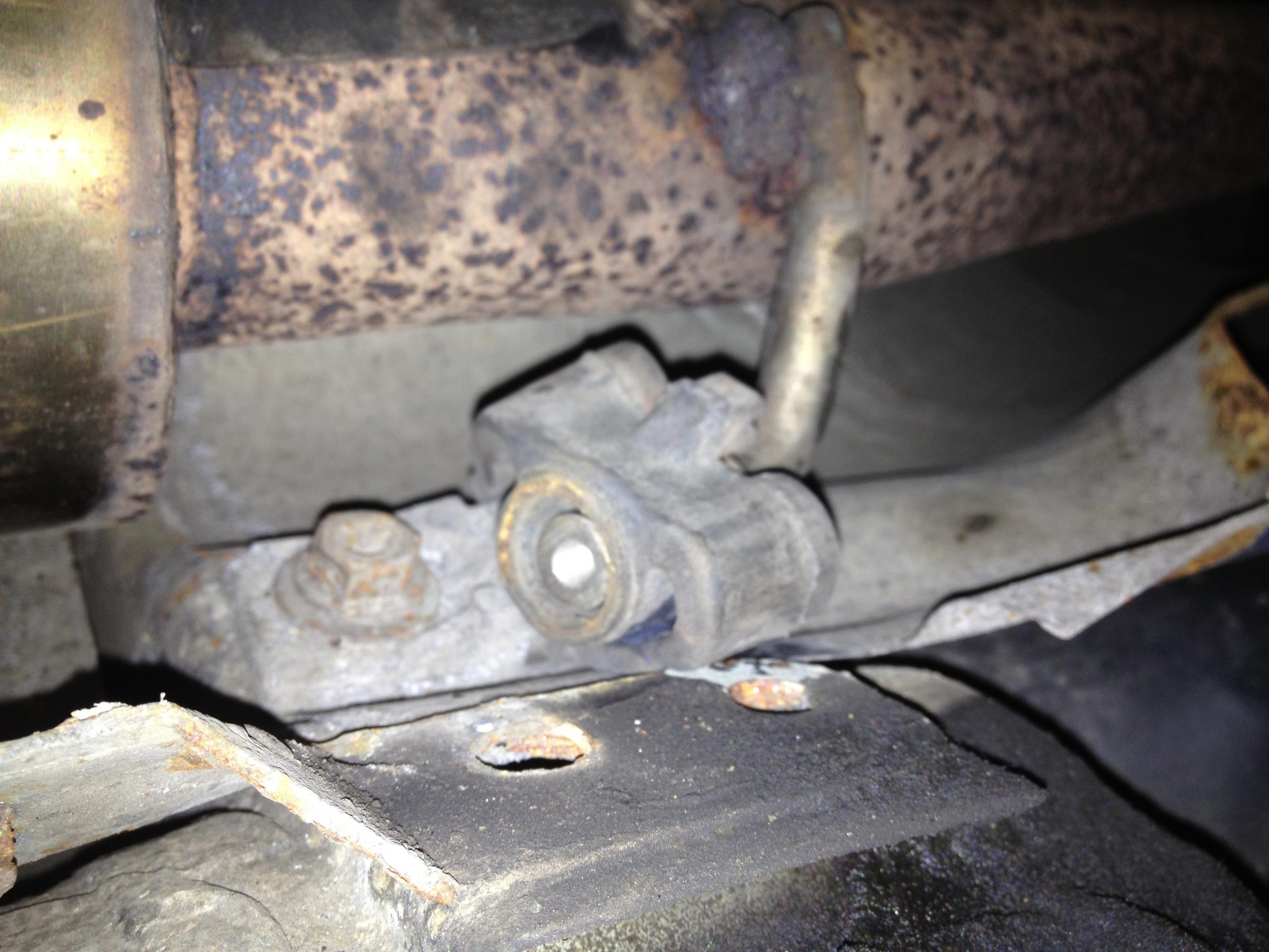

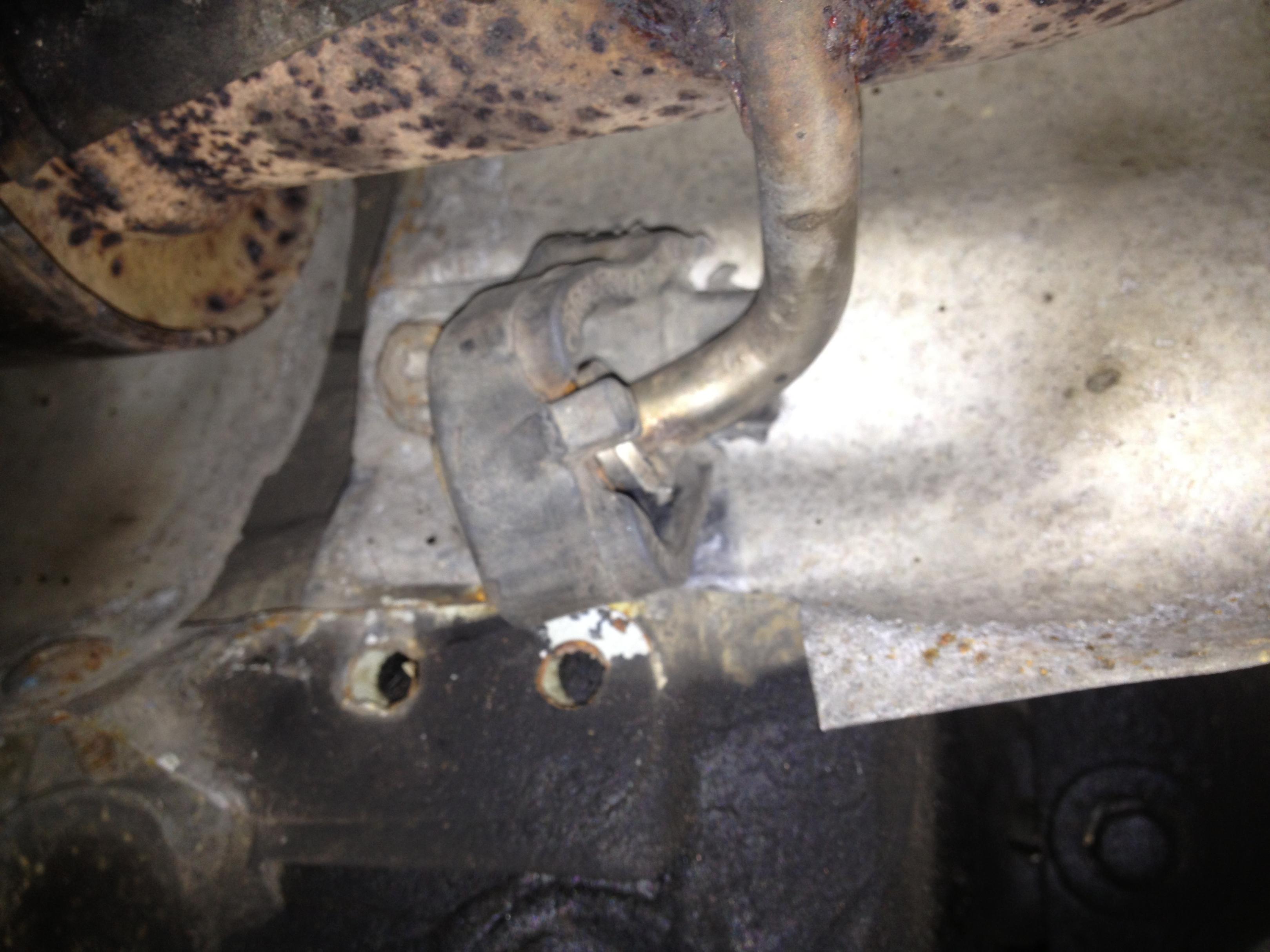

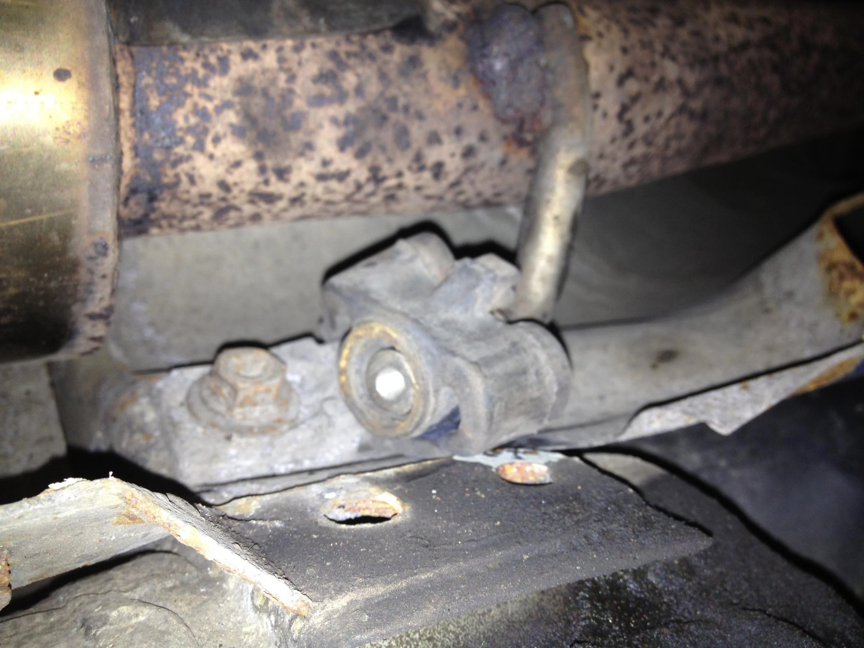

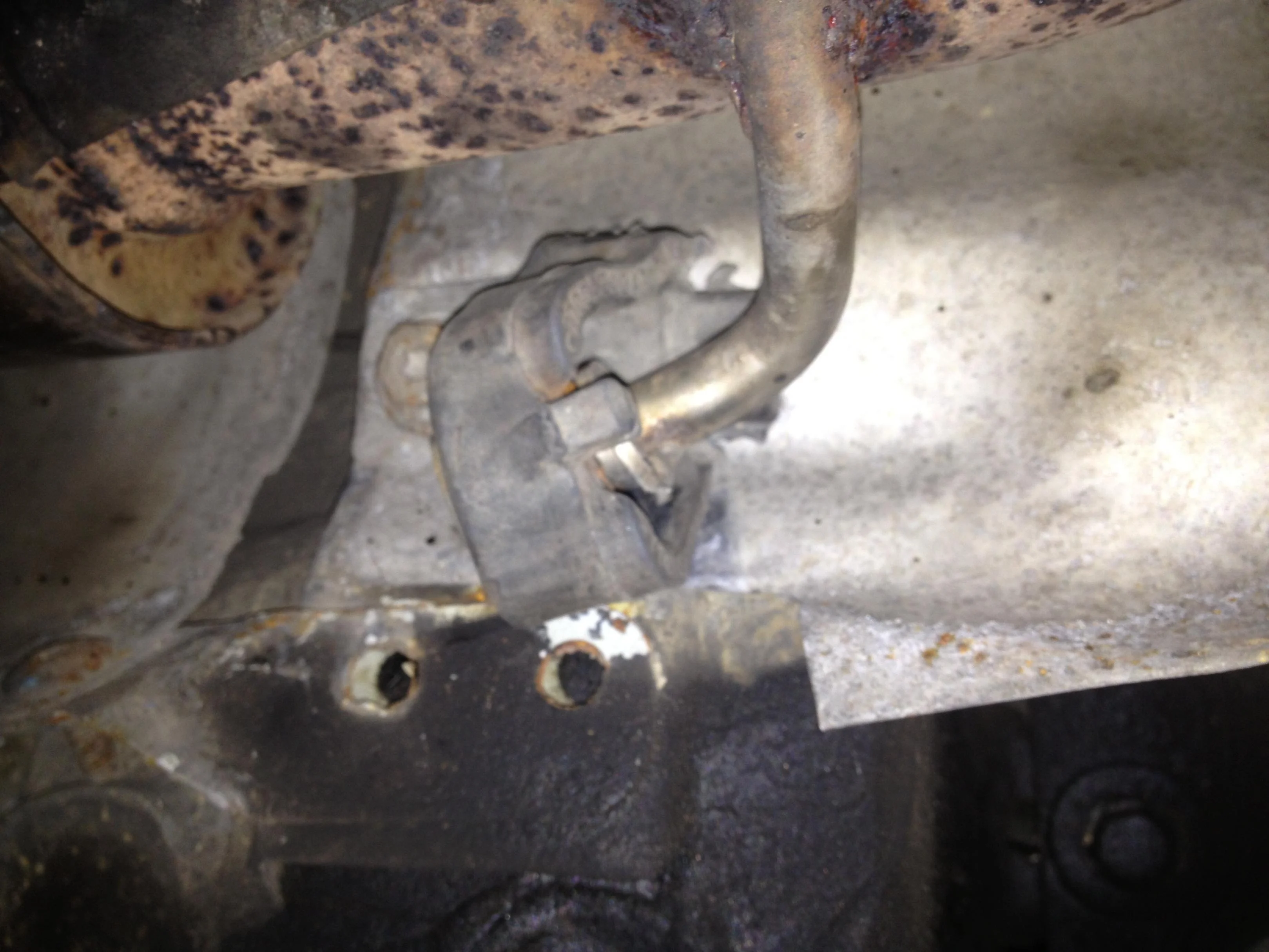

Had another look over this morning and im pretty sure its the manifold/downpipe hitting the subframe as its really close to it and not the rest of the exhaust as to much clearance.but my centre mount is pretty fecked but not sure if that as the exhaust does not hang and its pretty tight on no movement also,i'll post a pic up

  monaco 172
New gearbox mount from gsf, pull engine forward and tighten up new mount.
Sorted!!
​15 quid wel spent
