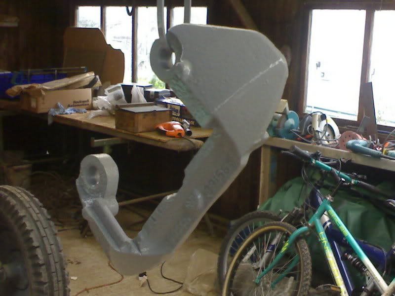

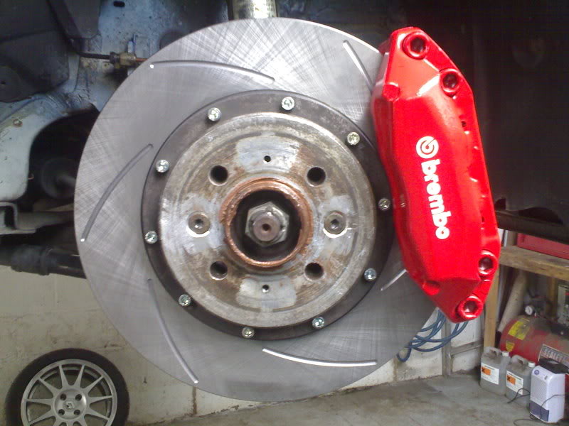

Crappy picure as i must have had the shakes and it was on the phone! but you get the idea, need to get some bloody spacers made though so the calipers sit right!! never mind, hopefully be on this week properly, so the cups out of action for a while!

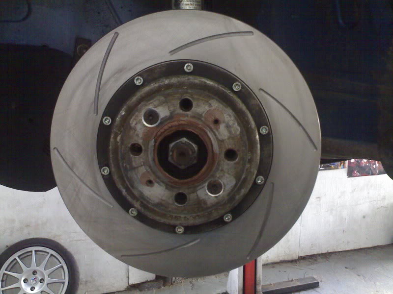

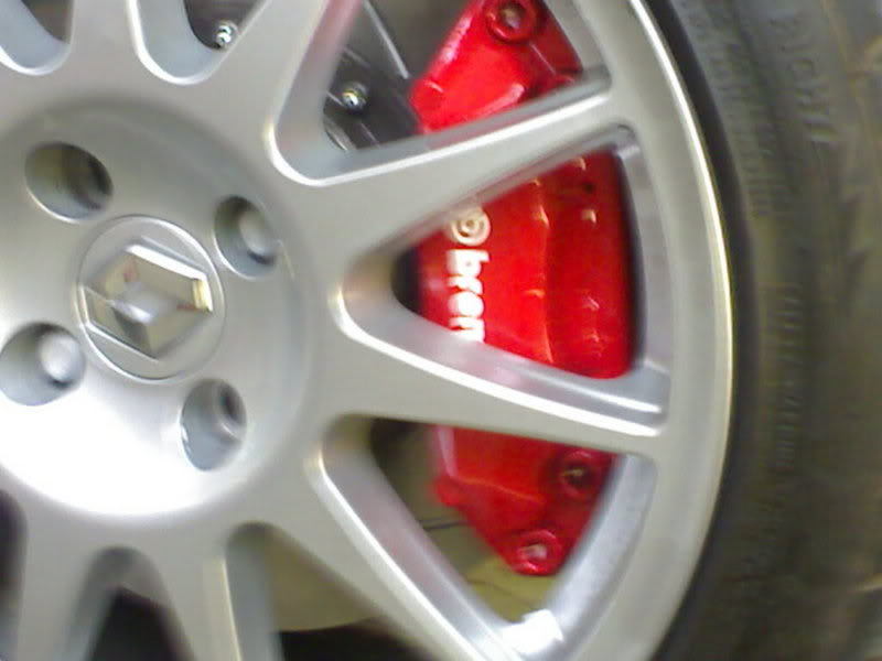

When i couldnt do anymore decided to strip the rears and get them matching! in primer ready for the top coat!

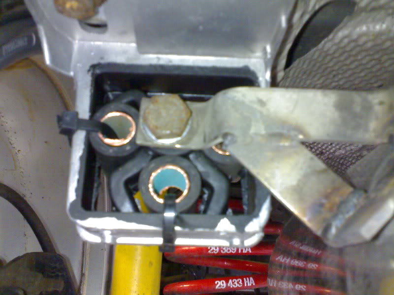

And another recent mod, made myself a heavy duty exhaust mount!, got a non gen rear mount for a tenner, some 1/2" hose from the parts supplier, and some copper pipe pinched out of fathers magical shed of useful bits! the prospeed doesnt move around anymore! bargain, also replaced the centre mount!
