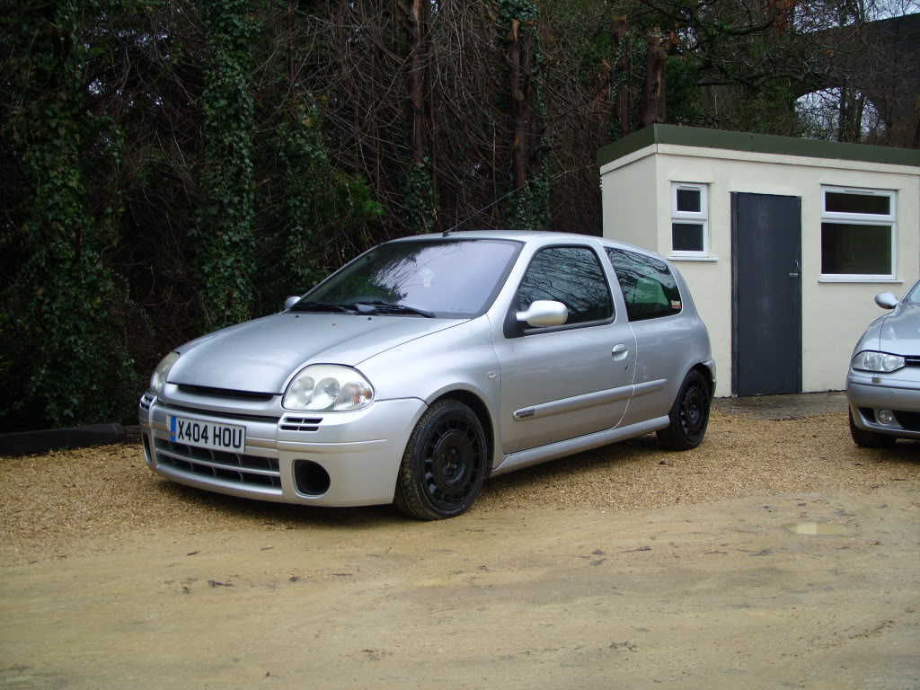

CBA! Looks like I'm gonna have to flog em and put the cash towards some 2nd hand coilies that come up! Gutted. They were the anthracite OZ F1s too (as standard) with the lettering on the rim. BUM.
Bluebeard
  Whichever has fuel
They'll look good on your car too....
Danith
  GTi 7.5 pp/Mx5 nd2
You really know how to cut to the core of me Daniel, so wise..........unfortunately I need a replacement set of wheels and my cheeky swap thread has been deleted!
Danith
  GTi 7.5 pp/Mx5 nd2
Already had a ph1 with dark turbines, wasn't into them at all soz. If I had a mk1 16v or a R5 GT then I'd be up for it!
That debadged bonnet has caught my eye tho!

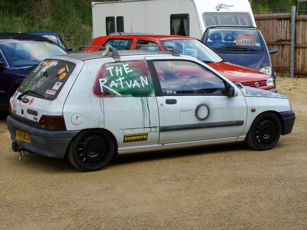

What van? I'll have a think mate, you're first in line if I do!
Bluebeard
  Whichever has fuel
Beautiful.
This van.... (Its been lowered another inch and ''the ratvan'' has been removed since this pic)
