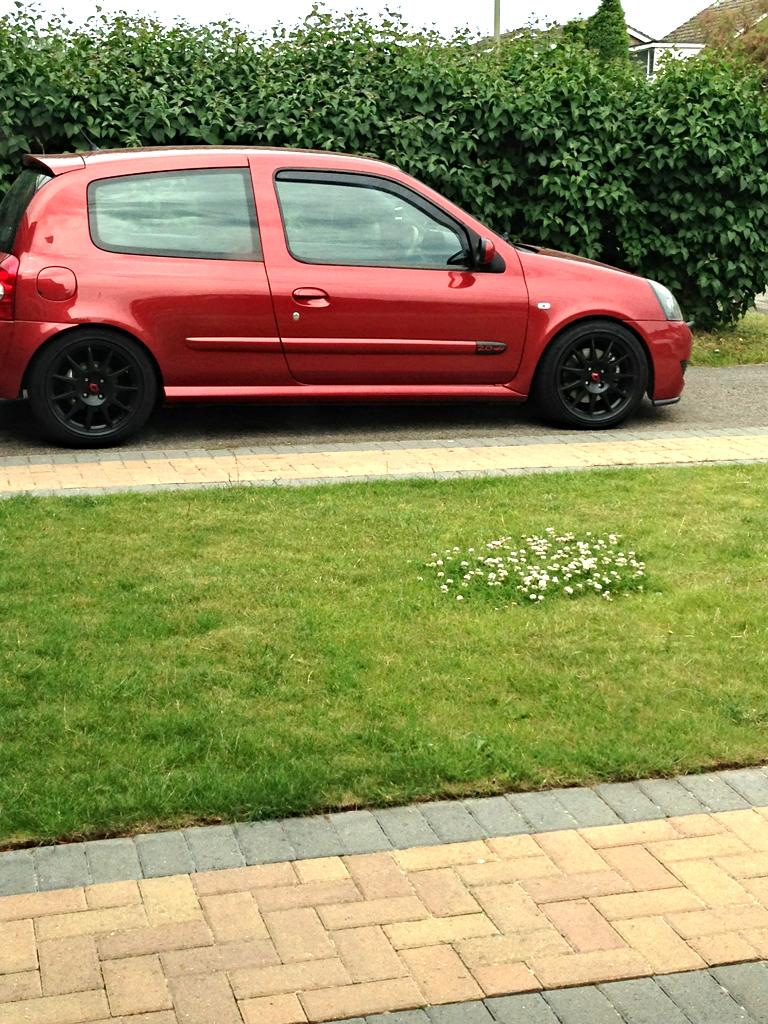

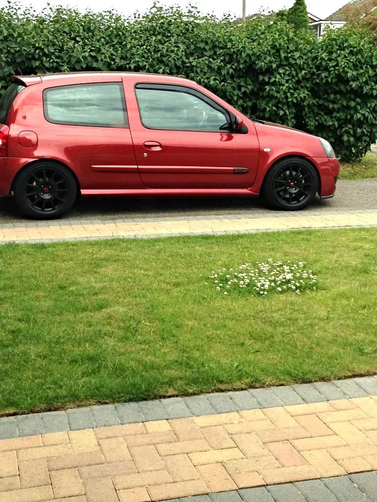

  PH2 Flamer
That's mine with 25mm spacers up front and cooksports
All though, not a cup.
20mm was too much on the rear, so rears will need to be 15mm.
  PH2 Flamer
Cheers mate :)
I was just about to say, must be the cup shocks.
But maybe they are goosed. Mine are brand new shocks all round. Done the same time as cooksports.
I'd recommend getting the 15mm hub spacers for the rear. As the wheel spacer type will need either studs, or you cutting down the wheel bolt length.
Fronts, go 25mm, if its too much send them back in exchange for 20mm. Or buy both, send one set back.
