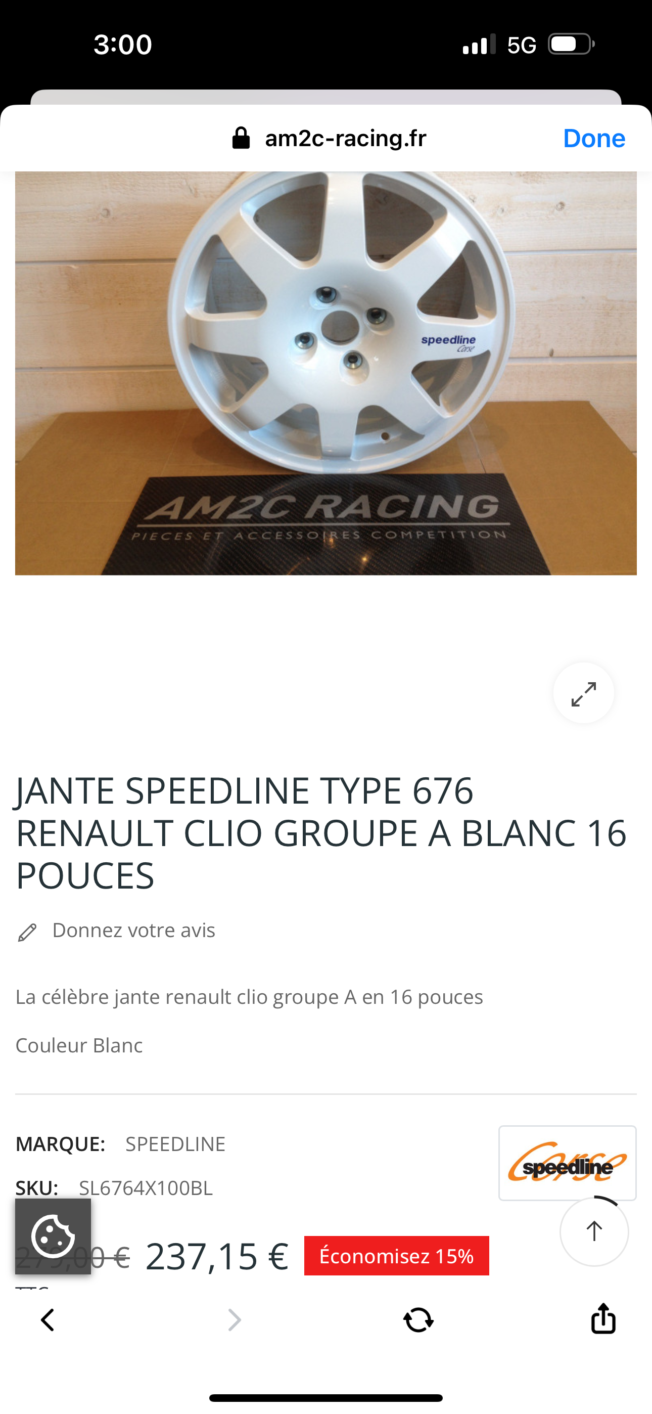

Hi,
Will the speedline group A 7.25 x 16” rally wheel fit a clio Williams without any modifications? (Photo)
What’s the arch clearance like?
Has anyone fitted them and has photos?
Thanks

Depends on how the car is setup suspension wise, on a standard ride height etc yeah they'll fit easily
If it's lowered with extra camber or anything funky, tyre size will be a factor in whether they clear or not
Got to say I'm quite surprised at the specs of the genuine Speedline ones, I'm used to the Prima Racing replicas which are 7j & ET38 (could be 36 or even 37 I can't actually remember off the top of my head) plus they also did them in 17 inch that fit ok if the tyres are low enough profile and the arch liners removed

Yes, the specs on the speedline wheels being 7.25 and 53 eta do seem a bit odd, hence why I asked the question?
Is there much difference between the prima wheel and the speedline wheel as the prima wheel costs have the amount?
