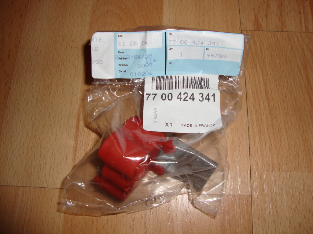

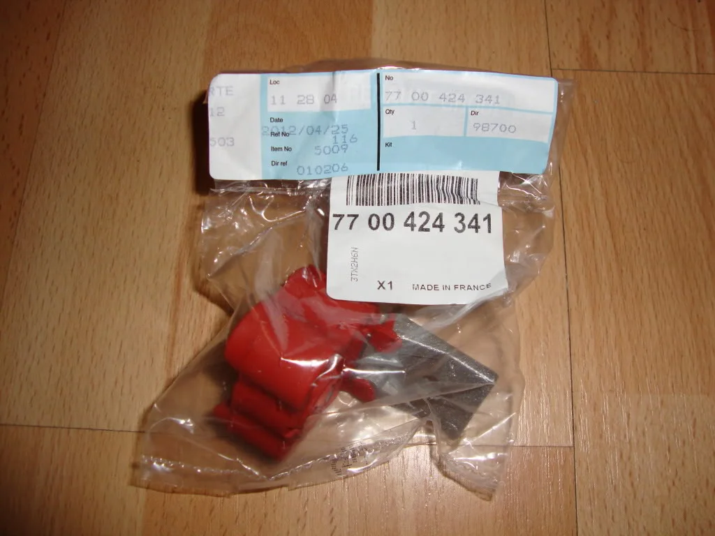

This is the centre hanger, PN: 7700424341

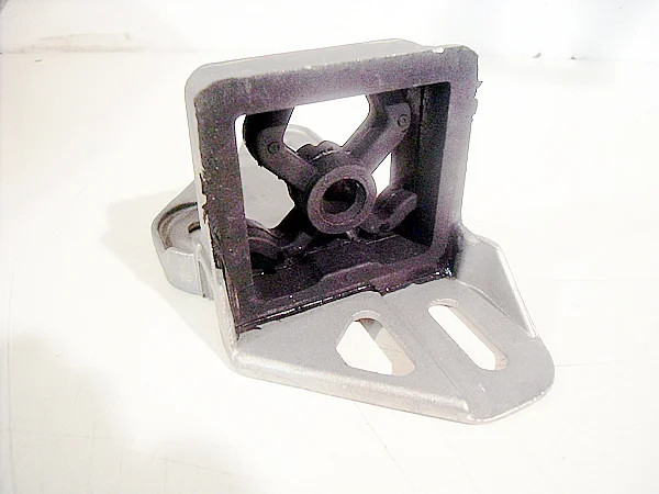

These are the one that go in front of the back boxes, PN: 7700434978
These are the rear hangers, PN: 7700424339

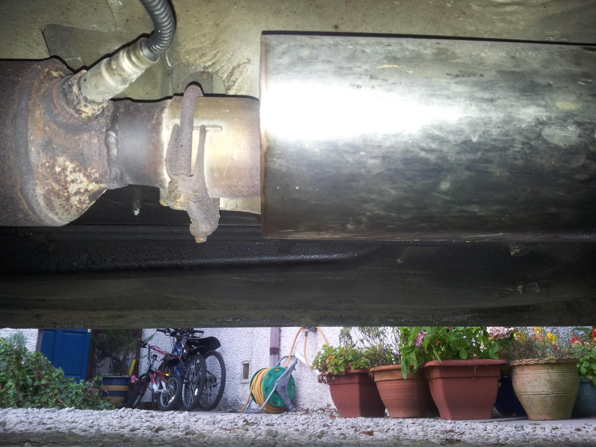

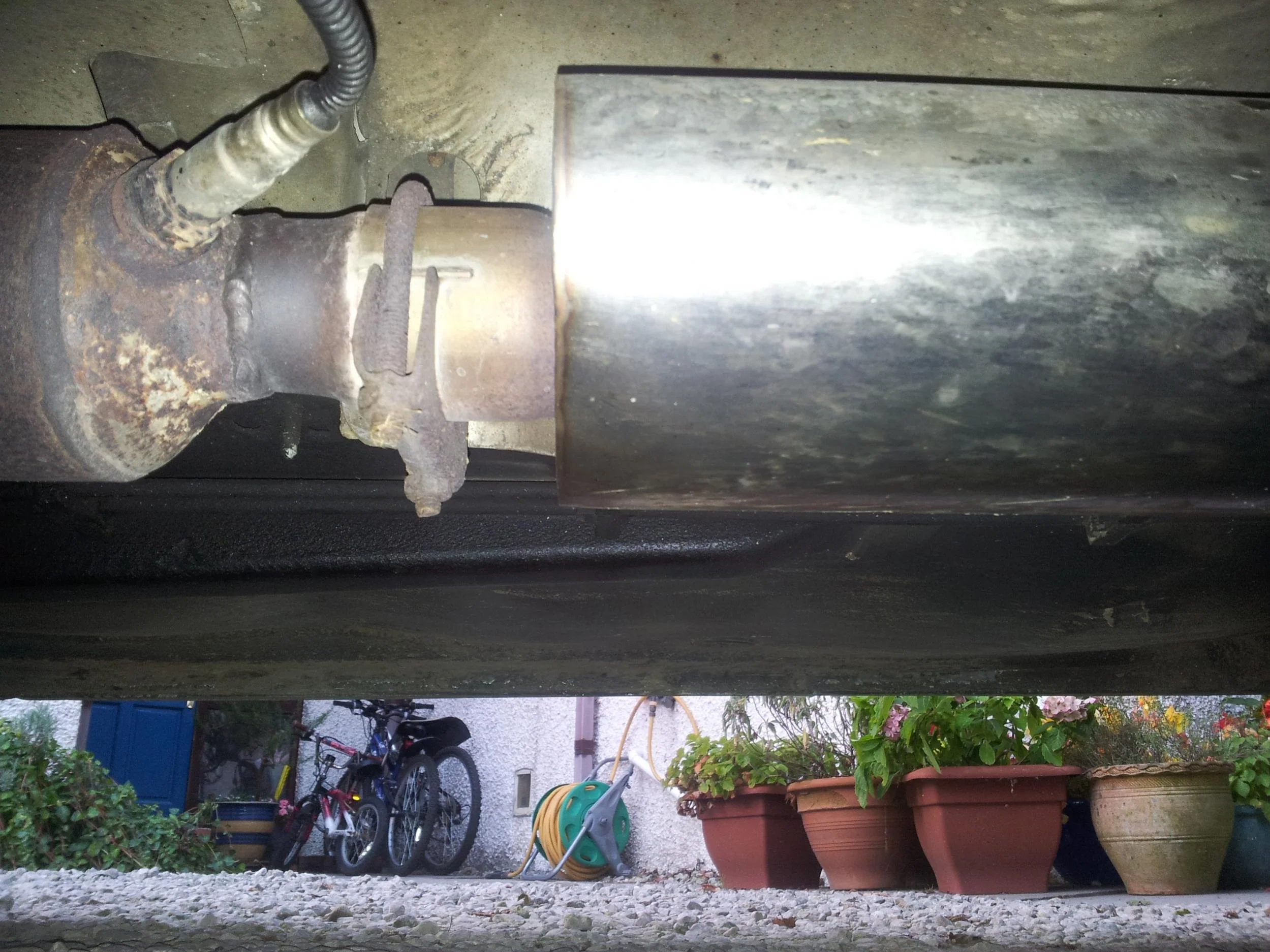

Apologies for bumping this again, just been looking under the car and seen that the aftermarket exhaust is connected to the cat like this;
Is this sleeved or is the standard flange still likely to be under there for an oem section to be fitted too?
Thanks for the help!
It does kind of look like flared bit on the cat has been cut off so the Center silencer can be slid on, not sure what the chances are that the silencer was wedged onto the cat and wasn't cut, only one way to find out ?
  CursedTitanium 182FF
Yes it has had the CAT mod done, where the olive join is removed. Which is better as the olive join can be a pita.
