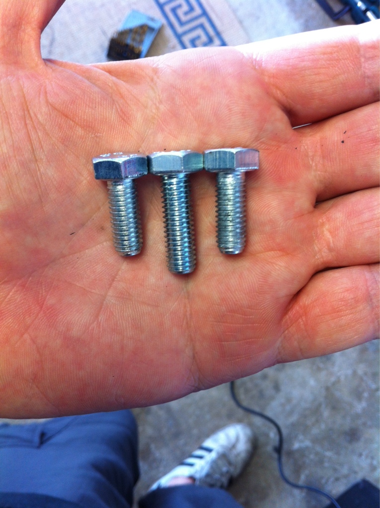

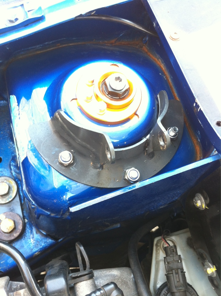

I have drilled the holes bigger and an extra 3rd hole between the original 2 on the mounting plates using M8 8.8HT bolts, this will guarantee no/less movement than the supplied screws.
thanks a lot this sounds a good improvement! I will get some bolts ordered and get it in place cheers :)

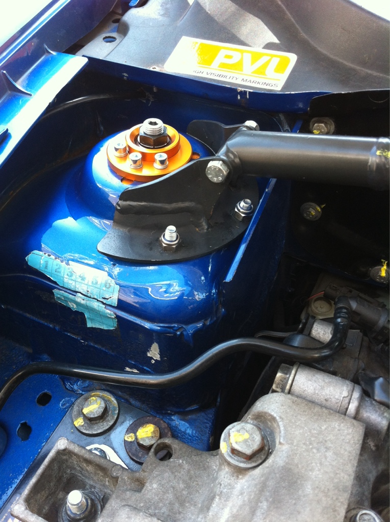

Middle bolt needs to be longer as the strut body slops downwards and away from the mounting plate of the strut.
Make sure you put some sealant on the arch side of bolts and have nuts facing upwards, bit tricky, would advise someone else holding the bolt with a spanner while you use both hands to tighten up the bolts, one hand will make the socket most likely slip and ruin the nut head.
Again its not the greatest strut brace in the world but choice is very limited and your making best with what you have at hand

I mentioned, about putting washers on the underside of the bolts that go in the wheel arch, this will stop the bolt heads pulling through or tearing the sheet metal and allow you to tighten up the bolts.
I haven't done it yet, but i'm going to add a further bolt on each side by the outer 2, so they work in pairs this will add sheering strength. Remember on these types of suspension when cornering the outside wheel is pulling the outer strut tower outwards, so in effect the strut brace is under tension and the strut towered gets pulled apart rather than pushed (during corning) so the bolts are under stress. A strut brace is only as strong as its weakest part, normally the self tappets screws, the mounting bolts( in our case) or seam welds.
The tension set on the omp brace wants to be natural, obviously taking up some of the slack.
If this cures lets say 50% of the movement, then that is better than nothing.
