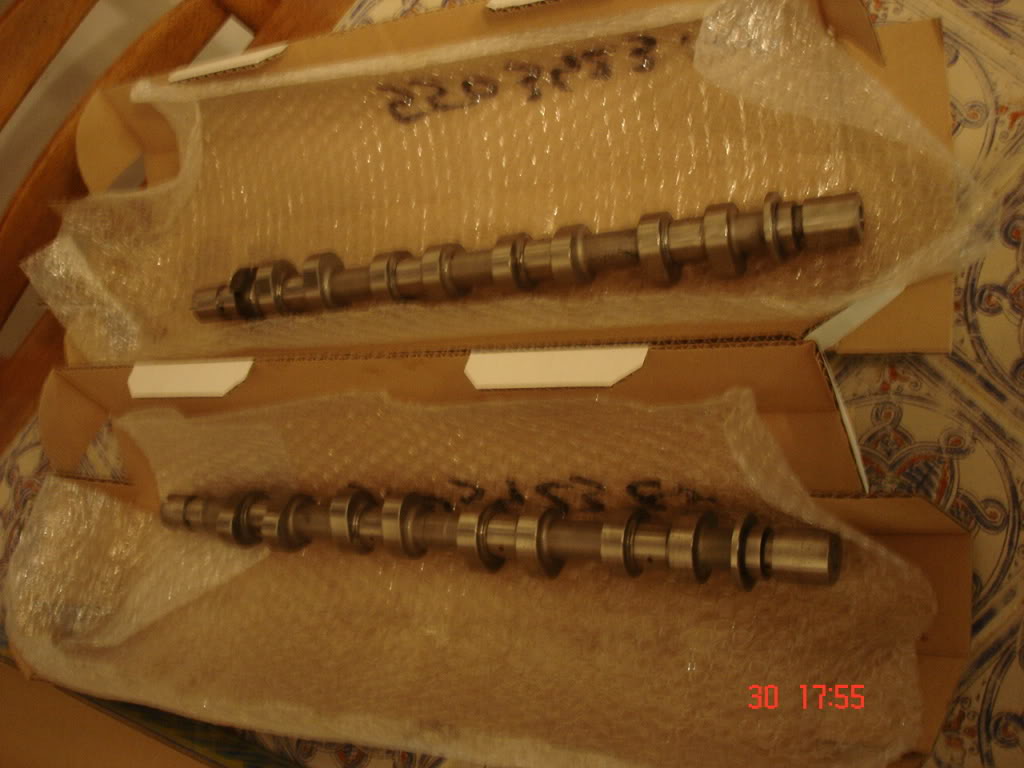

In the Renault manuals I have showing the F4R engine the exhaust cam have a stud on one end. I just bought C&B cams that dont have this stud, have also seen other cams like CatCams that lack this item.
Like on this picture I borrowed from another forum user ;)
What is the story behind this and what do I need to do to mount my C&B cams?
Cheers
Buy the stud from renault, they are supposed to be replaced if the pulley is removed anyway apparently. Considering they have never had a pulley on I guess they leave it out to make sure you put a new one in.
