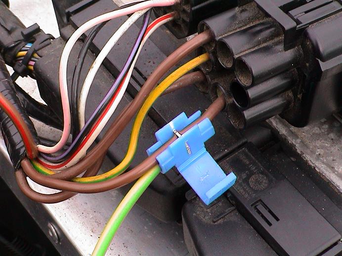

I've got some bullet connectors, how would I split the wires because I couldnt jst connect them as there wouldnt be a feed from the powe supply then?
You can probably tell I dont do these sort of jobs.
Djw John
Scotland - South
Looks like that. Get them in maplins, halfords etc

So would you just use the 1 connector and crimp the 3 wires together, 1 from each of the sunvisers and the other 1 from the interior light?
Djw John
Scotland - South
Sorry hadnt noticed a reply.
Personally I would connect both sunvisors lights together and then that wire into the pernament feed. So 2 into 1 and then into the single live.
Djw John
Scotland - South
Get 1 wire from 1 sunvisor and out it into the scotchlock and then put a longer one from the other visor all the way through the scotchlock. Then put that into the 2nd scotchlock and connect that to the interior light wire. Kinda hard to explain without pics. If you are still unsure take it to a ics install place and get them to do it.

So i need 2 scotchlocks or could i just put the interior light wire through the scotchlock and then put one wire from each of the the sunvisers and put them either side of the other terminial in the scotchlock?

Thats a good diagram mate, cheers I fully understad that. So what do think about what the breakers yard said about there already being block connectors there for sunvisor lights, is this true or rubbish?
