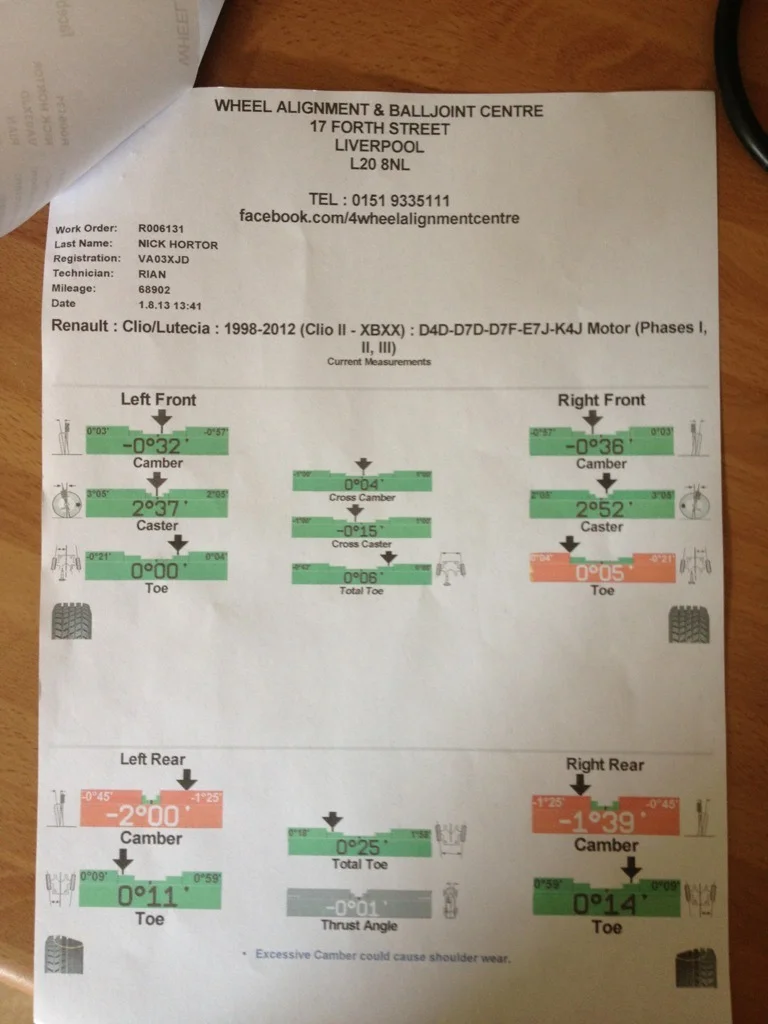

clio 172 phase 2

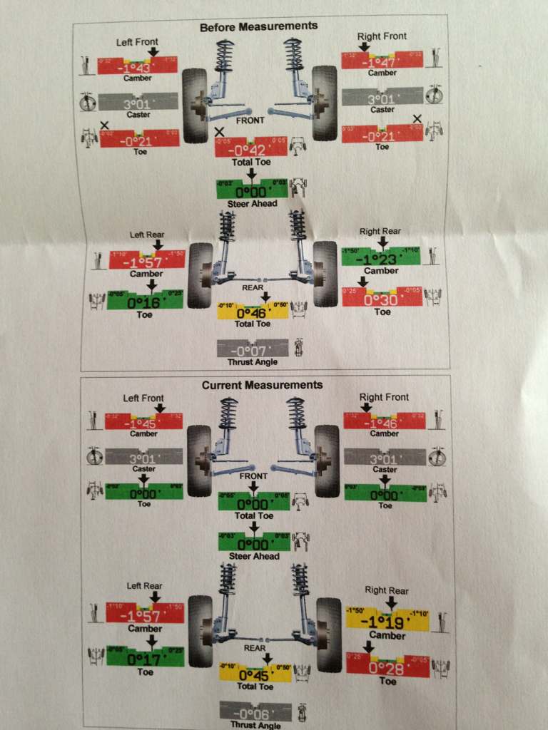

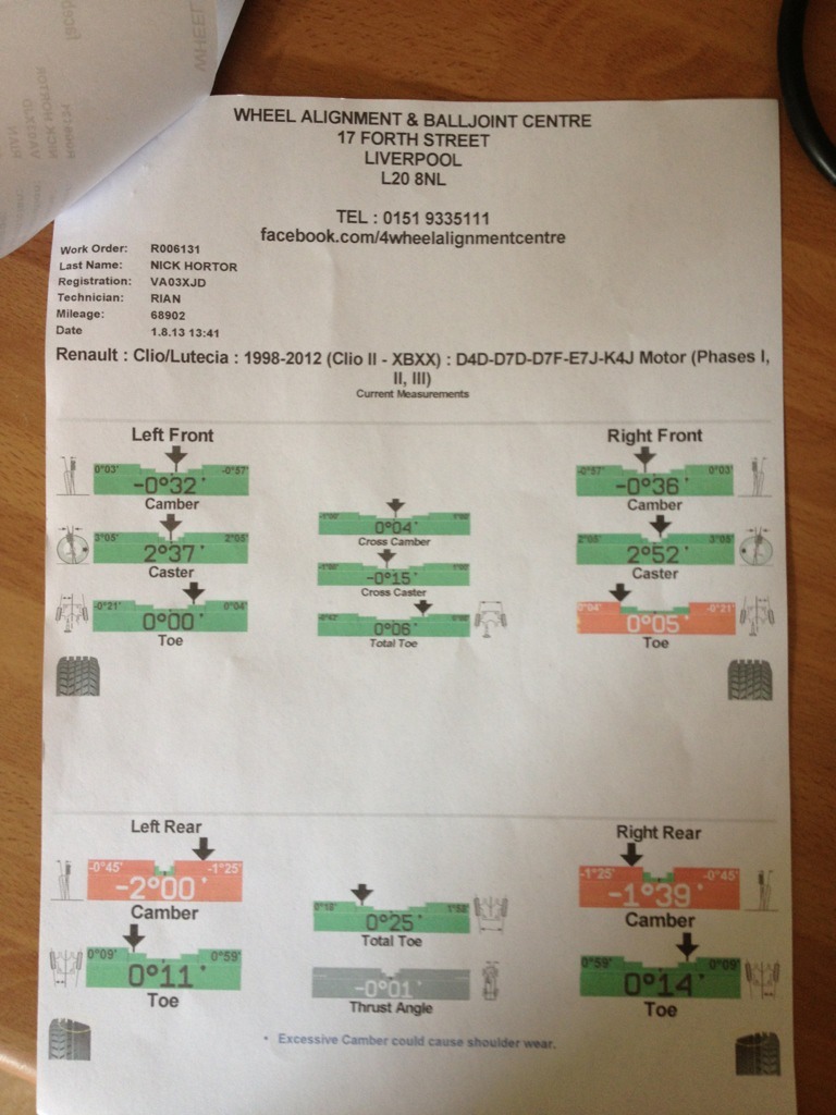

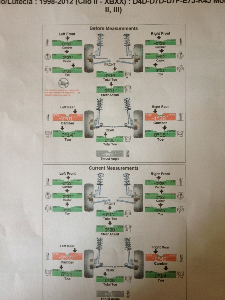

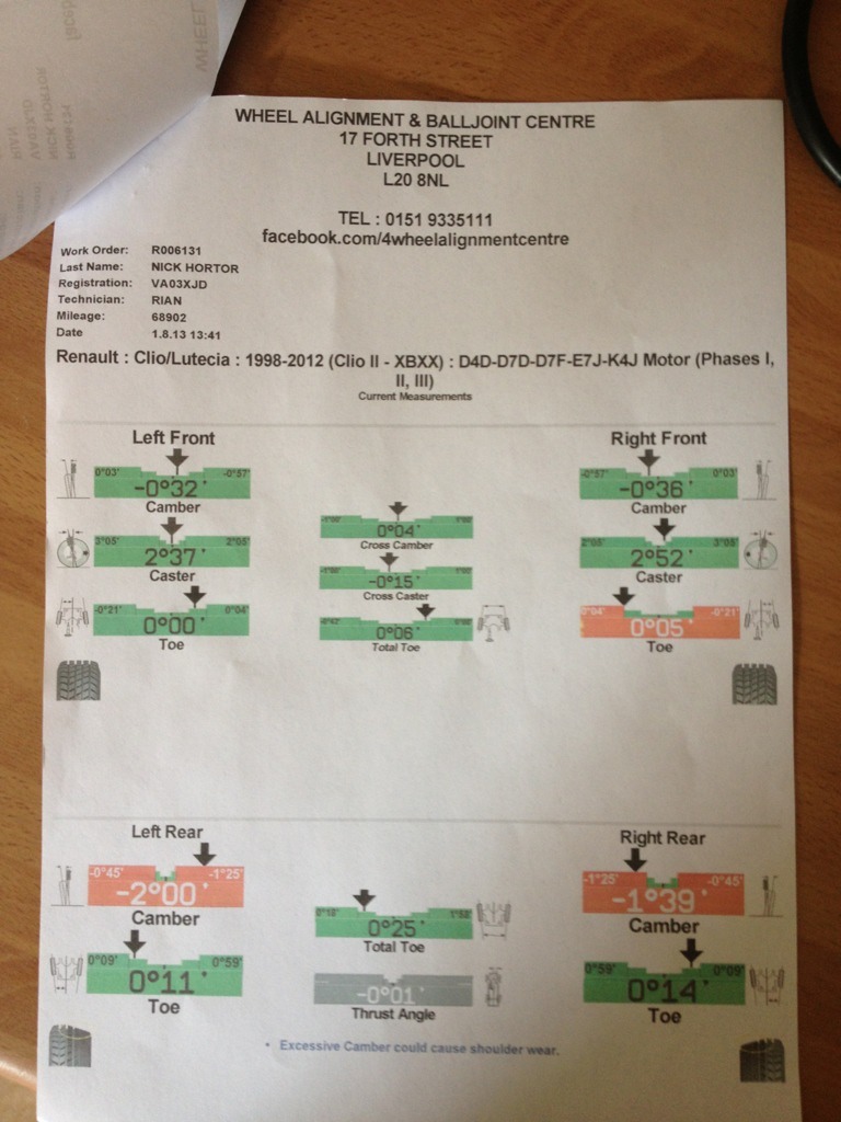

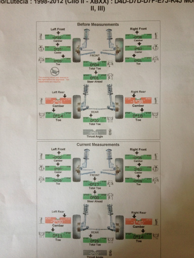

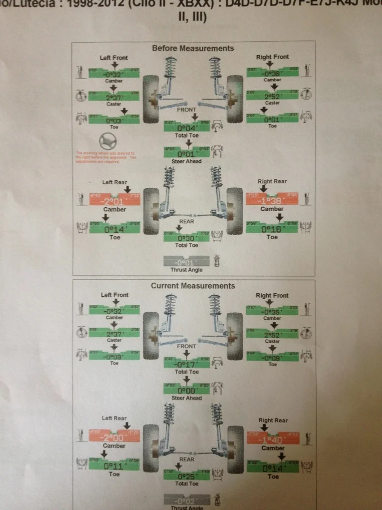

After getting fed up of a slight pull to the left went the Clio checked on Hunter alignment machine. They very slightly adjusted toe but the only thing they could put slight pull down to was cross caster? Or possibly tyres. What are your thoughts. It is slightly better since toe adjustment but still there
