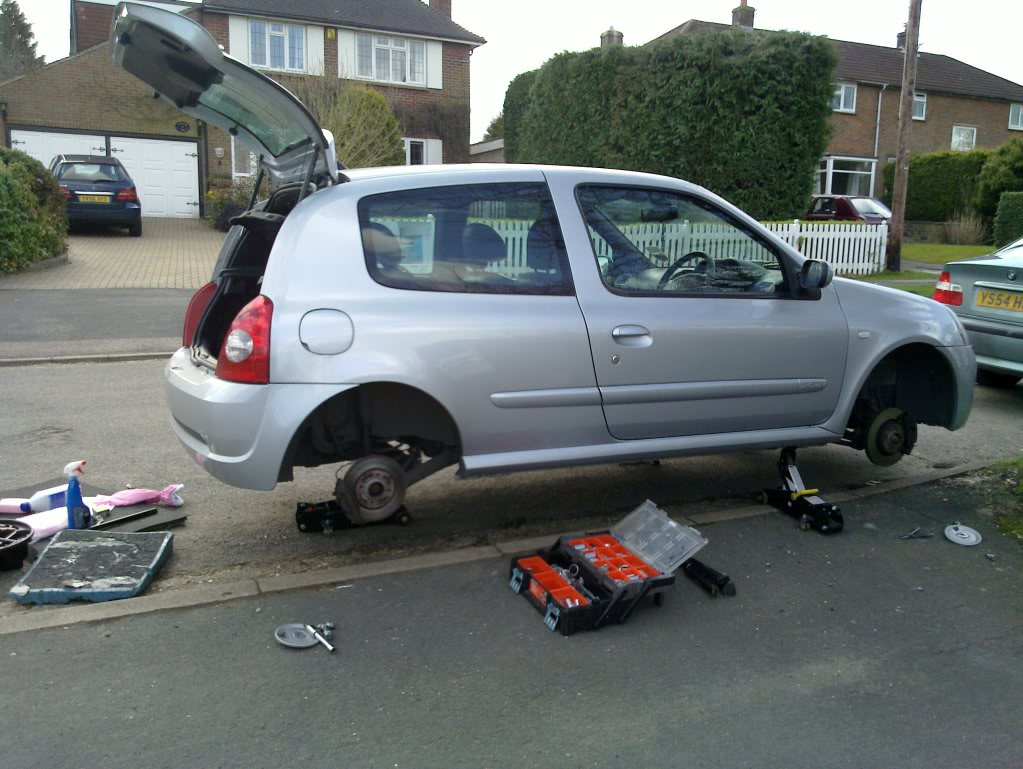

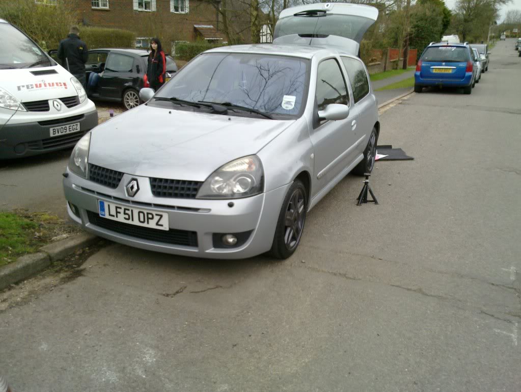

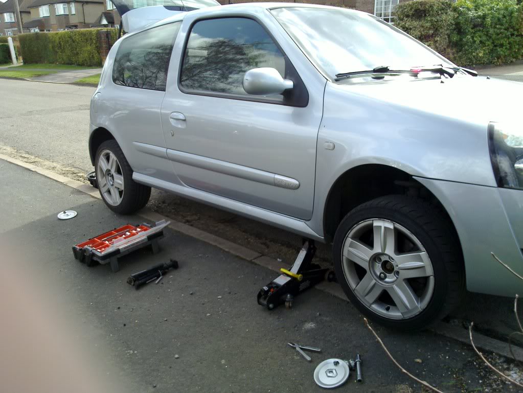

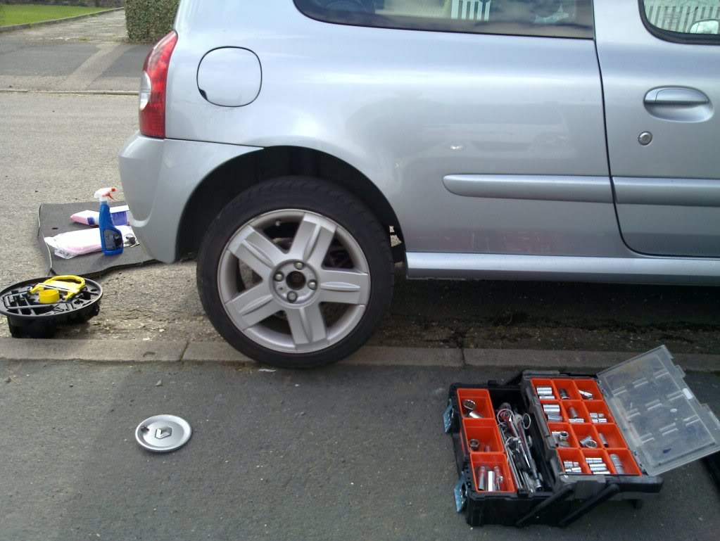

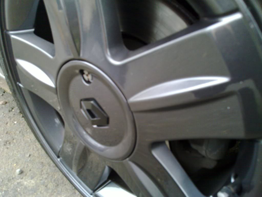

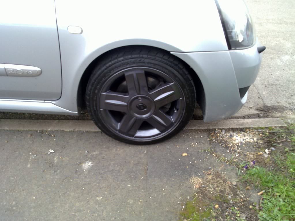

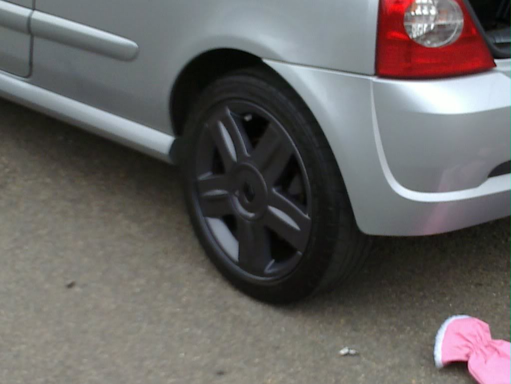

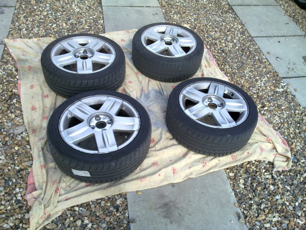

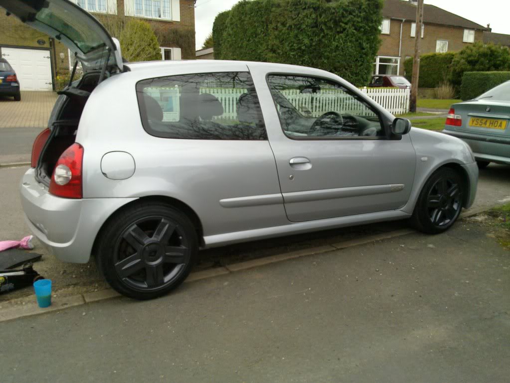

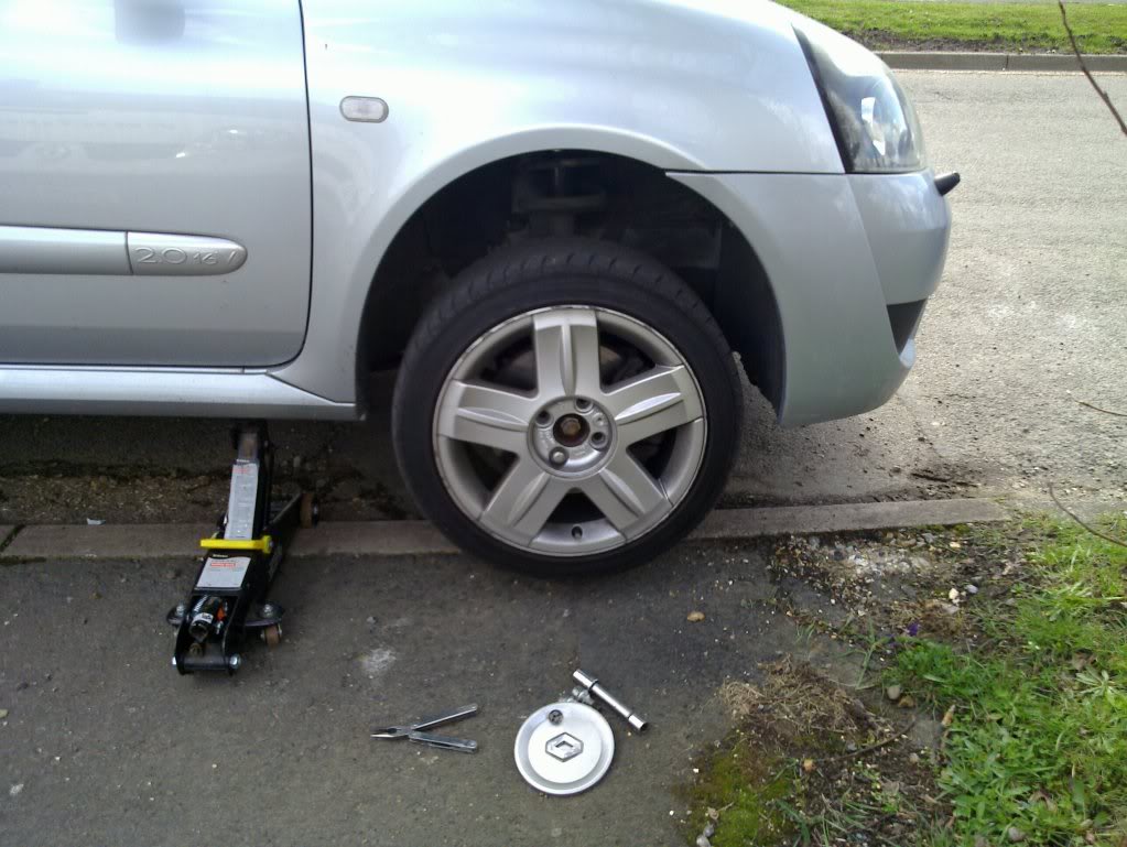

i got bored today so i decided to refurb and colour change the colour of the 172's wheels.
being a silver car, it limits the colours that i could do and it would still look good so i went and mixed up my own colour which is more like graphite than anthracite and has a pearl green fleck mixed in (which you can only see in the sun)
i didnt want to do black or anthracite as they have been done to death so this seemed to work well.
any way just some pics to show the process and results.
opinions welcomed!!
thanks

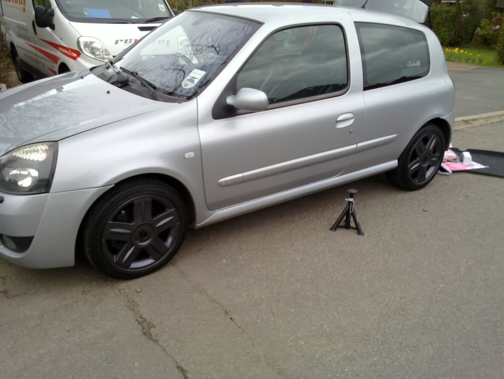

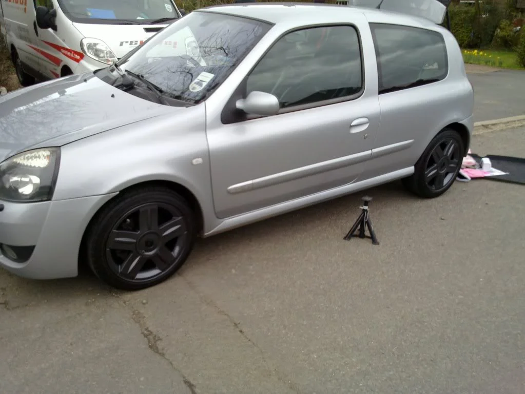

results-
PS. I KNOW IT NEEDS LOWERING!! LOL

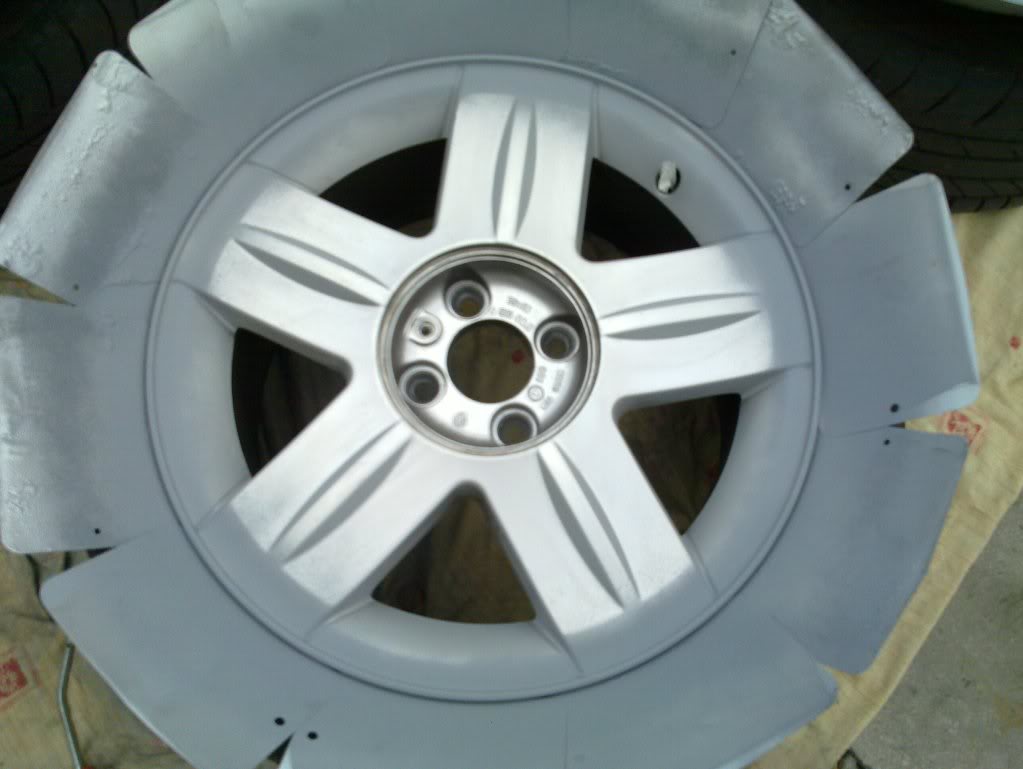

I can't imagine them being good quality tbh. All done in 2.5 hours? Christ, to rub them down properly, sand, wet sand takes an hour per wheel anyway. Saying this, how do they look up close? And how many coats of lacquer have you put on?

lol if it took any longer, i wouldnt be making much money. lol.
if i am doing a full set off wheels its a lot easier than doing 2 at a time! i put 3 coats of lacquer on ( 1 dust coat and 2 wet coats to bring the shine and depth up) they look great up close, you can see it in one of the pictures.
rubbing them down when you have a D/A is a lot easier than doing it by hand lol

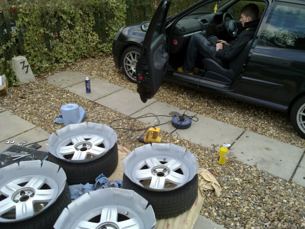

Wow, Looks great for the time it took, What are those cards around the wheels? Specialist things or.. looks to me like curry cardboard lids?

Silver looks hot assuming shes in the background, wheels look good also :0

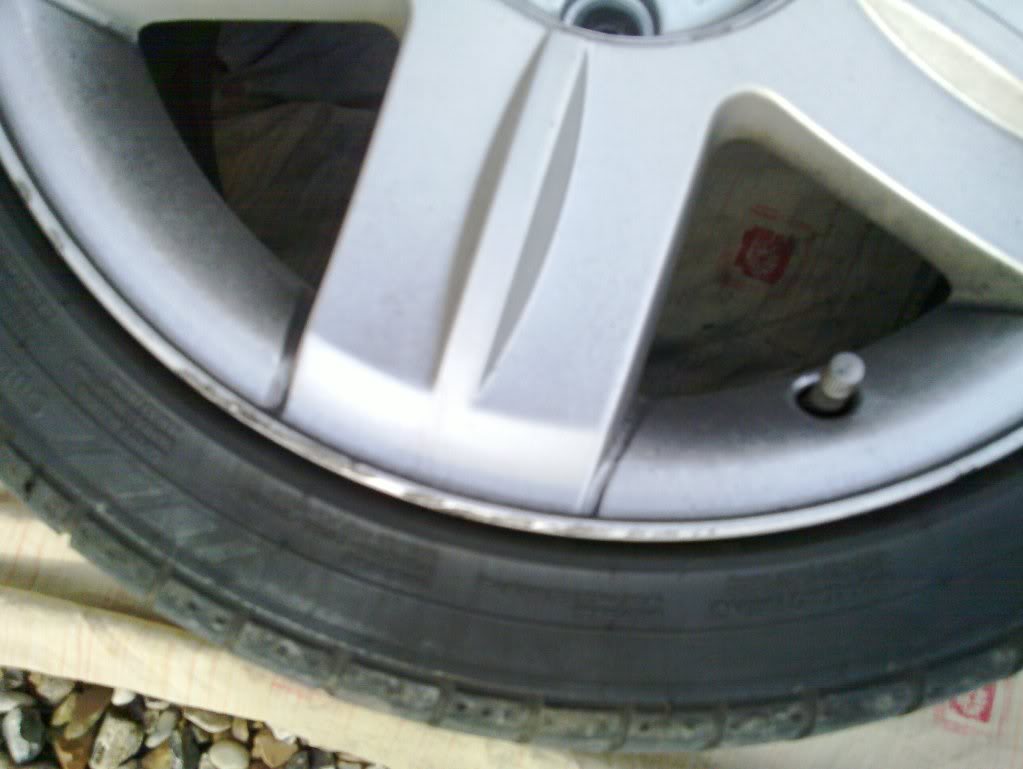

they are called spray out cards, just save taking the tyre off or masking it up.

Link to the spray out cards if possible ?

i cant give you the link to where i get them from as its for trade customers only but i think they are about £10-£15 for enough to do 4 wheels (you can use them over and over again)
