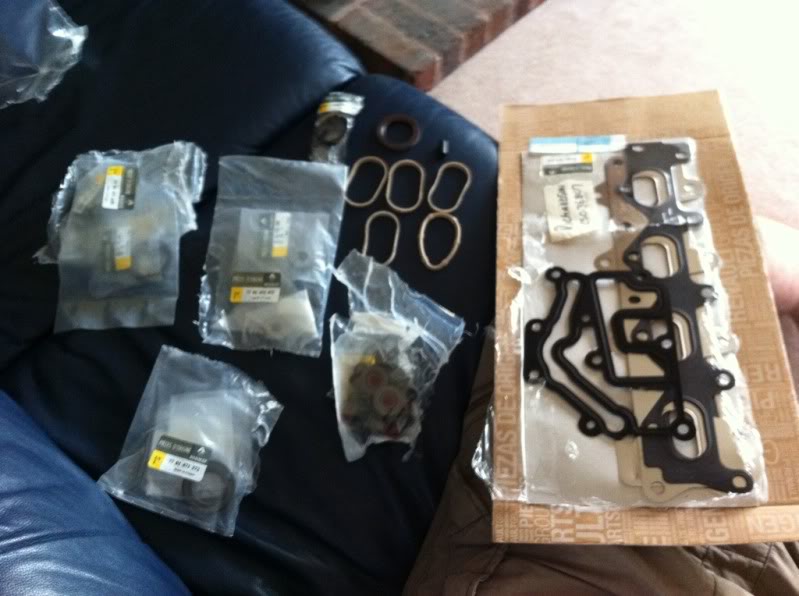

I've already got a gasket set from Reno, are the crank seals in there then?

Ah, didn't realise that, cheers. Must admit I've never opened it - I'll go take a look.

you appear to have a top end set, and not an engine set. you should still be able to buy a bottom end gasket set for cheaper than buying separates

I've got a sump gasket downstairs in a separate package, so assume I'm only missing the crank seals then. I'll get some tomorrow. Didn't realise you could order an entire engine set - wish the parts department had volunteered that info! Can you think of anything else I should order?
Thanks for the help mate.
