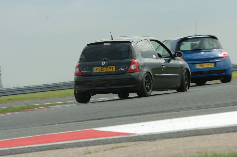

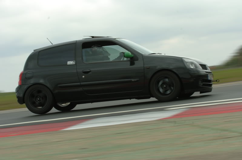

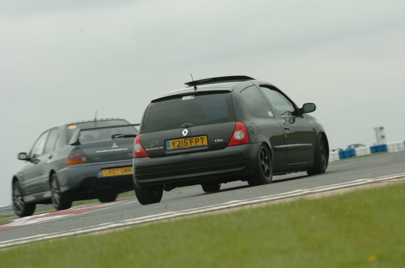

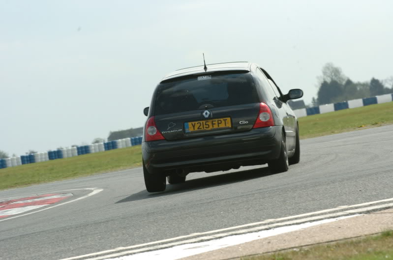

After seeing some pic's of my car at Marham last weekend im kind of thinking i may need stiffer springs. Has anyone changed there coilover springs on CS? Ie for stiffer ones and for what reason.
It may just be me, but is this amount of leaning ok? Or is it a bad thing. This is going to be for track use only by the way. Not much road.
Just wondering what people's thoughts are regarding suspension set up.

Mine was pitching this much at Marham. As long as your not rubbing then you'll be fine.

Firmer springs/damper settings. Passenger won't help either. Bushes are uprated front arb if they make them

It's the springs and ARBs rather than the dampers that dicate the amount of roll (see below); the dampers just control the rate of roll.
Lowering the car too much can also increase the amount of roll, so it's best to work within the parameters that Renault designed the chassis for. Remember, roll is a good thing as you allow the dampers to control the transfer of weight and keep a stable tyre contact patch.

It felt good in the corners, rubbed a little under extreme loading though. Would raising it slightly be a good idea then?

She's set like this at the mo, had a slight bit of rubbing up front on the track day where she was catching the plastic arch liners, thinking of raising her 5-10mm.

Yes all of us in the Swedish Clio Crew have the same problem, toasting the outsides of the tires on track. This is despite running cambers of -2,5 to -3,0 After making some movie analysis we have come to the conclution that roll is making the car "tilt over" actually making camber almost possitive under hard cornering = bad = to much stress on the outsides of the tires. Rock hard rear seems to be the solution.

Very strange comment I must say. Too much of anything will spoil the cake... what we have seen on the pictures is excessive roll and that is not a good thing. At the same time you cannot make the car too hard then you will definitely loose time. First of all roll should mainly be cured by ARB not by rock hard springs. You need to find a balance.
If you want to build a Clio that handles like a cup race car just look at a Clio Cup race car. Not much roll to be seen here.
